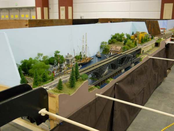

You'll see some of the true insanity of all this, once I start the scratch build of my "Tern". I will try to document all the various aspects of this "three mast schooner's" progress, from the laying down of her lines to the erection of her frames, the planking of the hull, deck, cabins, hatches, and her masting and rigging. Her length overall, from the tip of the bowsprit, to the end of the main boom, will be close to 154 HO scale feet. Very close in size to the Brigantine, W.W. Marsland, and will timeshare a section of sea wall, where the Marsland, and my "Tour Ship", also moor when she is in port.
In this photo, that "section of seawall" can be seen in the center, occupied by the "Marsland" :
