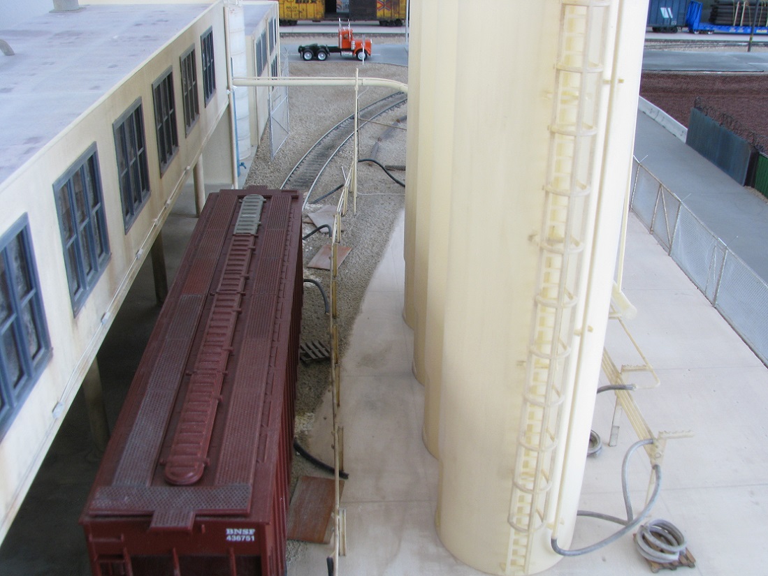

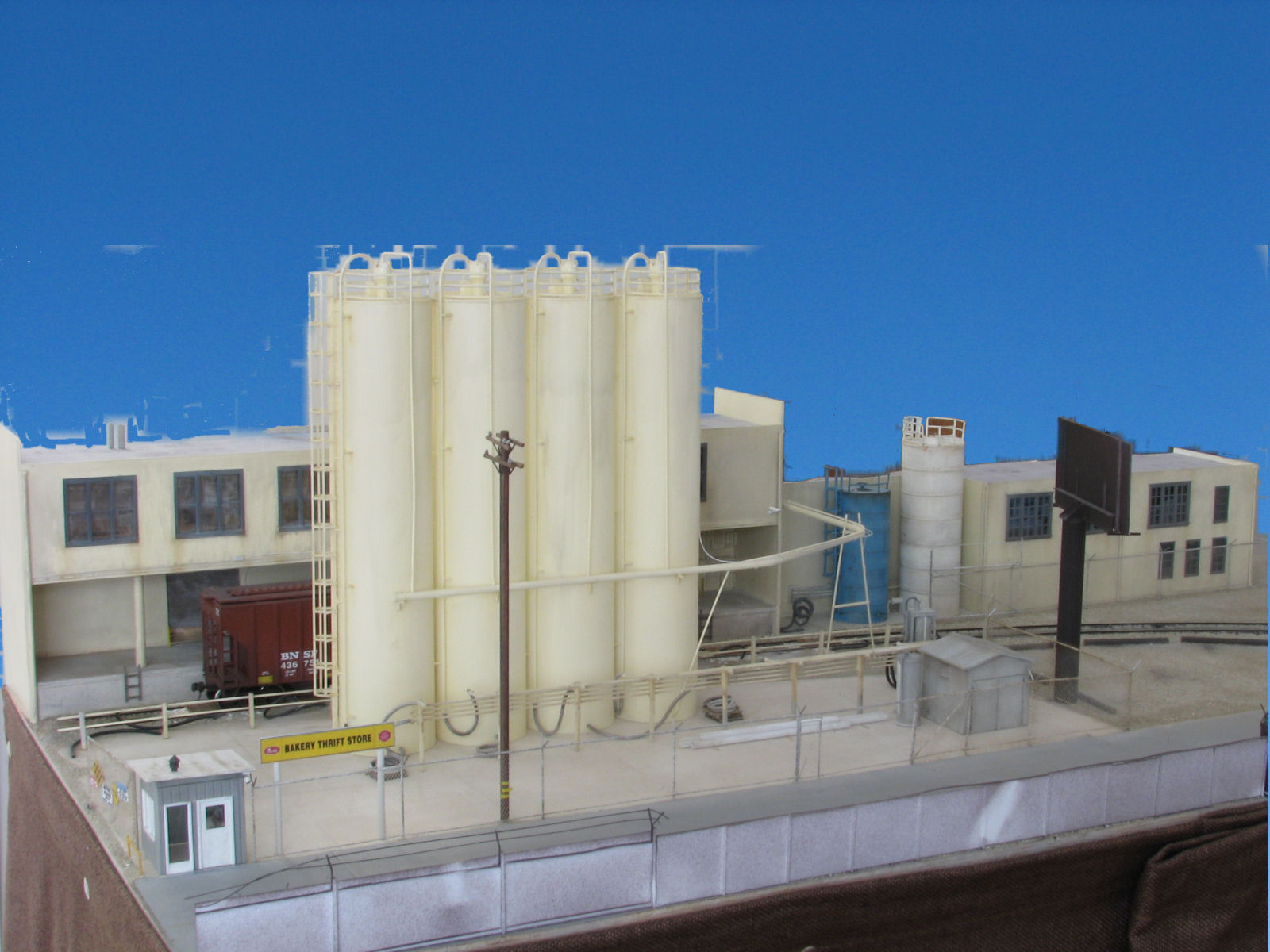

Andy, absolutely right! I was able to find info and switch lists for the actual prototype bakery online. It was a regional supplier, so bulk grain in and processed grain and finished goods out. Plus tankers and boxes. On the model I have 2 spots for boxes and grain hoppers, a spot for loading airslides, and a spot to unload tankers. Of course those spots all overlap in my limited space.
Here's the first spot, with the hopper unloading grates and tanker hoses visible at the tracks
Spot 2, occupied in this pic, is used for loading airslides with processed grain, unloading bulk grain into grates on the ground, and boxes at the dock
The entire facility (including my feeble attempt to shop in a sky)

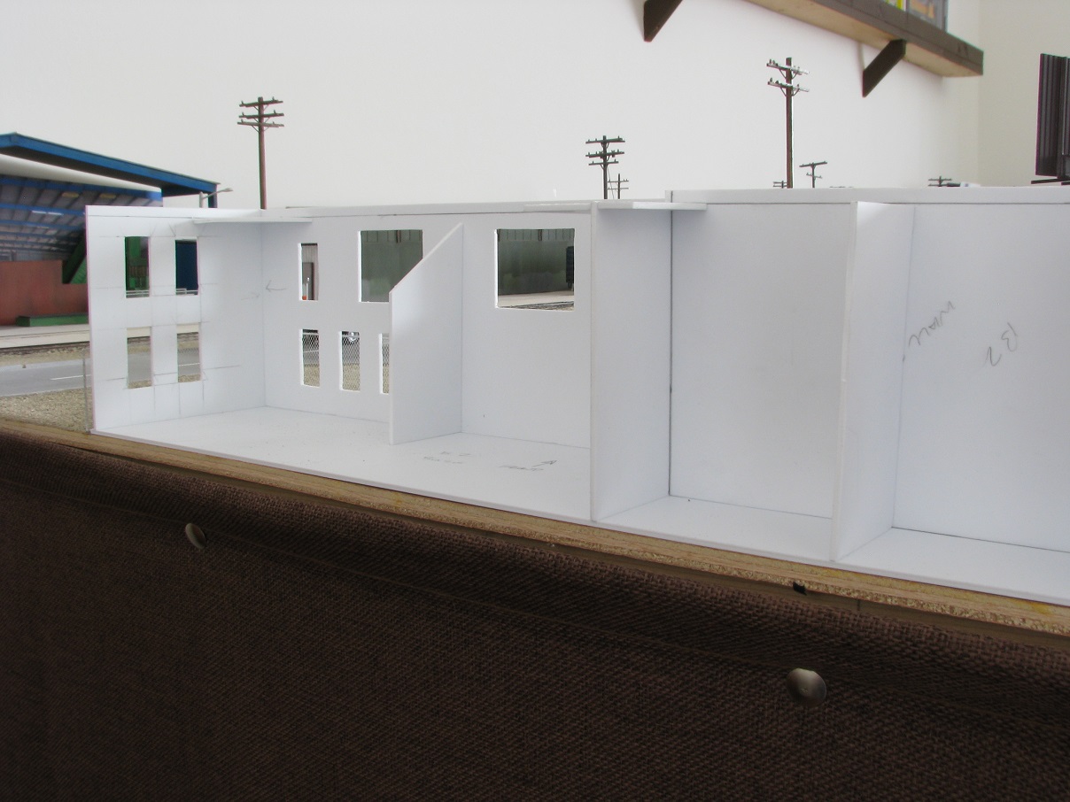

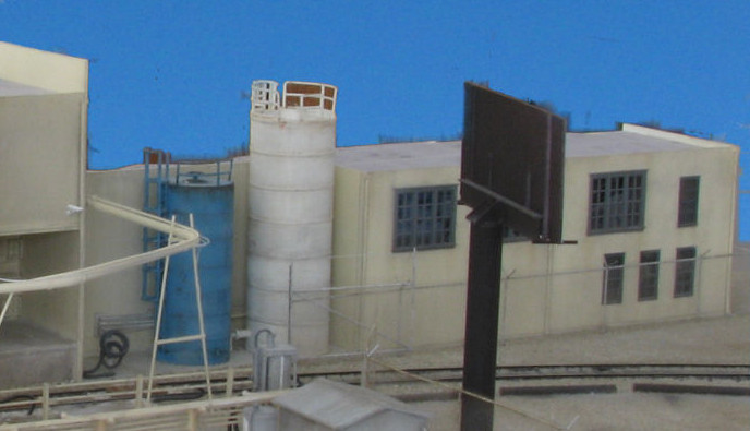

Shortliner, those buildings are .060 styrene and the tanks are .020 styrene. To make the tanks I started by dipping the styrene in boiling water and forming it around a wooden dowel, but that didn't work at all. I ended up just wrapping the styrene around the dowel while I glued it. I used scrap pieces as bracing inside to help keep its shape. I'm putting together a video on the bakery build, I'll post that soon. Thanks for your interest!

Thanks Joseph - the photos of the area are very useful - The area I was specifically interested in possibly re-purposing is this piece and I wondered if the tanks were from a kit or scratched, and also the origin of the building, ie kit or scratched

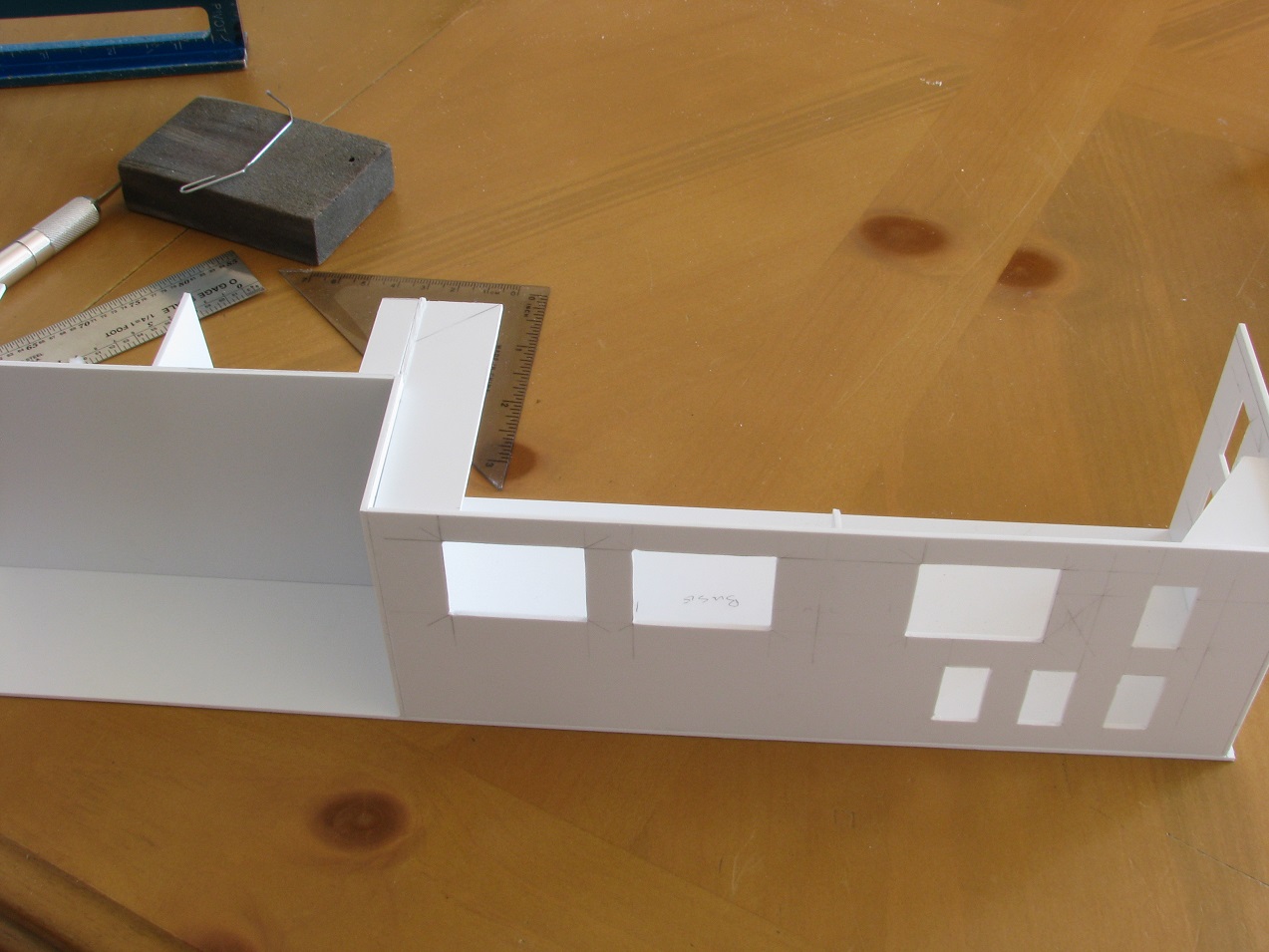

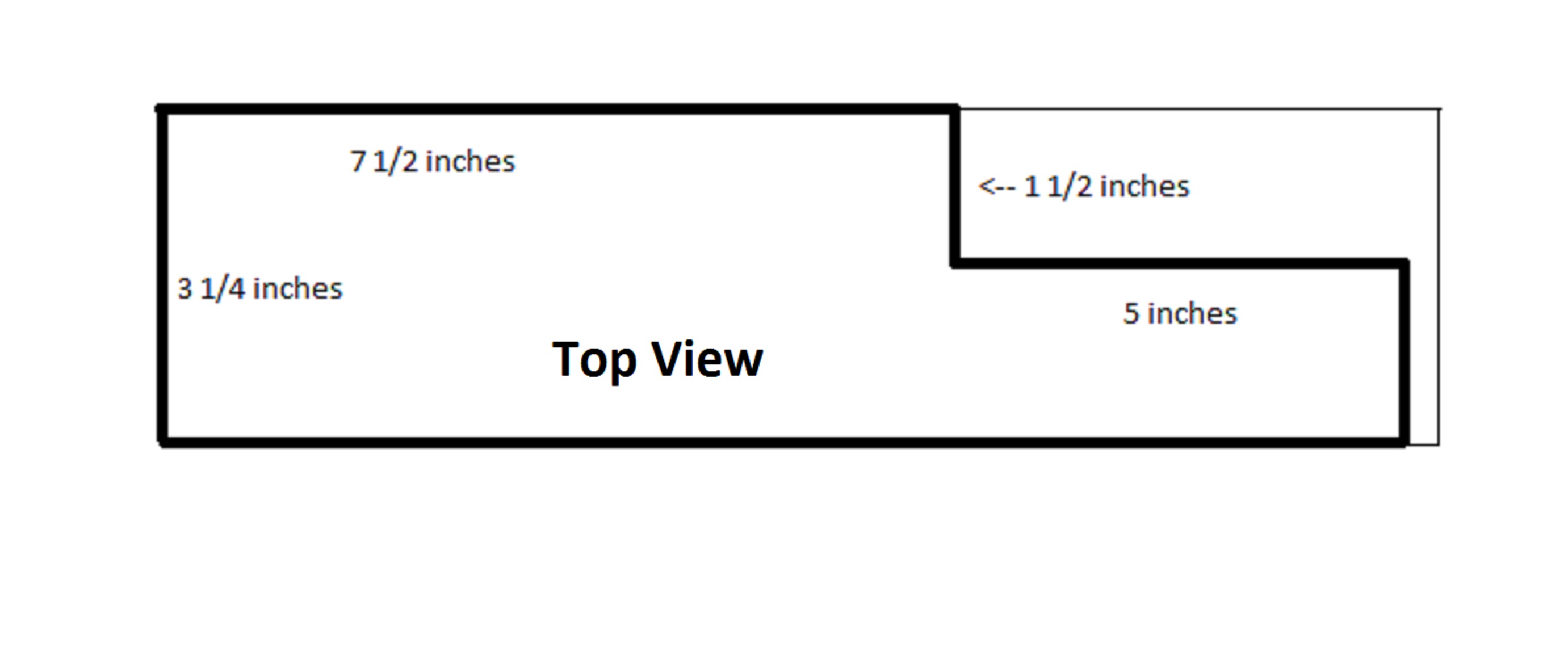

shortliner Wrote:Thanks Joseph - the photos of the area are very useful - The area I was specifically interested in possibly re-purposing is this piece and I wondered if the tanks were from a kit or scratched, and also the origin of the building, ie kit or scratched
Yes everything you see in the photo is scratchbuilt. Both tanks were done using .020 styrene sheet. On the blue tank I scribed panels line before gluing, the white tank I used .010x.030 styrene strips to make the ribs. The railings and ladders were leftovers from a kitbash.
The structure is made from .060 styrene sheet, the windows are Grandt Line.
The base is 13 inches long and 3 1/4 inches wide. The building is 12 1/2 inches long, with the cut out for the two tanks measuring 5 inches long and 1 1/2 inches wide.
Hope this helps with your build shortliner!
