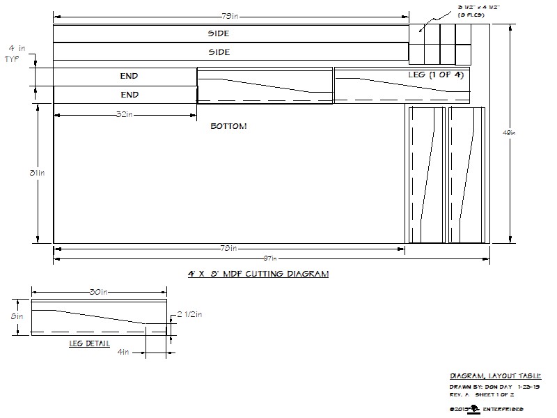

RE: The rebirth of the Canyon State RR - ezdays - 02-02-2019 Oh, the base was made from a single sheet of 4' x 8' MDF, here's the cutting plan: RE: The rebirth of the Canyon State RR - ezdays - 02-05-2019 The bench is just about done, just need a bit of paint, move it out of the garage and attach the legs. Meanwhile, I’ve been looking at a lot of track plans and decided I liked the one I had before, mainly because it allowed for a lot of room for scenery and structures. I’ve modified it a bit and probably won’t stick to it exactly once I get started, since I don’t want to replicate the old one anyway. Here’s my first cut on the track plan, the old one had a large hill and tunnel, I think I’ll use that space for industrial, beyond that, it’s anyone’s guess, even my own.... RE: The rebirth of the Canyon State RR - Charlie B - 02-05-2019 (02-05-2019, 04:21 PM)ezdays Wrote: The bench is just about done, just need a bit of paint, move it out of the garage and attach the legs. Meanwhile, I’ve been looking at a lot of track plans and decided I liked the one I had before, mainly because it allowed for a lot of room for scenery and structures. I’ve modified it a bit and probably won’t stick to it exactly once I get started, since I don’t want to replicate the old one anyway. Here’s my first cut on the track plan, the old one had a large hill and tunnel, I think I’ll use that space for industrial, beyond that, it’s anyone’s guess, even my own.... It certainly looks like a great layout and will give you hours of enjoyment. I'm glad you are finally able to get back at it. Charlie RE: The rebirth of the Canyon State RR - doctorwayne - 02-05-2019 I agree with Charlie, and a layout is a great place to which you can escape. Wayne RE: The rebirth of the Canyon State RR - ezdays - 02-06-2019 Thanks guys, I'm changing my attitude and allowing time for myself. I've now got one day a week (8 hours) all to myself, and I've put everyone on notice that I'm going to start weaving in some things that I want to do and ease off a bit on those that require more of me than I have to give. In short, I've finally gotten some outside help for my wife who needs a full-time caretaker. I'm still it, just that I'm giving myself time to do other things, and this is one of those things that I enjoy doing. Enough about personal things, but this is actually happening after a few years of just hoping... ![]() RE: The rebirth of the Canyon State RR - Tyson Rayles - 02-06-2019 Don it's good to see you are back at it! Model railroading can be great for getting your mind off of any worries you might have. I know it has helped me get thru some major health issues. When I do get back in the RR room time just seems to slide on bye and any problems I might have are left outside the door and cease to exist as long as I'm in there! RE: The rebirth of the Canyon State RR - nachoman - 02-06-2019 I'm happy to see you finding time for a layout again! Very important for you to have time to take care of you when you are taking care of others. I've got twins turning 2 tomorrow - and since they were born my modeling time is extremely limited - but I know that I am a much happier person if I can do any kind of creative project. RE: The rebirth of the Canyon State RR - ezdays - 02-07-2019 Thanks again, you are all right on the mark. I should have done this at least a year ago. We moved so many times that it would have been foolish to just start something then have to dismantle. We are here for the long haul, and I need the respite. I'm glad to see that doing modeling is helping you all, I guess it doesn't matter what you're doing, knitting, painting, collecting, working on cars or, in our case, model railroading, it's a much needed break. Building something, anything, is my passion and this is going to be what I want to do.... The bench is completed and ready to move as soon as I can get Pat (Duffy) to come over to help. Meanwhile, I've got to order track and roadbed, going to go with Fifer unless someone can recommend another place. All the places I used to buy from are now closed, both local and on the Internet. RE: The rebirth of the Canyon State RR - Tyson Rayles - 02-07-2019 Nothing against Fifer and I think he is out your way. Here on the east coast I use Trainmaster Models in Buford, Ga. https://www.trainmastermodels.com/ They are a train only store. You can take a tour of the place on your computer or smart phone. Of course I also use Walther's as well. RE: The rebirth of the Canyon State RR - FiatFan - 02-07-2019 Don - glad to see you working on the layout. Being a health care provider is not an easy task. I hope you have good luck finding track. I have seen on other forums where Atlas track is getting hard to find. One place that apparently still has it in stock is Trainworld. The discussion was about HO but may (or may not) also apply to N. Looking forward to pictures. Tom RE: The rebirth of the Canyon State RR - ezdays - 02-07-2019 Lots of people out of stock on Atlas code 80 flex track. Did find some at Trainworld though. Thanks Tom, got the roadbed there as well, and the prices were good. I've bought from them before, a long time ago. My go-to place used to be Standard Hobbies, but they've been shut down for many years now. RE: The rebirth of the Canyon State RR - ezdays - 02-09-2019 Got it together and in the house. First photos of my layout base. Next step, add foam sheets and start shaping the terrain: RE: The rebirth of the Canyon State RR - doctorwayne - 02-09-2019 Note to self: Remember to remove all loose items before opening handy storage area! ![]() Nice and neatly-done, Don. ![]() ![]() ![]() Wayne |
