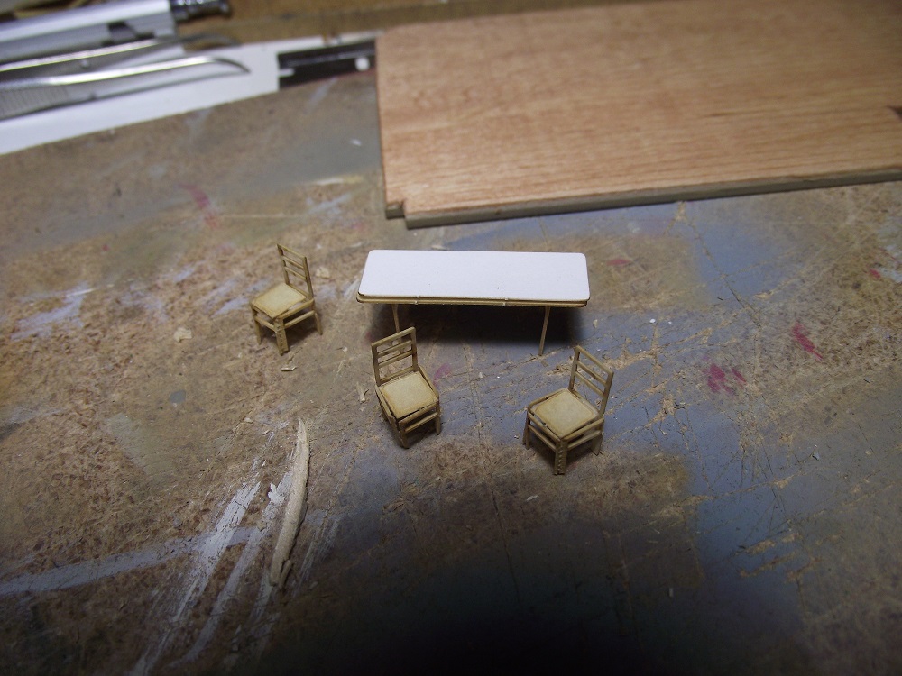

Finally I assembled three chairs and a table. The chairs are sooo small and fragile.

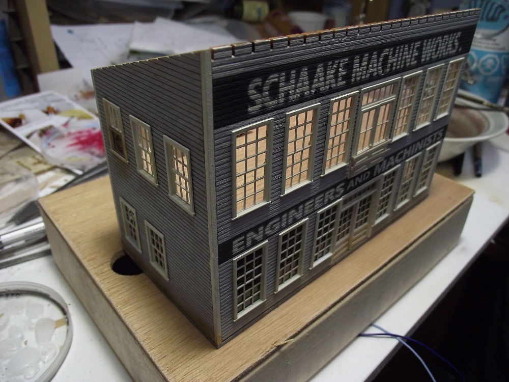

I finished off the first floor today, starting with adding the lighting strip and wiring.
The light strip has  3m adhesive on it's back but I used some epoxy to glue the wiring to the underside of the second floor and painted the wires so they won't be seen.  Then I pulled the wires through the styrene tube I had installed, installed the floor and tried out the lighting.
Looks good to me. Enough light to see the interior without it being overwhelming.

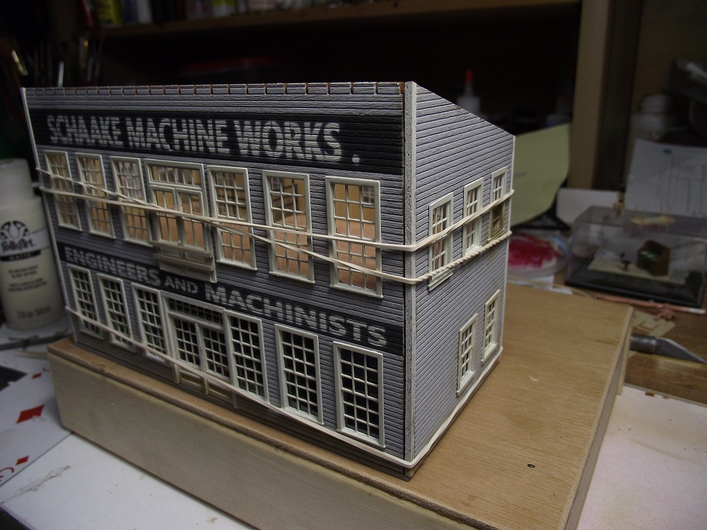

I almost didn't want to put the sidewall up.
But I did. everything fit well except that I had placed the milling machine too close to a wall brace. A quick wilting down of the brace and everything fit fine.

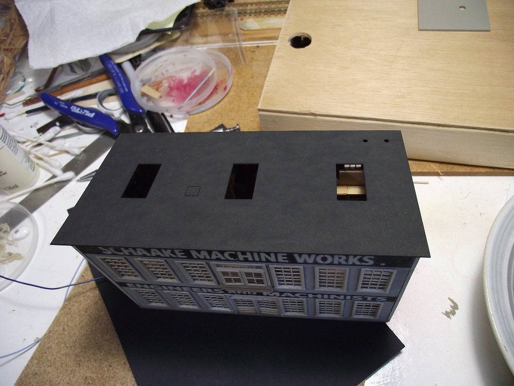

I then turned my attention to the roof. I wanted to make the roof removable so I bordered the inside with 1/8" square basswood. I left the corners to allow the interior wall braces clearance.
Then the test fit. There are holes in the back right for vent pipes and a square that you car remove for a chimney. I decided not to go with the chimney as my interior wasn't designed for one. I also figured that since this building has a boiler house, that would be how the structure would be heated.
The kit has some black construction paper for the tar paper. It works well, if you can get it to stick right. I had to spot glue a few places after to get it to lay right for me. After the glue is dry, you cut out the skylight holes.
There are 24 rafter tails to install. since the roof is removable, the rafters are glued to the roof only.

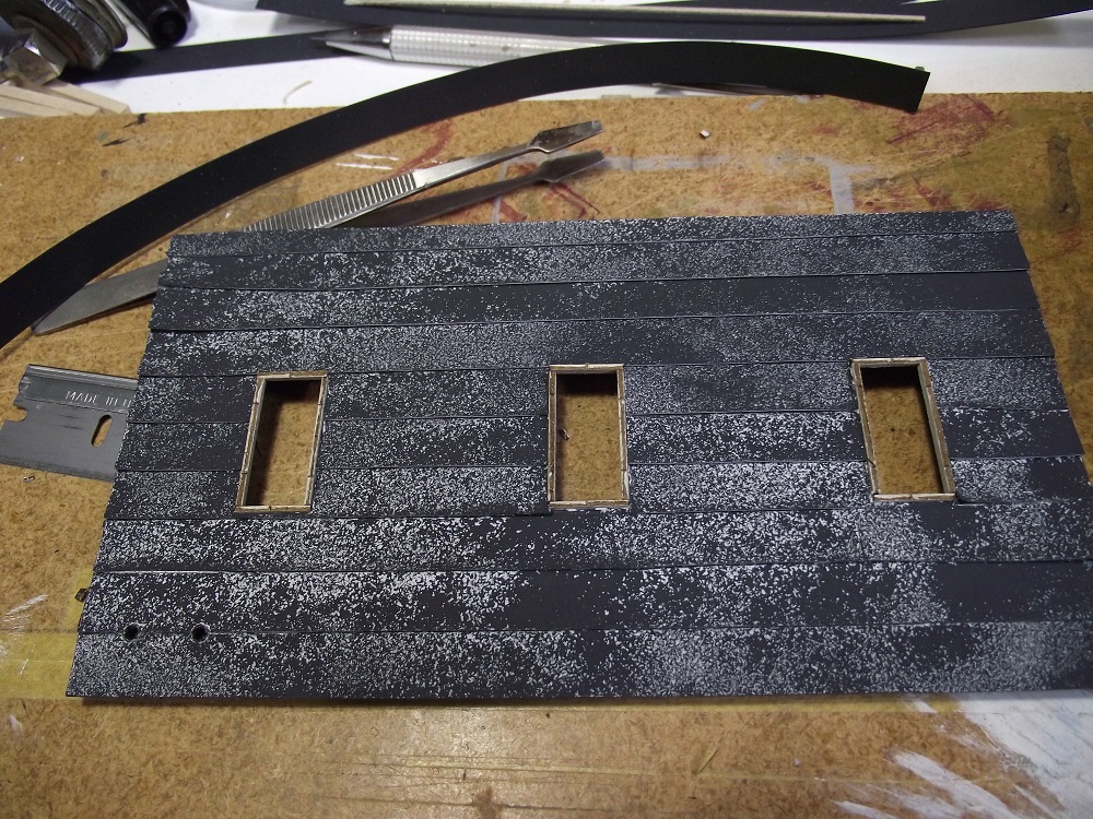

Disaster struck as I was finishing the roof. I had airbrushed it with Vallejo Blue gray, then I sprayed Vallejo's clear acrylic matt over it. somehow it turned this molted, speckled finish. I ended up airbrushing the blue-gray back over to fix it.
 It does have an interesting texture to the roof now. I'll be adding some chalk weather down the road.

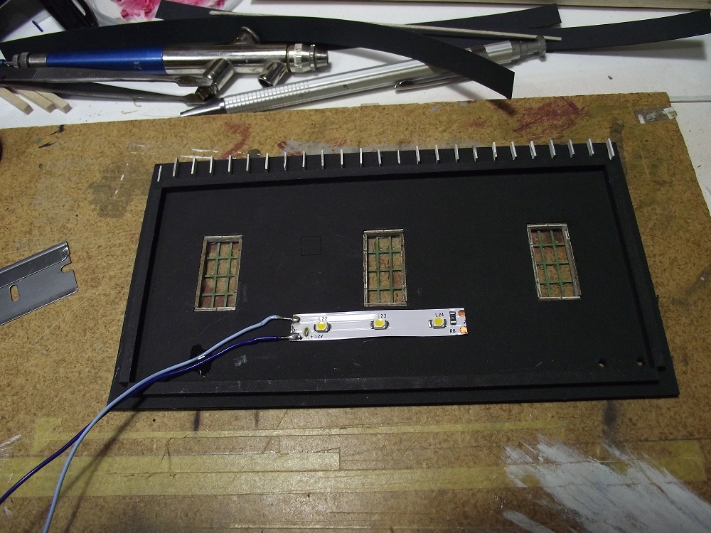

I added lighting the same way I did the first floor. It was a little tight getting all the wires down the styrene tube.

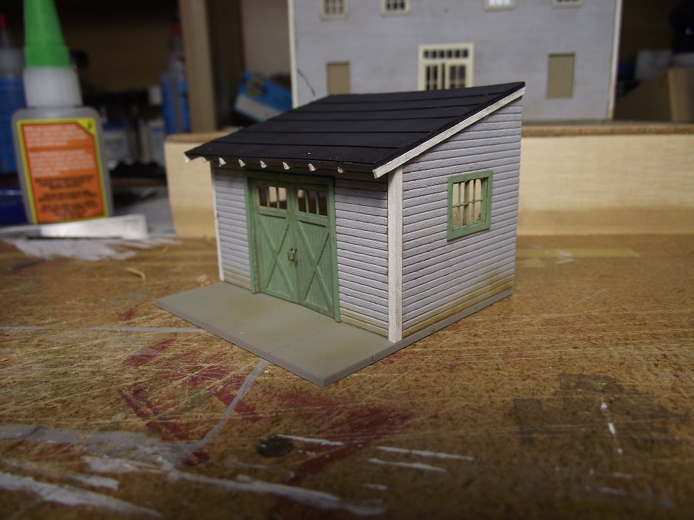

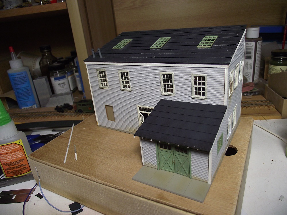

Thanks guys. I finished up the attached shed this week.
It's pretty simple, three walls foundation and roof. I painted the walls at the same time as the  main building, but I went with Apple Barrel's Wedgewood green for the windows and door trim.
Walls to the foundation
and completed with the roof and doors installed. There is a smoke jack included for the shed but I left it off as it is just a storage shed and I didn't think a stove would be needed. The roofing is the same material as the main building, just a little less weathered.
and attached to the main building. well, not permanently glued yet. The boiler house and the shed can be placed on either side so I'll build both before deciding and the final configuration.
