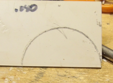

been off the model track too long so i  made the decision to build a Quonset hut that more reflects the era i model most of the surplus ones sold in the 50's were of the 16 by 36 size so I started by laying out an 8 ft radius piece out of .040 to use a mold to bent some plastruct ho corrugated sheet over it to start. now to cut it out.

RE: Quonset hut - Ensign - 12-16-2024
Jim, it looks like you have the job half done already! Smile
Best of luck with it.
Greg
RE: Quonset hut - jim currie - 12-18-2024
well, got the template cut our and the first attempt to bent plastic was a flop glue caused corrugations to flatten might try uv set glue on next attempt.
Jim
