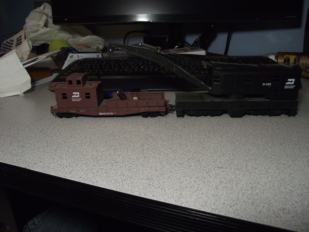

I was recently given this:
To repaint into this:
I also have to rework both the crane and boom car to convert them from truck-mounted horn-hook couplers to body mounted Kadees.
Wish me luck.....

Change of plan:
I found an Athearn Crane and idler car at an estate sale that is a much better model than the IHC. This also has frame mounted couplers that the customer wanted. I've been disasembling it and getting it ready for paint.
And while I was at the sale another modeler bought a second Crane and idler car that he wants me to paint in Northern Alberta Railway. I'm still looking for good photos and decals for that one. In the meantime, I'll be working on the Canadian National version.
Dissasembly and primer over the last couple days.
I took the crane and tender apart, mostly. I removed the carbody but left the mechanism together as I can't remove the swivel assembly since it was glued together.
Everything took a swim in isopropyl alcohol for a day or two.
I then airbrushed a light gray primer from Vallejo on everything. I masked the inner cab mechainism before painting. I'll leave this unpainted since it will be inside the carbody and I don't want the winches being gummed up.

Getting back to the project at hand. I started to look at the back of the crane's body:
I had two issues with it. One, the crane had been dieselized so the was no reason to have the large coaling doors in the rear, as well as the cast-in ladders. Two all these detail would make masking the black and white lines very difficult so I sanded the back smooth:
Then a quick repaint in both primer and then white
