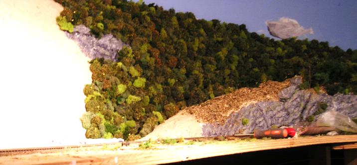

1) The greater the distance, the smaller the tree. The further away the viewer is, the less distinct that tree will appear. Conversely, the closer the distance, the larger the tree can be and the more detailed that tree should be. Also important - the further away the viewer is, the more the color of the mountain becomes unified. The closer you get to the trees, the more you can see that there are actually many shades of green, blue, brown, red, etc.
2) For those that model trees on mountains (as I do) - Take a look at a mountainside and look at the trees. Only those on the bottom of the slope can be seen in their entirety. Anything higher than those base trees is nothing more than a green 3-d blob. Therefore, for a very flat simulated hill, you really only have to have detailed trees on the base of the mountain in front of blobs of green to convince your viewer that there is a mountain there.
Here's a great example. I actually fabricated ZERO trees to create most of this mountain, and the distance between the track and the backdrop here is no more than 4 inches. Note that the colors change more at the bottom of the moutain and the trunks are not visible other than at the base of the mountain. I got this idea from a short article in Model Railroader from an issue in the early 80's...
