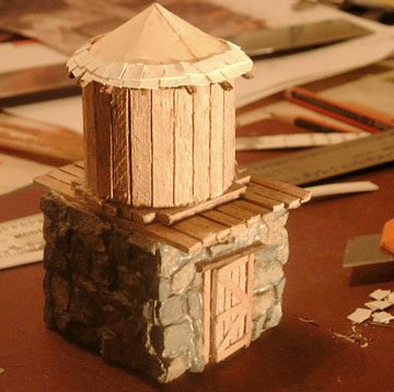

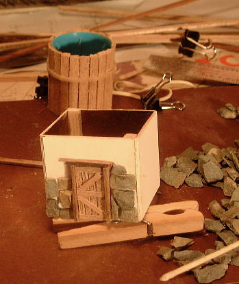

Made the tank by glueing timber round a spraycan cap,after fist wrapping it with masking tape, acardboard box was made for the plinth
Stone Mason at work
Tank mounted on the plinth,note white glue run in to make the morter, disc cut for the roof and therafters being glued in tanks height was reduced to suit layout
Roof being shingled

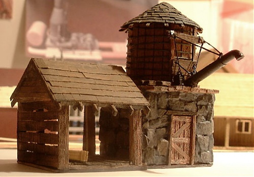

Shed construction ...note rafter jig and cereal box
Shed erected andshingled,water spout as per tip from Masonjar for using apaint brush handle
Last one This is where it will be placed on the layout
. the rock chips are from a load of agregate that Stuart is useing to make concrete foundations, the rock is crushed waste rock from the mines
