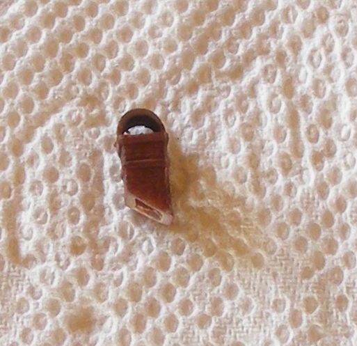

First on the list is making this rather distinctive chimney.Mine was made from a chimney from the junk box and a piece of tubing drilled out to make it thinner.Next up will be to splice the buildings together and making a loading dock.

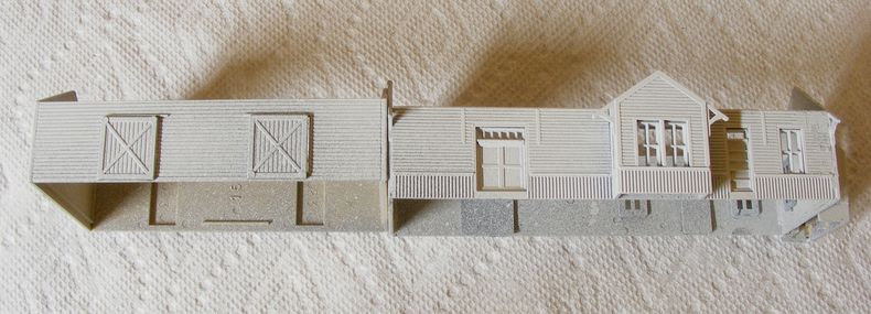

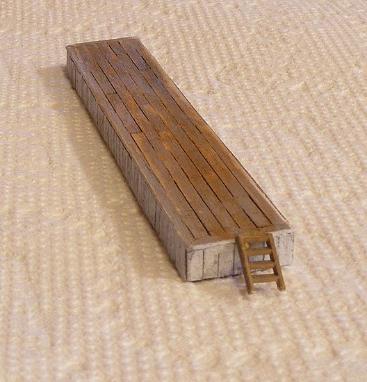

In between hot water heaters leaking and propane heaters not heating I have goe a few things done. The first pic of the two buildings grafted together. I changed out the original small doors on the freight side with larger ones and on the right end (where you can't see it in this picture Curse Wallbang ) I added the lean-to and changed out the window on the left for a door. The second pic is of the dock. The loading dock is stripwood applied over a block of balsa wood. There are 54 upright pieces 1/8" by 1/4" and 38 pieces on the deck 1/8" by 1/2" and/or 3/4". The ladder is from the junk box and the overall size is 5/8" by 4".

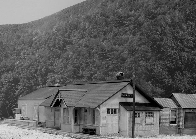

It took awhile to get around to finishing the depot mainly due to the fact I was goofing off! I wanted to get the look of the prototype, but I did this on a tight budget so if you are a nitpicker you will find plenty of nits to pick. Eek The first is the real one in 1967 and the second pic is my version in the same time period:
Excellent structure and fits great into your layout.
Looks better than the real one !
T
Very nice, but I couldn't see any nits worth pickin'.
Thanks guys! Reinhard it's sitting on a photo prop I made as the part of the layout the depot goes on doesn't even have benchwork yet! Eek
