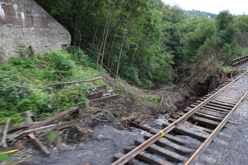

The last thing that I want to get to is the weather....The rain and Hot, Humid weather has been relentless this summer leading to some equipment problems and crew fatigue. It has also taken it's toll on the railroad. At this time there are several wash outs on the Pocono main. Yesterday after time spent working on 664 and the "B", Toptrain and I went to check one out at the western portal of the Nay Aug tunnel. These washouts have put this part of the main out of service for the next two weeks. So now hopefully we will be able to get some restoration work completed and the main will be open for Railfest and our convention.

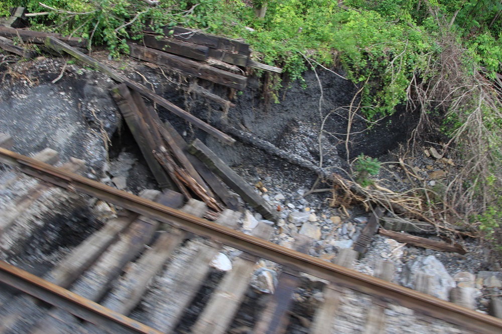

A shot of an ATV that crossed in front of us, if the line wasn't restricted to 10 MPH we'd still be picking parts of this guy out of our front coupler. On the right just past the ATV are some barriers. Between them is a fire trail that is gated and locked, the only way to access this point is the fire trail. The ATV came out from the trail , turned left towards us, then jumped off the tracks to where it is in the pic.

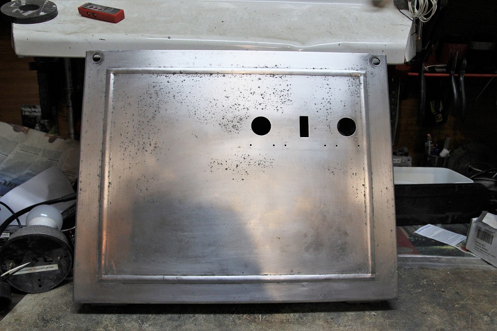

The rewire is another story.. When we first wired the starting cabinet, we did it as per the old EMD drawings. Then the new Main cabinet was installed. We did not even consider that this could be a problem until we tried to get the starting contactor, kill circuit, and fuel pump to work with the emergency shut off. With the type of relays in the NS controls it just was not going to happen. luckily all that is needed is to change out and rewire the fuel pump switch and remove the old start button from the circuit.

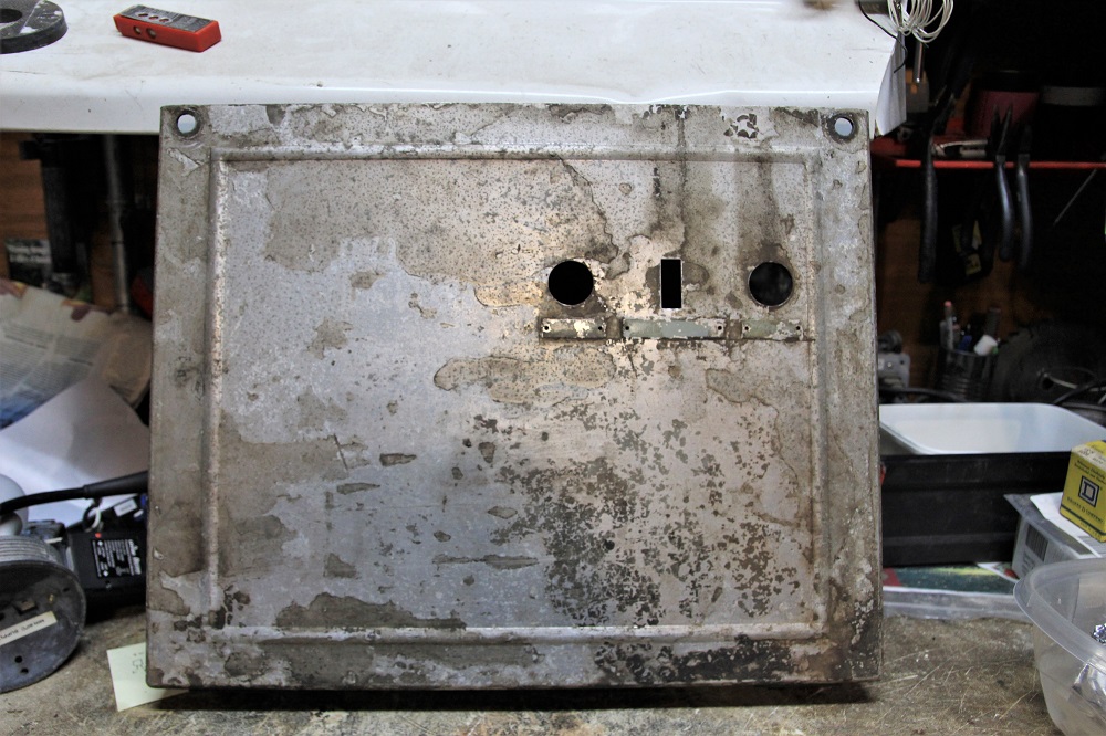

I removed the cover from the starting cabinet yesterday and took it home with me to get this project going. Here's what it looked like when I got it home.
After some cleaning with white vinegar and tin foil it looked like this, after a quick buff with some fine steal wool.
That's the new switch on the left , and the faceplate for it on the right. I located the holes for the new switch and drilled them out. I also had to re tap the mounting holes in the switch... Screws were not included to mount it to the cover, and I could not find a match for them , they might be metric. So now they are a standard 10/32 thread.
Posts: 2,724
Threads: 160
Here it is with the switch and nameplates installed. I had to close off the old start button location also. I re-inked the old nameplates and reused them for a more finished look.
This shows the back side of the mounting.
The last thing that needed to be done was to make up a legend that tells you what each terminal does in each position. I went over the switch with an ohm meter and printed out my findings. I laminated it to the back of the cover with some clear packaging tape.

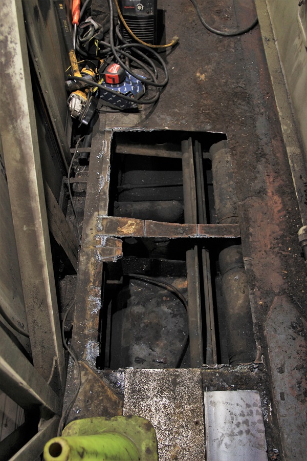

It will latter be covered with a layer of aluminum with the EMC or EMD logo on it. If you look back in this thread I'm sure you will find a pic or two of it. In this shot you can see a section where the floor has been cut away and not replaced yet. The fuel fill line is visible along with some of the conduit for traction motor cables.
This job should be complete in about two weeks. We want it finished before there is another threat of a new shutdown. I will remove the governor connector next week to rebuild at home. I had talked about this earlier in this thread.

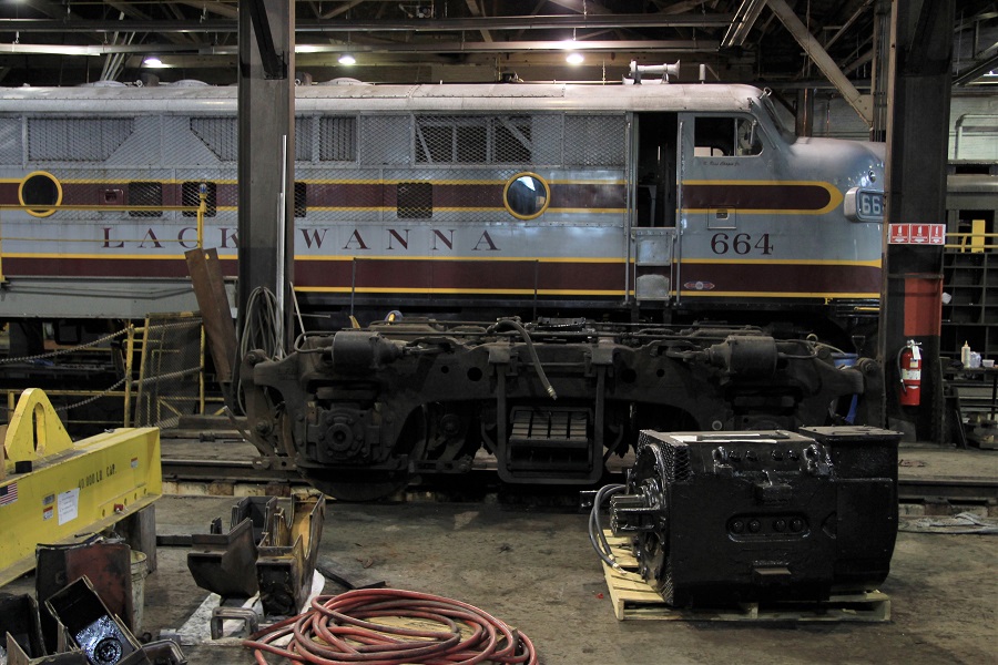

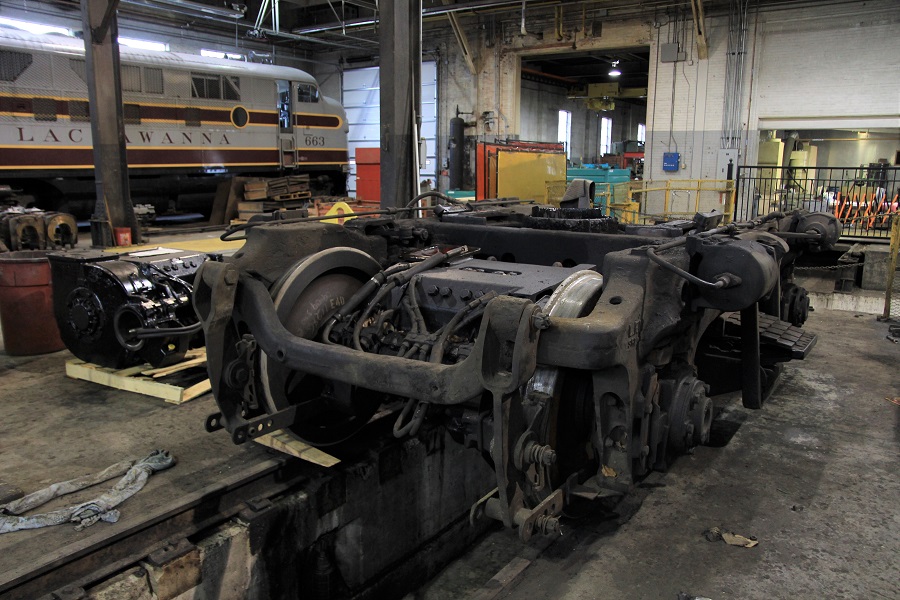

The rear truck from 664 has been removed and ready to be exchanged with the proper one now under 514.
Bet you didn't know that f-3's could fly.
Here's a look underneath where the truck would normally sit. # 1 is the truck kingpin
# 2 are the two air ducts that are connected to the traction motor blowers located in the car body. These direct cool air over the motors to keep them from overheating.
# 3 is a set of wires that bring power to the traction motors, There is another set to the left that is not in the photo.
#4 are the air line for the brakes .
#5 is an old set of pipes that were connected to the boiler to deliver steam heat to any passenger cars in tow. The boiler was removed years ago by the BAR.

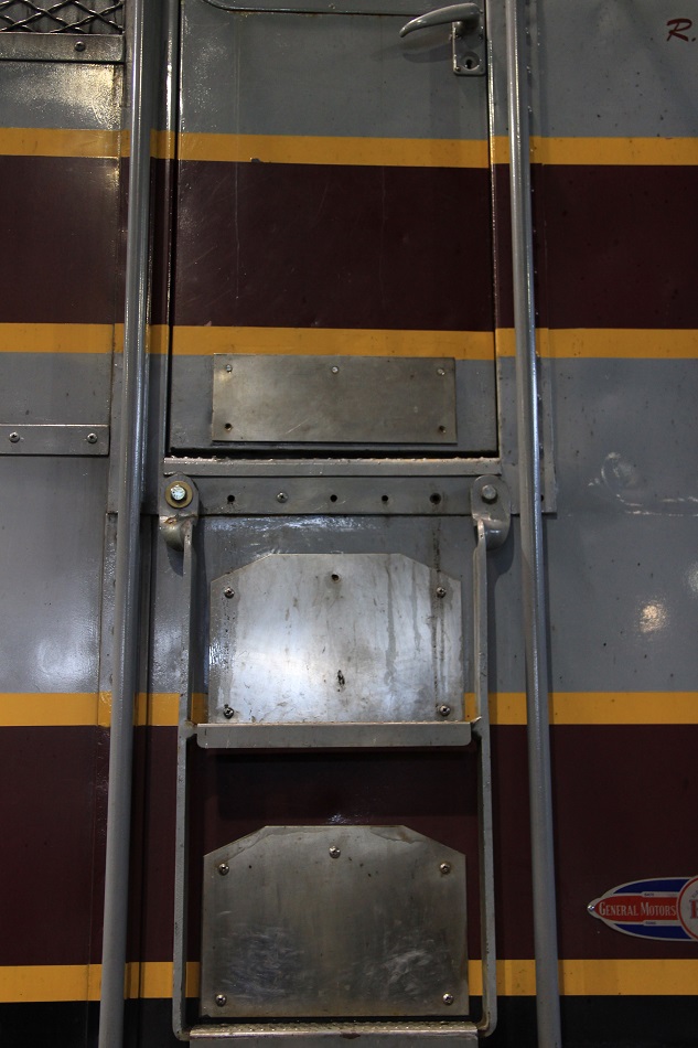

We have also added a few of the missing stainless steel kick plates under and on the door of 664. We still need to drill and tap some of the holes to finish the job.

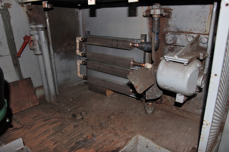

In the Cab of 663 the heater core has been replaced with a new one. It mounts under the "dash board" on the fireman's side. I'm not too keen on the plastic pipe fittings, but I have been assured that they will be fine.

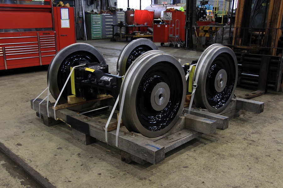

We have also just received delivery of some new wheelsets for the pilot truck of the B&M steamer that is also undergoing restoration. The rest of the truck is now being rebuilt and is in all kinds of pieces, all over the floor of the shop.
