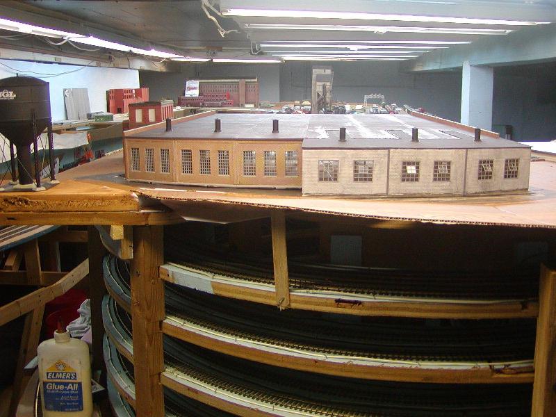

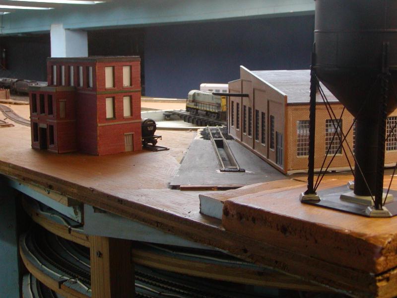

Hi all, back with an update. Thanks Wayne for that last idea, I wound up using it. With the roundhouse done I worked on a few other things while I waited for a friend to come over and help me get the roundhouse installed on the layout. I had soldered leads for the stall tracks to the bottom of each rail and needed to place the wires thru holes drilled in the subroadbed whlst the roundhouse was lowered into place, so needed more hands. I hate soldering feeds to the outside of rails! Particularly in this case, with little room between the pit and roundhouse doors, all glued in the open position, I saw no need to be opening and closing them. So I built and decaled a steel water tank, and scratchbuilt a small shed and an office for train crews. A few new pics, and some more questions:
This pic is taken from the end of the peninsula. You see the H column suggestion has been used, and I like the look. The smoke stacks have been moved back and the new roof sections have been hot tarred in. You can see most of the water tower to the left, with the JGL logo on it. I have ordered the neagtive ion generator needed to build the static grass applicator and when it arrives I look forward to growing some grass on the hill behing the roundhouse.

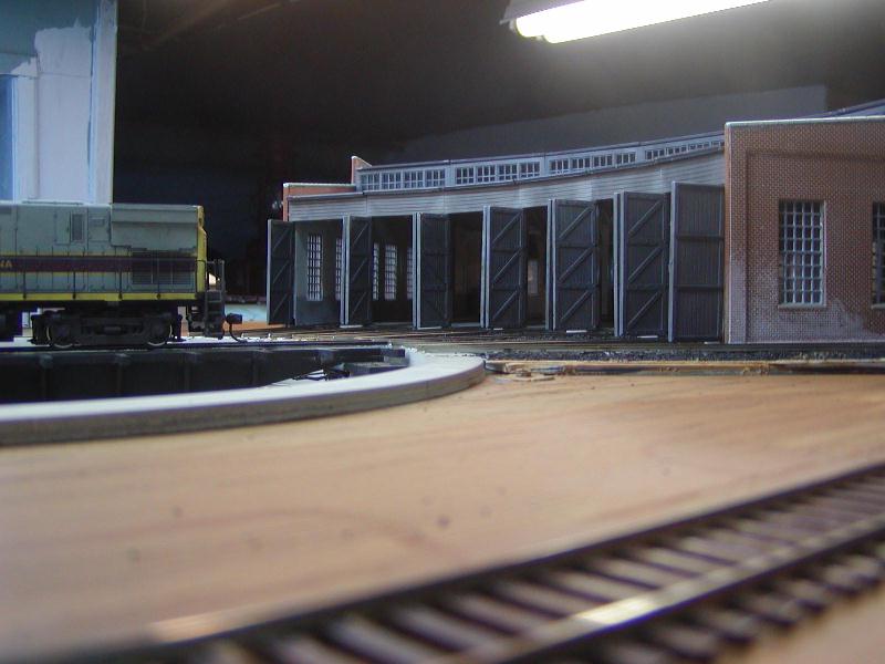

This pic shows the front of the roundhouse from ground level. It was taken while programming the turntable for the stall tracks, hence the diesel on the tt. A quick question: You see the whitish blemish on the lower corner of the roundhouse wall? I believe this was due to the alcohol spray I used to wet the ballast on the stall tracks in prep for glueing. The walls had previously been given a coat of dullcote to protect teh spackle mortor from coming weathering. Am I right in remembering that another application of dullcote to this area will return it to new?

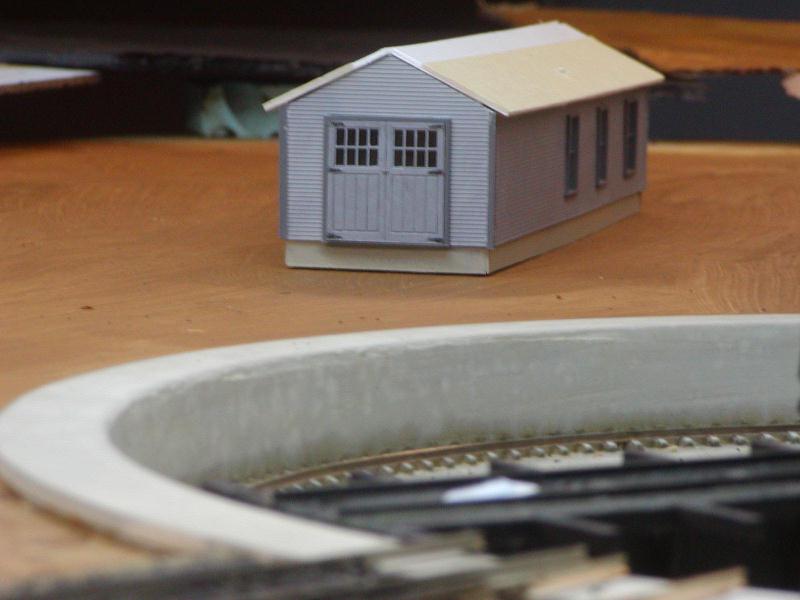

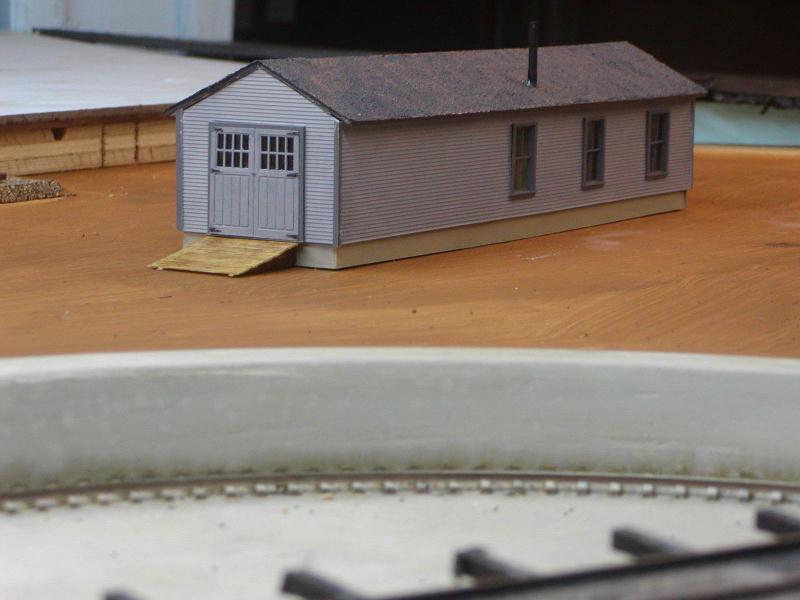

The small structure I built, about 2/3s of it are office space for train crews reporting to work, etc., the rest is storage. I will make a timber ramp to the doors shown, the area to the right (between it and the roundhouse) will be suitably cluttered. I have sifted fine sand onto glue spread on the roof and it is ready for painting, will do so shortly.

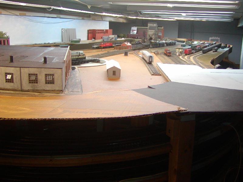

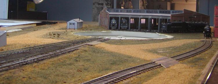

Last pic for today is from the other corner of the peninsula. It shows the overall scene. The white board to the right is the footprint of the corp offices. I am struggling with a design for this structure. The black foamcore next to it will be the parking lot/entrance to the yard. The brown painted cardboard to its left will be grassy hillside running across the rear of teh roundhouse to the water tank. The siding with the passenger car sitting on it is for spotting the presidents private car at the office. The small office mentioned in the prior post will sit approximately where it is, a road will run by on its right. You can see in the distance another small shed I built. So there is plenty still to do!

Gary, Alcohol does "whiten" dullcoat, and I have heard that an overspray of fresh dullcoat will correct it....haven't tried it...yet, but several people have made that statement.

Thanks for confirming what I thought I had heard Pete. I reapplied the dullcote and yes indeed, it returned the finish to as it had been.

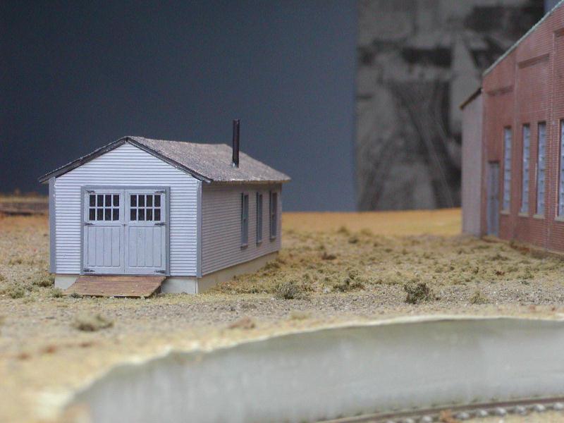

Finished the small office/storage bldg, here it is, I hope to "plant" it today. I need to gather some dirt from the frozen ground in the backyard and put it in the toaster oven first.

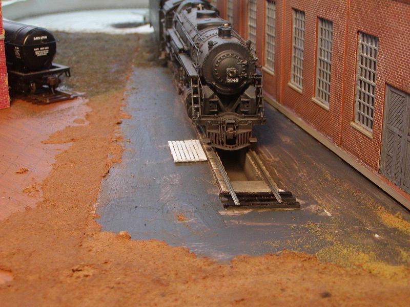

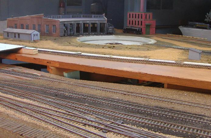

Here are some pics with initial layer of ground cover in place. Any commnets/criticism welcome, do not be reluctant to criticize, it is the only way for me to improve! Particularly colors. As is, the roadway is infield clay and seems to orange. Another layer needs to be put down, in which I will make tire ruts, potholes, etc. And when I'm done working in the area, some static grass will go down, I just built the blaster from the thread Wayne had posted. Details need to be placed too.

A picture of the outdoor inspection pit, I have to build a lot more of those platforms for workers to stand on while oiling around. Scene comes from a pic in a Lackawanna book, the roundhouse in Hoboken, NJ

:jawdrop: wow! even with the basic ground cover on the scene is looking fantastic! anf your roads dont look to orange at all,they appear to be the right shade to me.but man,wow...... --josh
