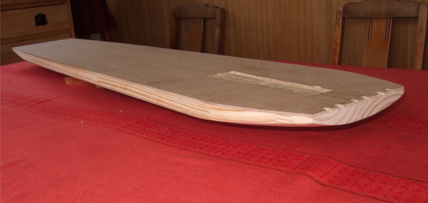

:? :? Big skateboard or small ironing board :?:
Cheers, the Bear

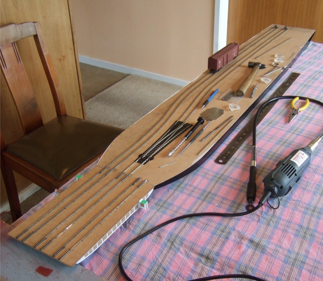

Is this what is meant by the term " Half track"????
Cheers, the Bear.

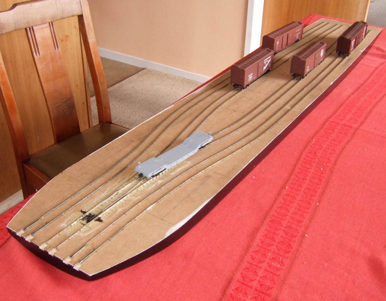

Gidday All, At least I now have a carfloat.
Cheers, the Bear.
Posts: 5,859
Threads: 175
Lookin' good! Feel free to barge in anytime.
