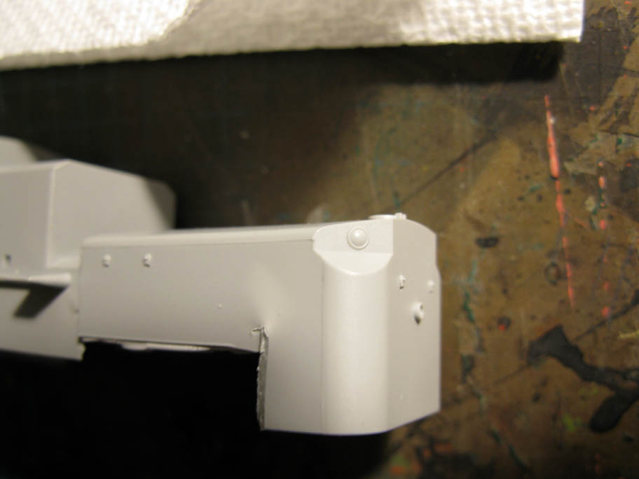

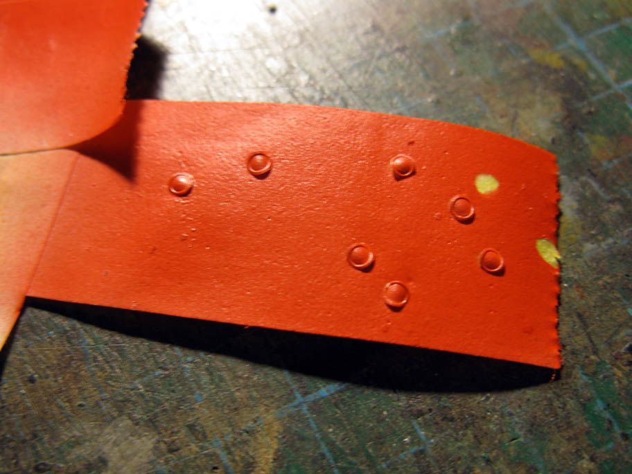

When I bashed my models, I didn't care about the classification lights located over the numberboards. I knew I would have to do it at some point but had not idea how to do it. Later, I painted the model and decalled it. I thought I was too late to put the classification lights. However, I was quite dissastified not having them.
[Image: IMG_9687b.jpg]
My first idea was to simply drill holes and add MV clear lenses. While the idea was interesting, I don't have enough MV lenses on hand and the classification lights wouldn't had their characteristic steel rim.
[Image: IMG_9690b.jpg]
The other option which I implemented was to scrap off details from discarded Atlas shells. It was surprisingly easy and after a coat of paint, it looked just like the real thing. The lights were then glued directly on the model. The mess was minimal and as you can see, orange paint touch ups are going to be minimal. Next step will be to add a touch of aluminium paint over the lenses. According to prototype pictures, the lights were very dirty in the mid-1980s.

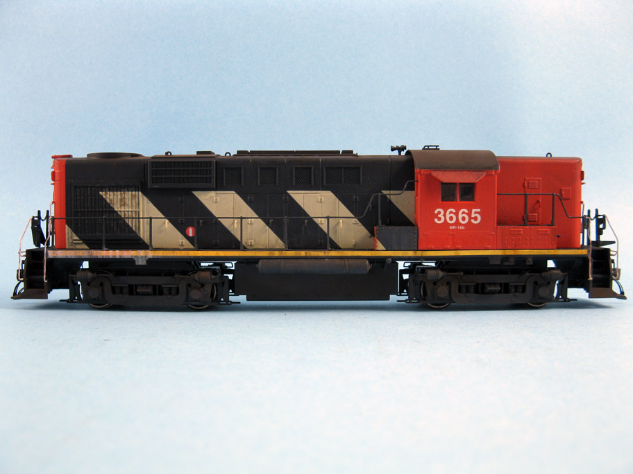

All good things must come to an end and I'm proud to say I finally can see the light at the end of the tunnel with this mad project. Weathering was the last step and I did it yesterday. It was quite a straightforward process and I surely did not try anything too much artsy.
[Image: IMG_9739b.jpg]
Since RS18 are the backbone of the fleet, I didn't want them to be garish rust buckets. Most pictures of the 1980s show them as well-maintained and rather clean locomotives except the proverbial ALCO soot covering every square inch of horizontal surface. Most typical wear was white paint peeling off on railings, dark streaks on the running board and some whitish dirt on the long hood on a few units. Trucks were generally clean and not too dusty (at least on pictures of engines assigned in Quebec then).
[Image: IMG_9740b.jpg]
I believe a good weathering process is about reproducing what happens in real life. My first step was to fade the as if it was degraded by UV rays. A very diluted tan color wash was sprayed over the models until satisfaction.
[Image: IMG_9741b.jpg]
The second step was to build up the ALCO typical dirt on the roof. Working with prototype picture, I was able to find out the short orange hood roof was almost black and the soot was running down along the vertical sides with rain. A wash of India ink/alcohol was used to mimick this effect realistically. Also, a very thin coat of this wash was sprayed all over the model to dull it a little bit just like the prototype.
[Image: IMG_9742b.jpg]
When dry, I used a special wash used by Warhammers' modellers called "Null Oil" to add some dirt in the long hood panel lines. It is a very potent stuff and I was careful enough to dilute it a little bit prior to use. It was particularly effective on louvers. Only unit 3623 got that wash over the orange paint. It almost ended up in disaster but I was able to save the day.
[Image: IMG_9744b.jpg]
The next step was to use AIM weathering powder to give some texture to the roof, trucks, pilots and fuel tank. Prior to this, the trucks were sprayed with Krylon black and camouflage brown spray paint, giving them a nice warm black shade.
[Image: IMG_9748b.jpg]
Finally, oil paint and odolourless solvent were used to add streaks to the running board. An easy job done following prototype. Each locomotive received different streak patterns and colors to make sure it wasn't too uniform.
[Image: IMG_9749b.jpg]
Unfortunately, at this point, I sealed my weathering job with Dullcote. In a matter of seconds, all the textures were lost and the models looked almost brand new albeit with color variation effects. To counter this, I sprayed a new tan color wash over everything. The wash was very thin and thus didn't really affect the overall coloration. In fact, it helped to blend everything together. Finally, a last coat of weathering powder was added and I kept it as is.

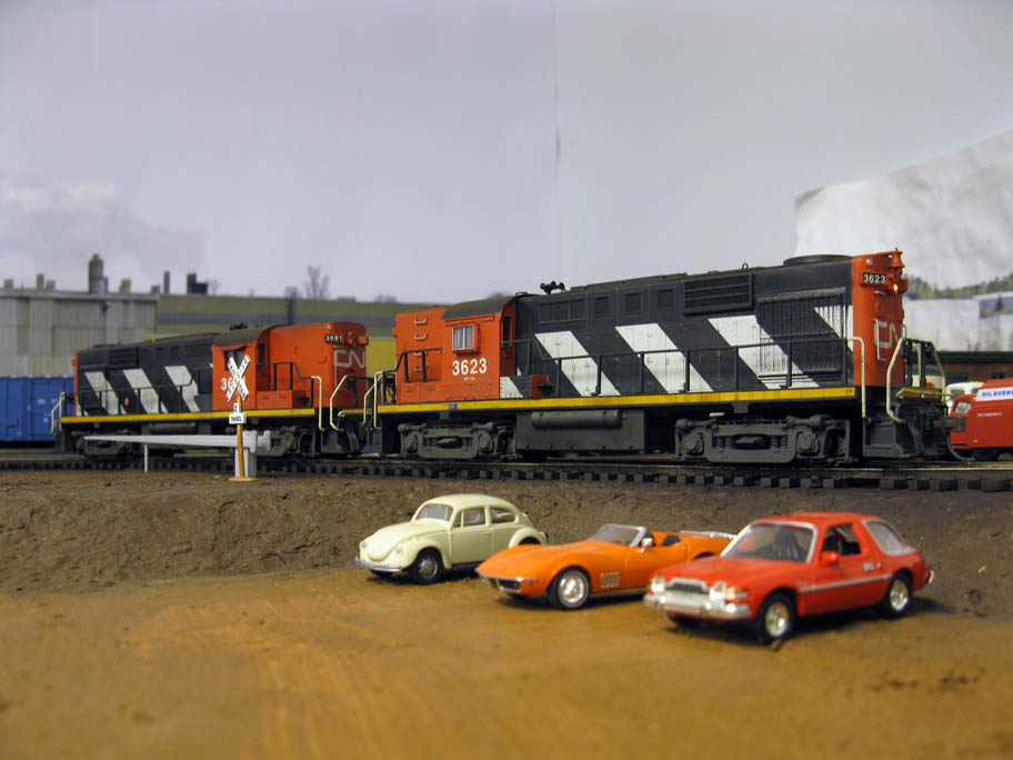

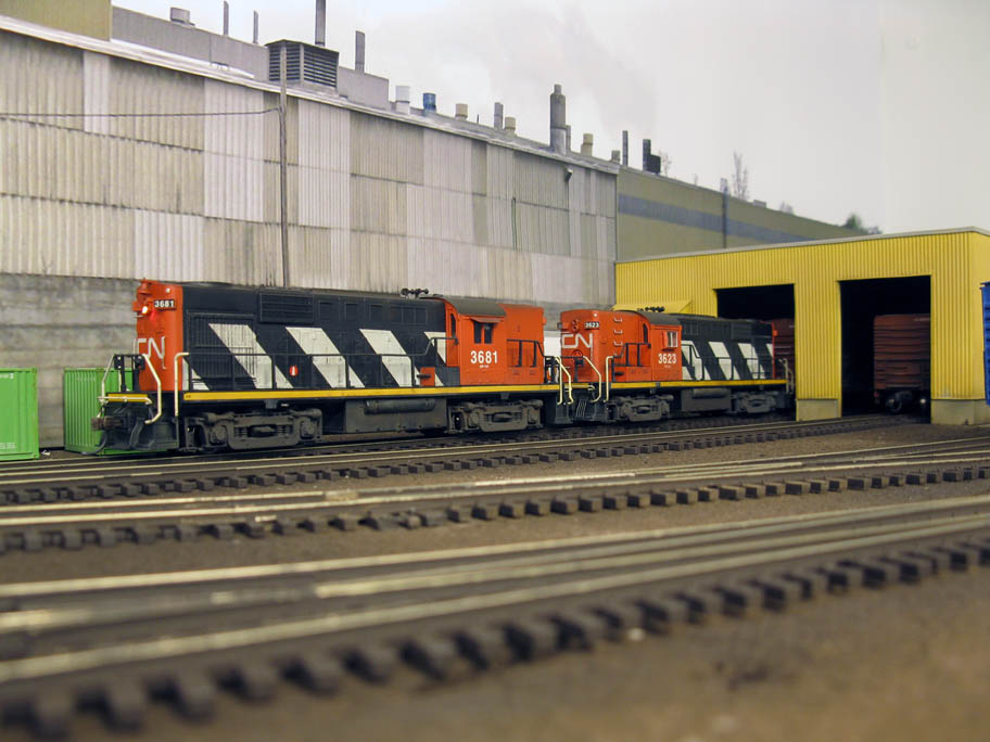

Thanks guys! They were fun to build and not that hard in fact.
I thought you would enjoy them in operation mode.
