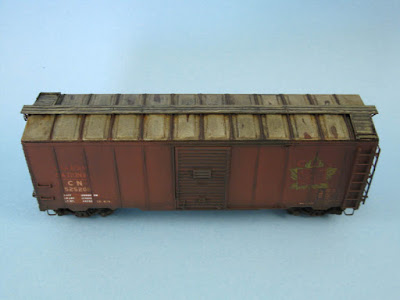

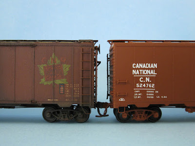

As if it was not enough, I decided to update an old Intermountain CN boxcar I painted and lettered. My goal was to represent a very decrepit car still in revenue service circa 1985.
[Image: IMG_7641b.jpg]
[Image: IMG_7642b.jpg]
[Image: IMG_7637b.jpg]
[Image: IMG_7643b.jpg]
http://hedley-junction.blogspot.ca/2015/...story.html

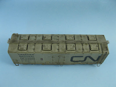

And the last one was about using an extra True Line reefer shell painted the wrong color to make a believeable car. I had to make a new underframe and details for it.
Before:
[Image: IMG_7648b.jpg]
After:
[Image: IMG_7697b.jpg]
[Image: IMG_7698b.jpg]
[Image: IMG_7700b.jpg]
http://hedley-junction.blogspot.ca/2015/...-cn-8.html
