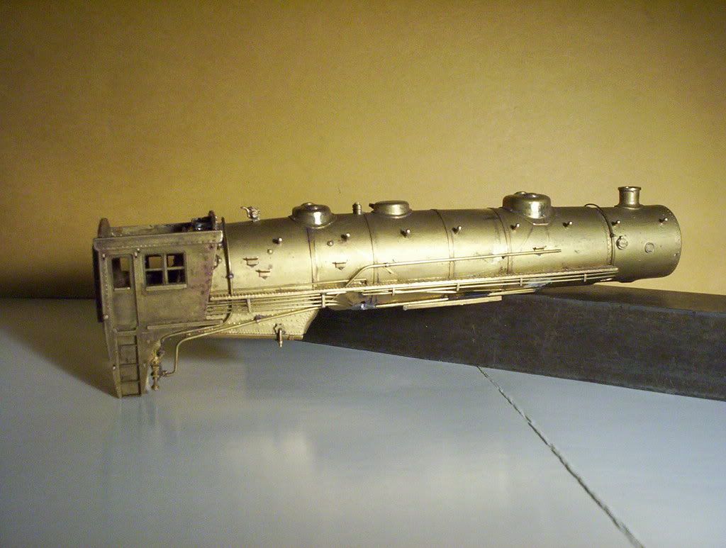

Hello,
as the shell of the loco is square now, let's re-attach the details:
[Image: dsc04541qgkn2.jpg]
[Image: dsc04544amkih.jpg]
I made a new tube out of 0.8mm brass wire for the compressor as the old one was too short.

[Image: dsc04542ihk4q.jpg]
[Image: dsc04543f1j0q.jpg]
- starter valve on engineer's side remounted; here it is still askew and has to be squared out
- New tubes under the running board made out of 0.5mm brass wire (the old ones were worn out)
- remounting of the injector here too
[Image: dsc04545oak1v.jpg]
