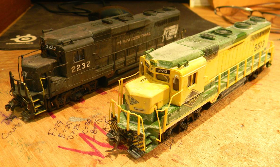

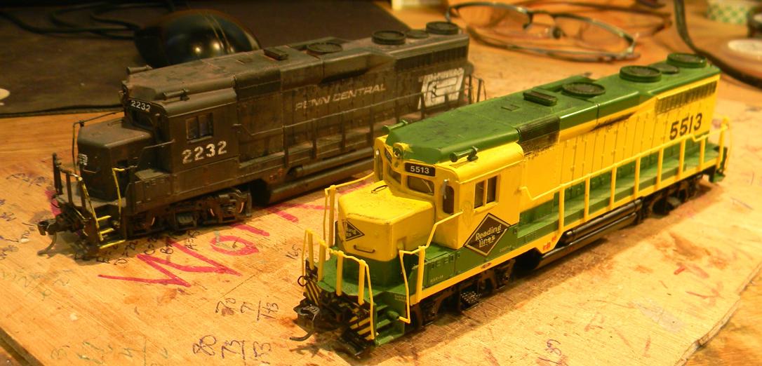

Weathering/reweathering...  Here's a shot of the befores (as discussed, I'd hit the intakes and exhausts last night):
Goals are different here, I want to redingify the PC unit with a prototypical goal of this: CR 2205 Rutherford, PA 11-12-1983 | Conrail Photo Archive, and the Reading unit will be weathered and THEN patched with CR decals to mimic this: CR 2181 Tallmadge, OH 09-12-77 | Conrail Photo Archive.  The Reading unit's paint is way to bright, so in the first phase I will fade the paint with (maybe) multiple coats of Tamiya base mixed with rubbing alcohol with handbrushing between coats to remove excess chalkiness.  I'm pretty happy with the base color of the PC unit, but I just need to adjust the rust placement, so my first order of business there is to give the whole unit a gray wash (arcrylic white and black mix with rubbing alcohol and applied from top to bottom with an unstiff paintbrush.  Here's each unit after a coat drying on each (no removal of base yet on the Reading unit):

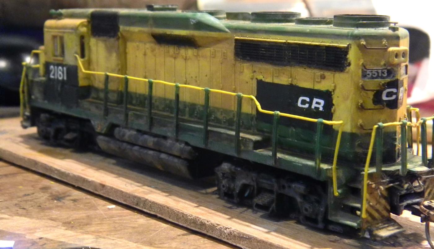

As I scrutinized the prototype photos (Charlie's photos were really helpful as well), I noticed that Bachmann had a yellow stripe below the deck on the sides (rather than green) and the vertical portions of the handrail stanchions were green.  That took mulitple handpainted coats to get right.
I hit the Reading unit with a wash of gray first - it emphasizes each panel and crease in the shell and mutes the yellow even more.

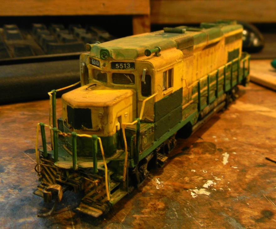

Next came rust wash, but applied in keeping with the prototype.  Here's the end result.  I still have to patch the Reading unit, but that'll wait until later this week.  The final touch will be some small application of PanPastels after the patching, but I'm happy with the aging process to date.

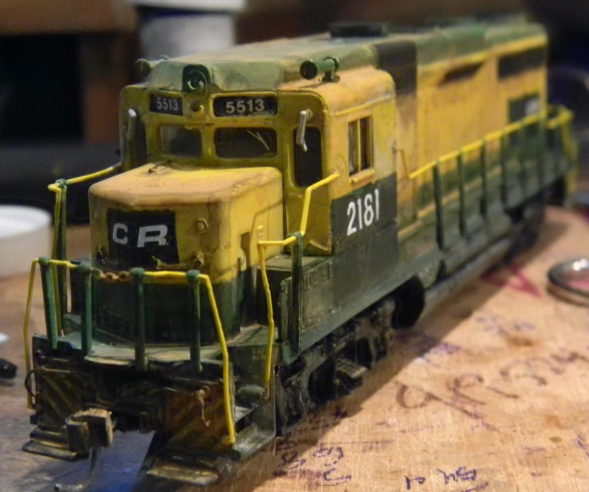

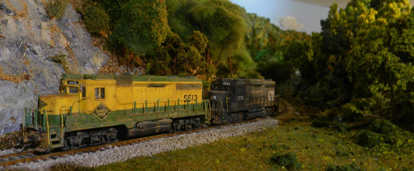

Thanks, Mikey!  Added a little bit more wash to the Reading unit and now I'm moving to patching over the Reading logos and road numbers.  Based on the prototype the green paint used for the patches was a darker green.  Patching pulled some paint off of the cab, so I've been cycling between yellow and green patching.  I'll have to do some readjustment after everything's dry again.  I'm going to try to add the new road numbers sometime this weekend.
Decals have been applied on the front, rear and left side.  I'll wait for things to dry and firm up before laying it over to complete the other side.  Still have to get the road numbers changed on the front and rear.

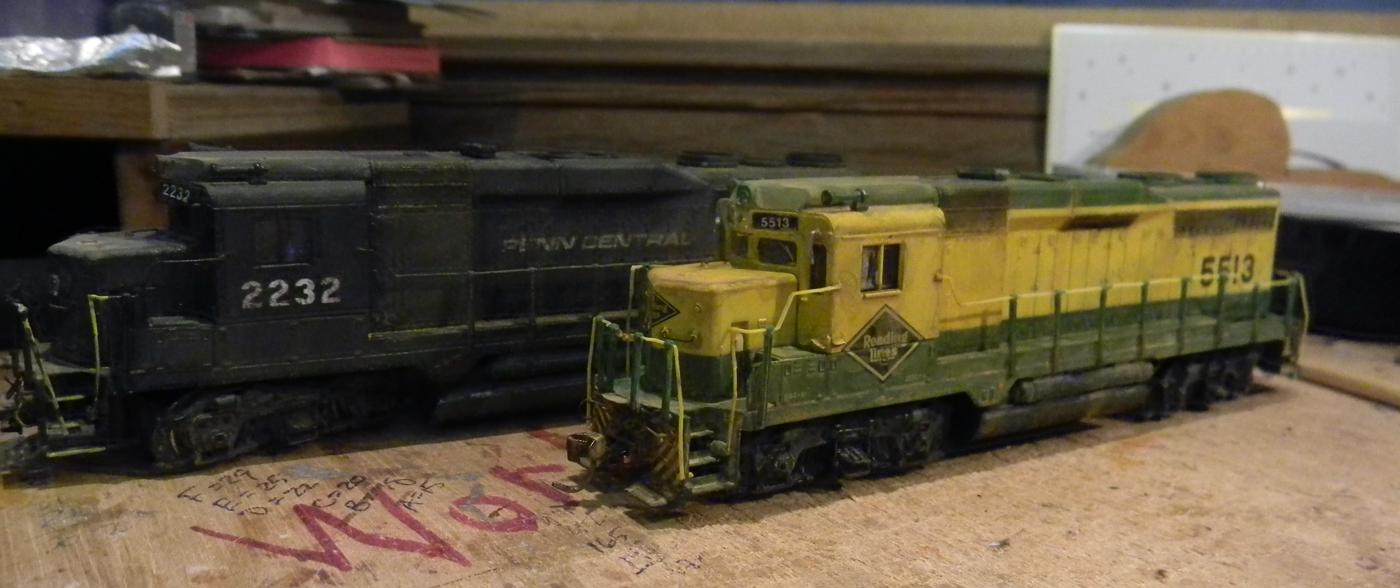

Well, here they are in all of their weather-stained glory.  Another pristine locomotive in my collection no longer looks like it came right off the factory floor.

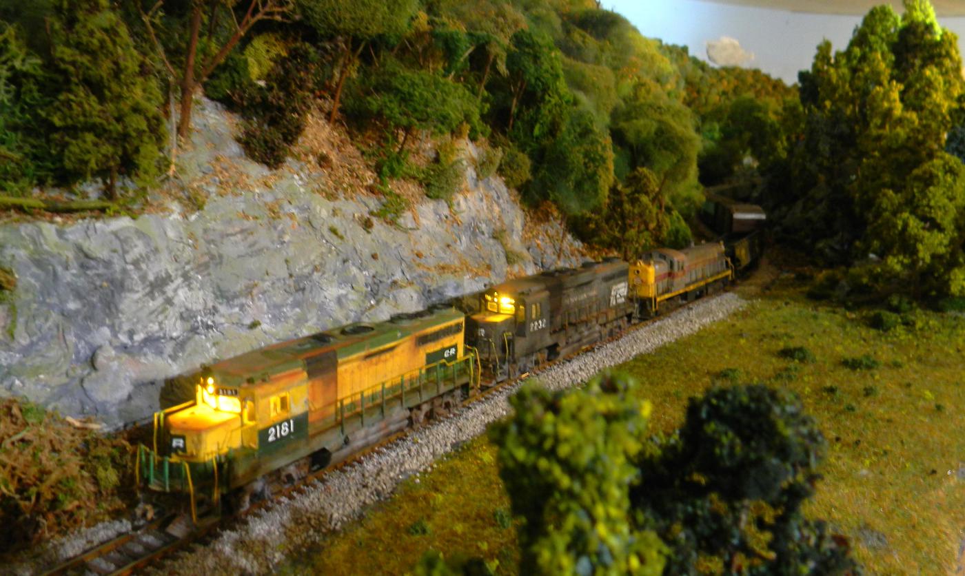

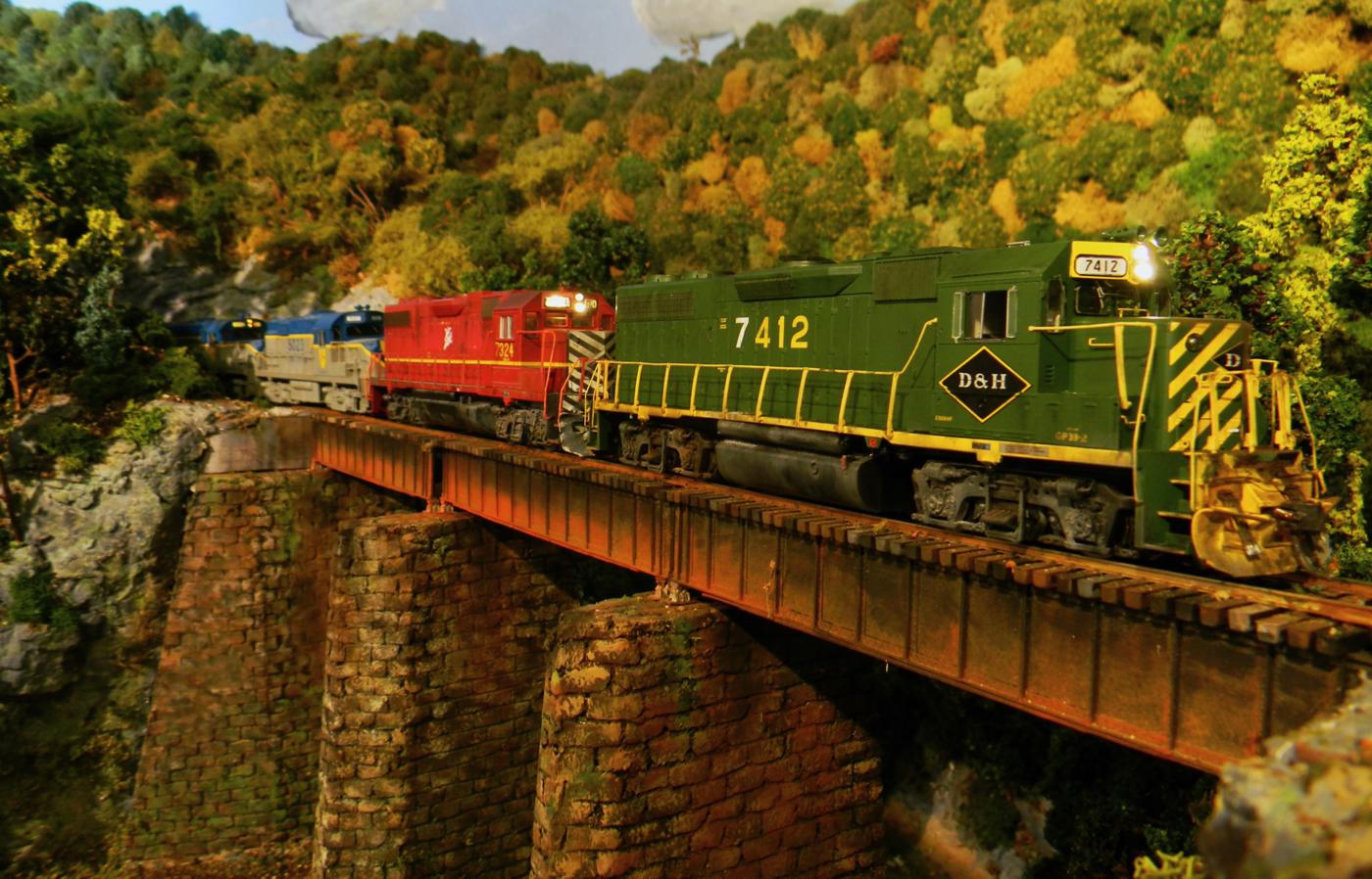

My problematic GP39-2 is now back on the tracks.  Not without considerable hair pulling and expenditure of discretionary spending.  Ditched the Athearn Genesis motherboard and the 21-pin decoder for a DH126D Digitrax decoder and did a full motor replacement.  Put her back together and finished with an application of burnt umber, black and gray PanPastels on the lower portions and put her at the head end of my D&H consist.  She now pulls her own weight and then some.
Beautiful. Great to hear you got her back and earning her keep.
Glad to see you were able to get the loco back where it belongs. Nice job on the weathering.
Thanks, fellas. I still need to weather the rest of my D&H stuff - a task for sometime this winter.
