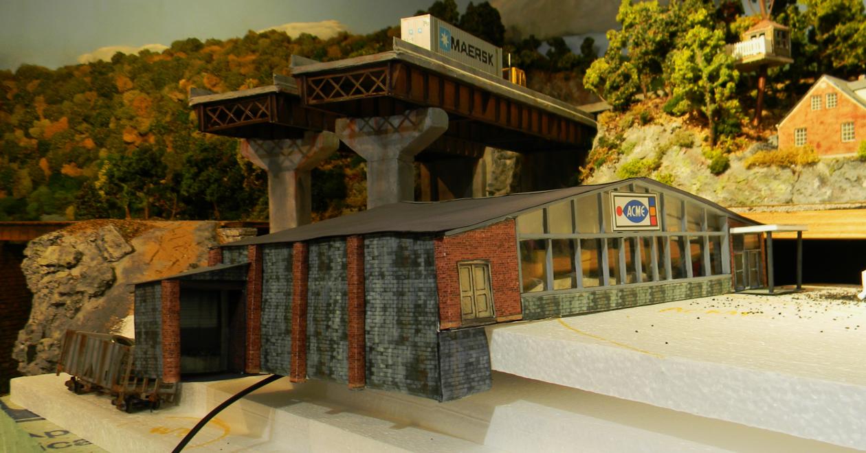

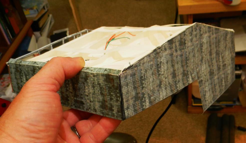

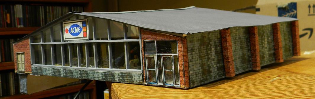

Put the back of the ACME on.  The left side of the building is up against a slope, so I added a "basement story".  Probably not prototypical, but I need to integrate the building into the slope somehow.  Which gives me three very boring sides of the building - just cinderblock walls.

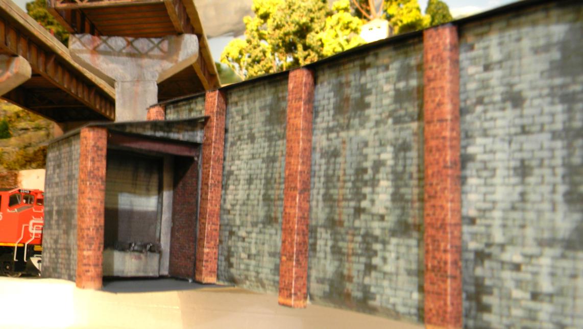

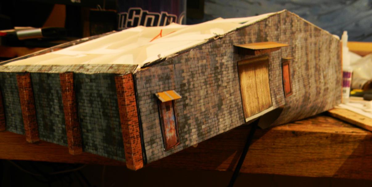

I'm going to try to break up the massive boringness by building cinderblock or brick columns on the two sides of the building where I think steel beams would have been used to support the roof trusses.  Then I'm going to add some doors (personnel and delivery rollups) along the back and put it some shed roofs against the building.  I'm also toying with the idea of creating a basement add-on for a trailer delivery bay near the back of the building on the left side.
First, the columns.  To break up the boringness, I decided to go with brick - plenty of that in previous warehouse building builds, and the frontside corners were already done using portions of the Cream City building B.  I used some extra pages I printed out for that project, cut and folded the brick into columns and glued them right to the cinderblock sides on four equally spaced locations along the walls on each side.
I had flirted with the idea of painting the ACME logo over the cinderblock, but with the columns going in, I don't think I need to do any more embellishment.  Next I'll add the doors and the shed roofs along the back side of the building.  Didn't go overboard on these, because I don't think they will get much visibility.
My last work of the day was to add the roof which certainly makes it look more like a completed building.  The last things to work on with this store are the front porch over the entry doors and the that trailer delivery bay.  Not going to be today....  I'm ACME'd out...

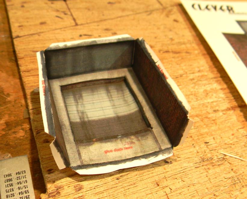

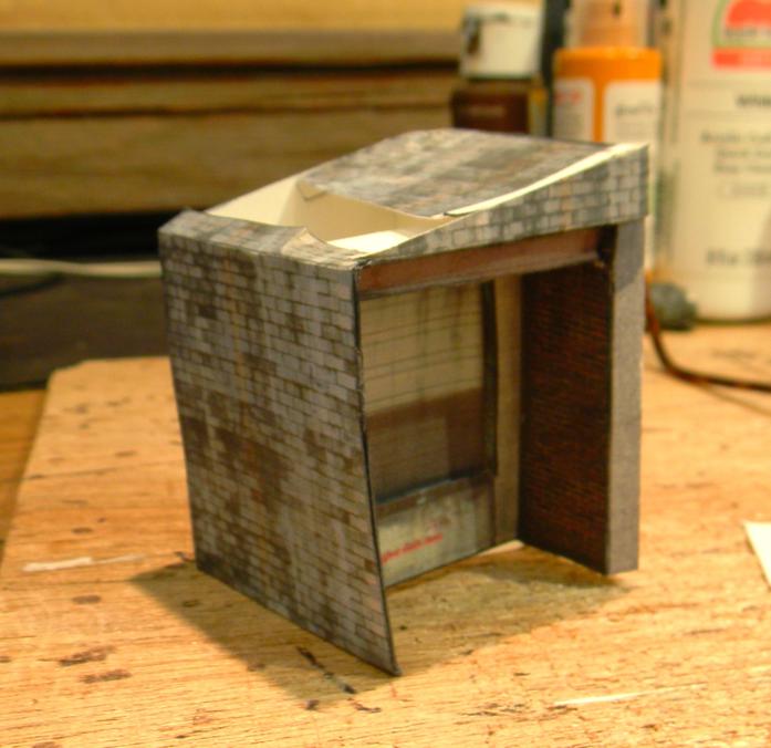

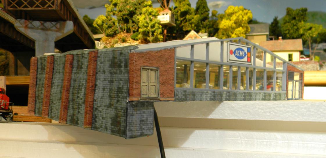

Started with a loading dock out of the Brick Warehouse kit and built a cinder block enclosure around it, fitted it between two of the brick columns against the side of the building.
Next is the porch at the entry and exit doors and I think this project will finally be finished.

Thanks for the encouragement, Hillyard!  I got the front porch done last night and worked out a possible sight for the building...  Here' the approximate location.  I'll have to readjust some styrofoam since the loading dock is resting on air...  Next thing to get back to is the sewage treatment plant aeration bins...

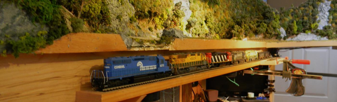

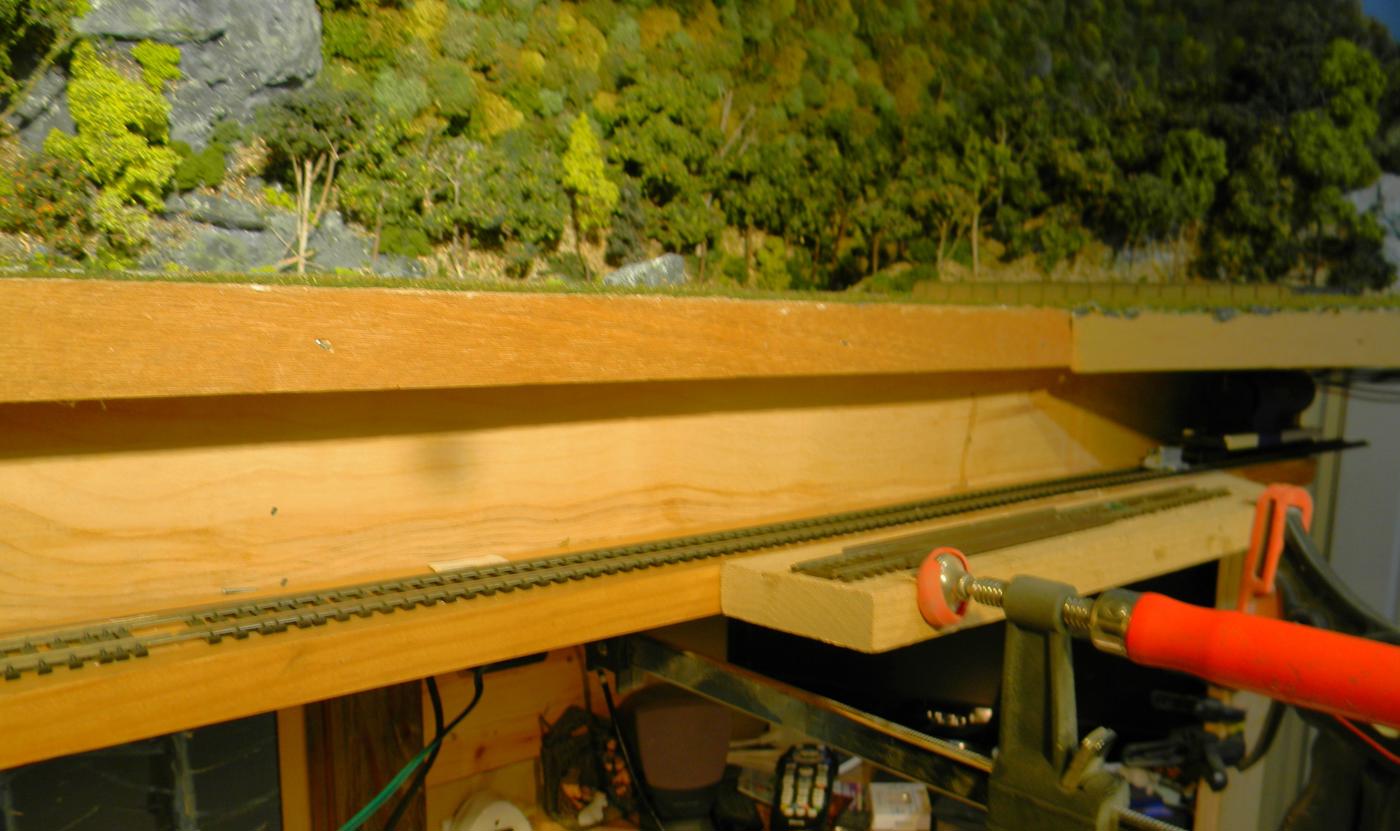

Since I reconfigured the styrofoam base for the front end of White Haven, I ended up moving about 6 locomotives, a flat car, a couple of hoppers and a bunch of miscellaneous parts and pieces that ended up on the styrofoam because it was a convenient flat surface.  Because I moved the styrofoam, the locos and rolling stock ended up amongst the clutter of my desk.  I'm going away on vacation soon and I felt like I needed to clean up.  However, these locomotives and the rolling stock all need some sort of attention and I don't want to put them back on the storage tracks.  What I really need is a "fix it" track...   Got me thinking.
My old DCC system allowed me to program AND run on the programming track - hence it was two full sections of flex track.  New DCC system?  Only programming in a stationary setting on the track.  So, I really don't need a whole lot of space for the programming track, and the old programming track can become my "fix it" track!  I just needed to add a new short section of track for programming.  This also solves the problem of storing a bunch of locomotives on the programming track only to have to remove them if I want to read the CVs on a single loco on that same track...
Got a piece of 1x4 and scabbed it onto the old programming track base with a few biscuits.  The glue is setting up right now...
Rerouted the wired rail joiners from the longer track to the new short programming track and now I have a nice area to hold my stuff to be worked on AND a short programming track complete with a rerailer.  Now to clean up the rest of the mess...
