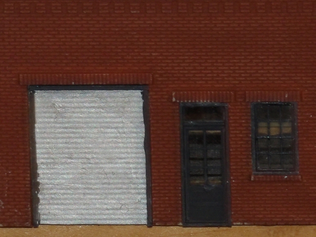

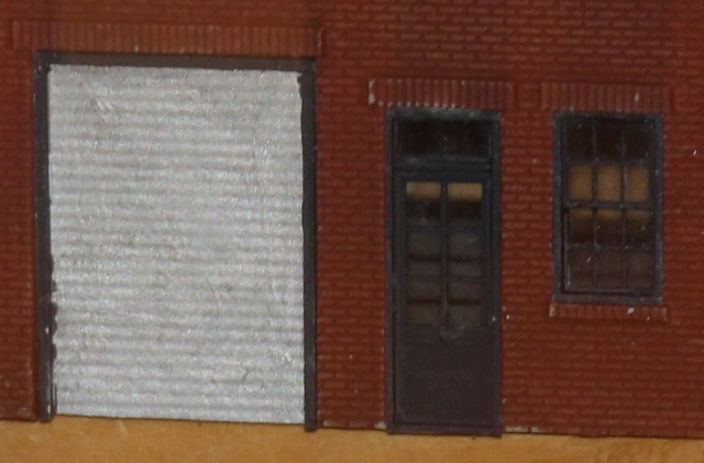

anyone here assembled a DPM series 2 kit , if so were you shocked to find that the separate doors and windows were a scale 12 or 13 inches thick , just cant live with the glazing that far back so i modified some Tichy windows to fit openings but could not find doors that would work so i set doors up in mill and took mullins down to 2 inches, improved looks. ant one else had this problem with the series 2 kits?

will try to assemble a photo show the windows are standard Tichy 8217 6by6 double hung windows that I removed the frame in my chopper.

molded in windows are not a real problem to paint in ho but they still set glazing to far back so i have used mill to thin sides, just doing around windows doesn't affect strength of sides. Jim
