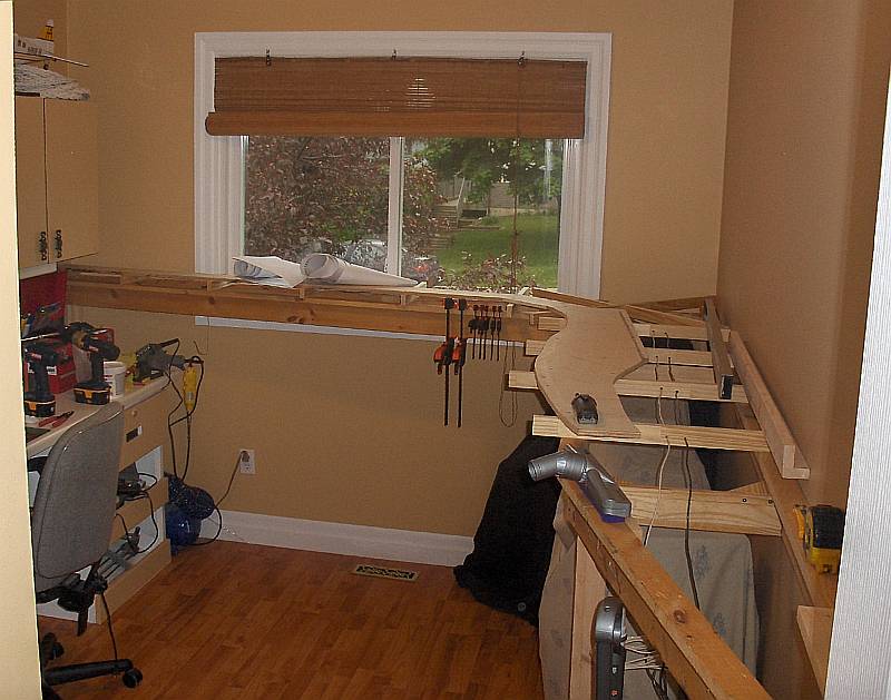

More benchwork and some sub-roadbed down now as well as running 14ga solid bus wires .... one little piece of benchwork to complete behind the door and I can start laying down some cork

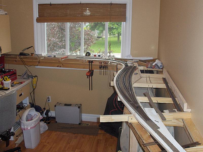

got a few minutes to spend on the layout between hours in the store digitrax seminar and family responsibilities and was able to get down all the lower level cork under the window. If I am lucky... and I kinda feel lucky... I should have all lower level cork in place and some track by the weekend. I will post pics later this week hopefully with some trains on tracks.
Re: Bob_suruncle builds a layout - bob_suruncle - 06-11-2009
more progress..... lower level track is going in. Should be able to run a train the full length tonight or at least by the end of this weekend.
Learned something new today: was laying the curve at the top of the picture and realized I would have a joint mid curve which of course kinked slightly so I cut about 4" of track off of one side of the joint and slid the rail from the other section of flex into the ties that were left empty.... I then installed joiners and while the track was still straight flowed in some solder... no more kink when I laid the curve.
