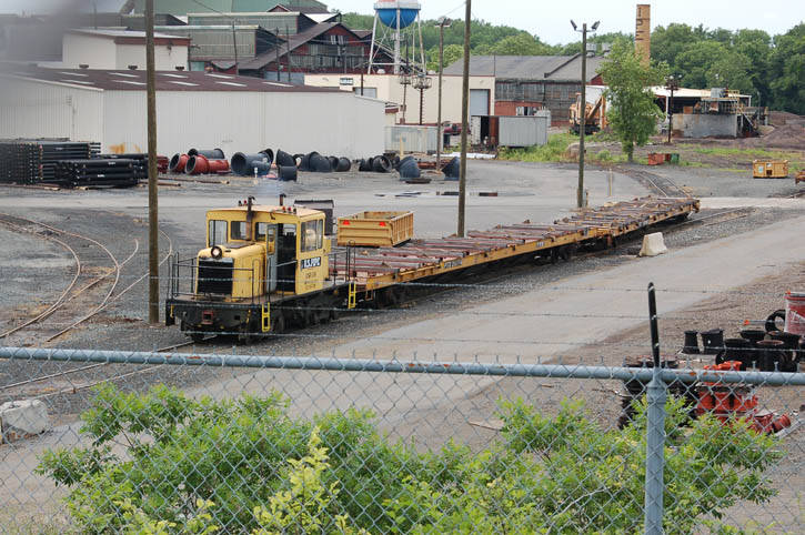

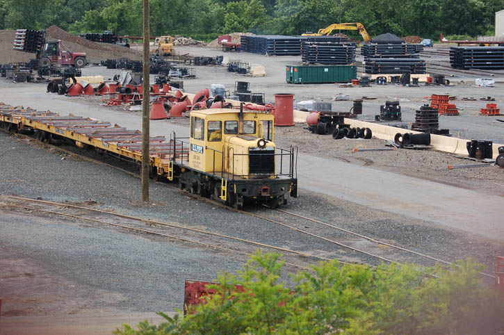

Since you still have an undetermined industry, here's something for your consideration. Granted this has more tracks than what is on your trackplan but just an idea for something other than box or tank cars. US Pipe in Burlington, NJ.

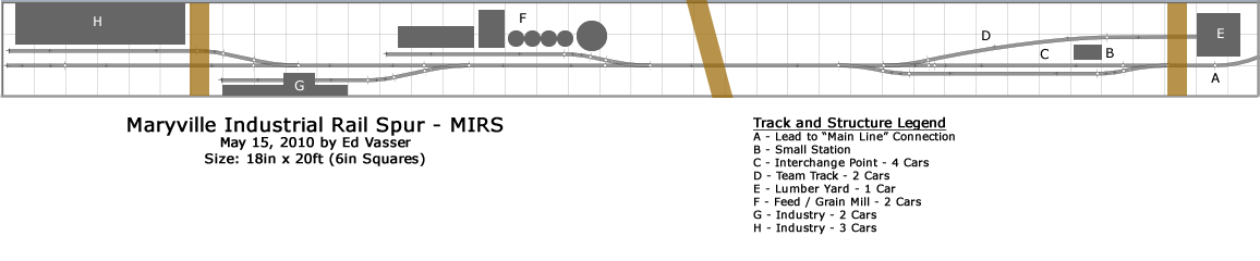

After a lot of test-fitting track sections and managing to get a little more information (very little) about the Lapeer Industrial Railroad - I've reached the conclusion that I just can't model that line the way I'd like to in the available space! Specifically, I just couldn't get the interchange/grain elevator area right! So it was back to the drawing board.
It occurred to me that I could actually have two different switching layouts on the existing benchwork - each one 18 inches deep by 20 feet long - so I came up with this plan for the first one:     This plan (named in honor of "The Boss") is free-lanced, but loosely based on elements of some real operations. For example:
**The interchange arrangement is similar to the Kendallville Terminal Railway, Kendallville, Indiana.
**The left side of the plan is based on industries found on the Shelbyville Industrial Rail Spur, in Shelbyville, Illinois.
The plan has that mid-western flavor that I like and should provide plenty of switching and ample room for scenery.
D - Team Track will receive most anything...
E - Lumber Yard (Walters kit) will receive building products and lumber inside the main structure (we have a lumber yard like that where I live and I used to spot box cars inside the warehouse)...
F - Feed / Grain is your typical mid-west farm supply that ships grain and receives cars of feed and fertilizer, depending on the season...
Industry G - will receive a mixture of tank cars and plastics type covered hoppers (CH's in the shed - tank cars at the end of the track)...
Industry H - is a paper products plant where box cars must be spotted at specific doors...

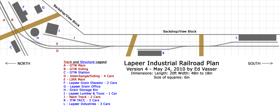

Okay - one more try!
Thanks to Stein's input here's the latest incarnation of my design for modeling the Lapeer Industrial Railroad:
By incorporating a right hand curved turnout that I have on hand and curving the track to the GTW siding, I was able to achieve just a bit more of the prototype look. Another left hand curved turnout would probably work better than using just a standard left hand turn out, but test fitting of this arrangement looks like it will work out just fine.
I included track representing both the GTW Main [A] and Siding [B] and still have plenty of room for the GTW Station [C]. I now have the siding for ITW TACC [K] facing the correct direction and on the the correct side of the "Main" track now. What I'm calling Lapeer Industries [L] is also oriented in the correct direction and on the correct side of the "Main". The real Lapeer Industries is actually located no where near the railroad, but there is a large structure in the location I have on the plan.
Of course I'm still using my "modelers license" by adding the team track [J] and car spot for Lapeer Lumber & Truss [I]. Lapeer Lumber & Truss is actually located where shown on the plan, they just don't have their own track on the prototype, but rather load/unload on the grain elevator track.
Since I can't actually have my LIRR loco go onto the GTW Siding to interchange traffic, on this plan the GTW would set out/pick up interchange traffic toward Siding [D] and clear of the road crossing. This allows the LIRR crew to switch cars from the South end and still have room to get on the North end of any cars destined to Lapeer Industries [L].
Overall, I'm pretty well pleased with the way this is turning out and want to give a big "Thank You" Worship to Stein for his contribution to my plan.
