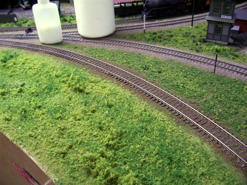

I also get that "tarnished" appearance on the rails when ballasting, and it doesn't seem to be restricted to any one brand of track. Here's a "before" photo of an area where I changed the track lay-out:
[Image: Freightcarphotosandlayoutviews018.jpg]
...and the same area an hour-or-so after re-working it and re-ballasting. Note how yellow the rails are in the re-done area:
[Image: CameraTwopix006.jpg]
The trains were in place only for the photo and were then removed. The track was cleaned the next day, but the discolouration returned, and continued to do so until the entire area had completely dried - it took a few days, as I always like to soak things completely to get a solid bond right down to the base (bare plywood in this area). Once the area was dry, the track was cleaned and has remained clean. Indeed, the only time I have to clean track is after ballasting or installing ground foam nearby, and my suspicion is that the yellowing is attributable to the wet water, as no glue is applied near the track when adding foam - the glue is applied locally with a plastic squeeze bottle, while the pre-wetting is done with a spray bottle, which does allow some overspray.

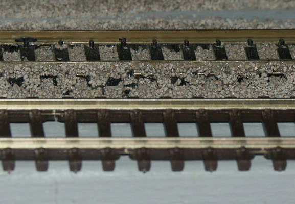

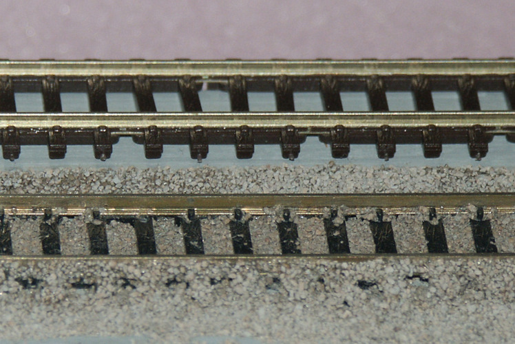

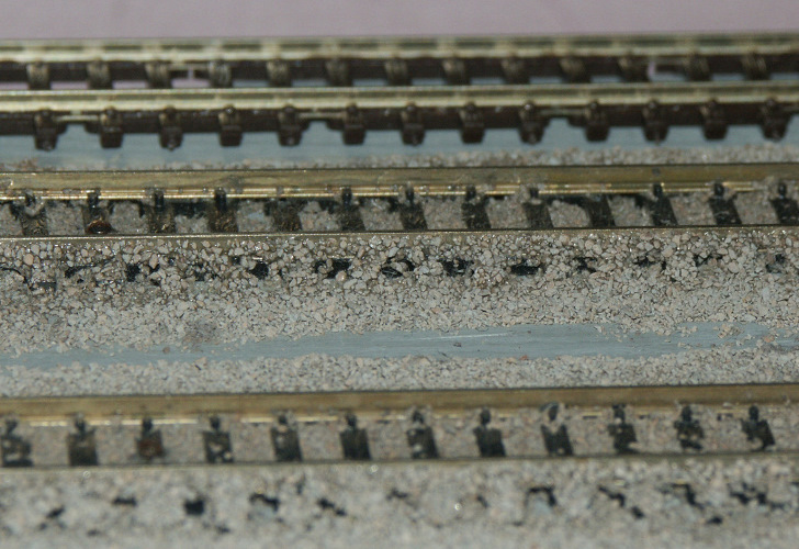

Quote:A product that " turns only the rail rust color ", while gluing the ballast ?? --- Now there's something I would definitely buy !!
Here are pics of the track/rail in question (Atlas code 80) and a section of Peco code 80 behind it.
Granted, the example is 15 years old and I'm sure it has 'tarnished' more since then, but you can get the idea what I'm talking about. The last photo shows it best.
