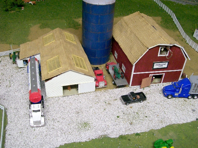

If you can locate a pair of pinking shears, you could cut your own interlocking-style shingles (they're diamond-shaped when applied on a roof), using almost any kind of paper. #800 grit, or finer, wet-dry sandpaper would work, too. Wink
Another alternative that wouldn't be too expensive is Campbell's shingle rolls - if you're working on a wood or cardstock sub-roof, you can use the adhesive backing (wet and stick in place) or, if working on styrene, contact cement works well.
These are all applied over styrene, although none were shot to specifically show the roof:

I haven't had a chance to work on the coalhouse the last couple of days.....but I did determine that I have enough Campbell's corrugated roof panels on hand to do the trestle roof if I so choose. Before I make that decision though, I have to experiment with other materials and see what I like best. Perhaps I'll take some pics of the different options on a small section of the roof and see what you guys think. I don't see me going with a commercial shingle product however because of the expense of doing this much roof. :cry:

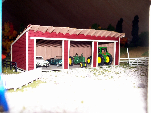

The idea of "exposed" roof joists is a good one. Here's an open bay shed I scratchbuilt for my farm scene, where I added wall studs and roof joists.

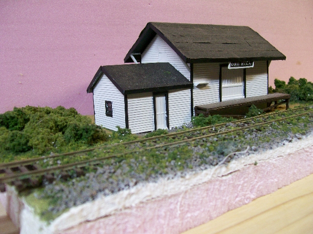

Here's an idea for for a roof covering.
Strips of masking tape spray painted flat black. Simulates rolled tar paper pretty good.
I've used that technique on my Ore Hill Station. After applying the tape, I brush painted "Engine Black" along the seams to make it look like tar had been applied to seal the seams. Small strips, cut at different lengths, made to look like repairs to a leaky roof had been made.
As far as the shingles, if desired, I used Campbell "Self Stick" cedar shingles. These come in a roll and are very economical when covering a roof. One roll did all the roofs you see here and the shed in the first pic.

88...Nice work! Thumbsup  Thumbsup I have used sandpaper for rolled roofing but not painted masking tape. It looks like it works very nicely. Wink Ore Hill station is a keeper!!
