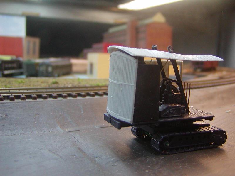

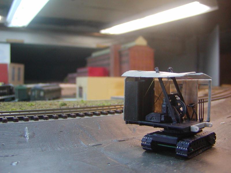

I got this far and disaster struck, I spilled my bottle of Pro Weld and destroyed one of the cab sides and doors, the roof also got hit and warped a bit but otherwise is ok, I think I can save it. You can see the upward curve at the front of the roof in the pics, obviously the roof is not glued in, I now have to wait for replacement parts before I can continue. But I like the kit a lot and am looking forward to seeing it upon completion.
I don't know - straightening this car may be even more difficult than bending it the way you wanted ! Would think the "sway-back" you intended might require heating most of the length of the car to "bendable" state...very touchy for temperature as the folks who use Vac-Form techniques will attest. Maybe just call this "wreck damage" the reason the car was retired to the ground ? The whole area is coming together beautifully, must confess to being a little "green" at your skill and talent. Bob C.

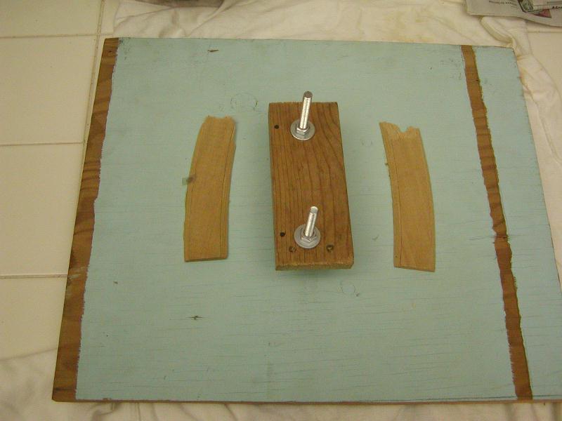

Bob, don't think I didn't consider the Pro Weld! But I figure it is even harder to control than heat. And, I'd wind up with a fingerprint! Steve, I did what you mention only tried to speed things up with a downward pressure in the center, while heating the center. Here is a pic of the jig. The bolsters rested on the two strips of wood, and pressure was evenly applied by turning the nuts on the center bar a bit at a time, while heating the center of the sides alternately. I tried directing the heat at the bottom of the car because I knew the cherestory would deform easily. But as Bob points out, application of the heat is tricky!

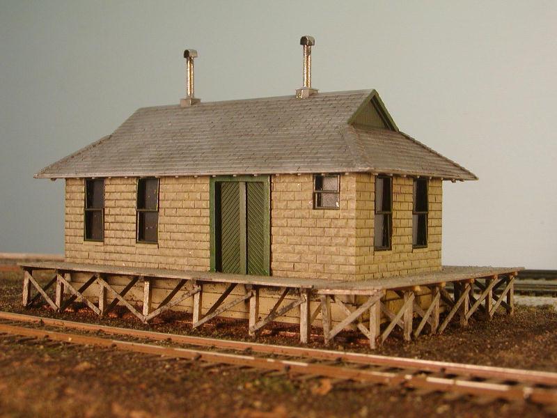

While I was waiting for my spare parts from Jordan (which arrived prmptly) I decided to build a station kit I had on hand, by Stella Models. I wrote a review of the kit in the review section if you would like to check it out. Here are a couple finished pics:
A quick note, I scatchbuilt the platforms and loading dock door as the kit was more of a yard office and I needed a freight station.

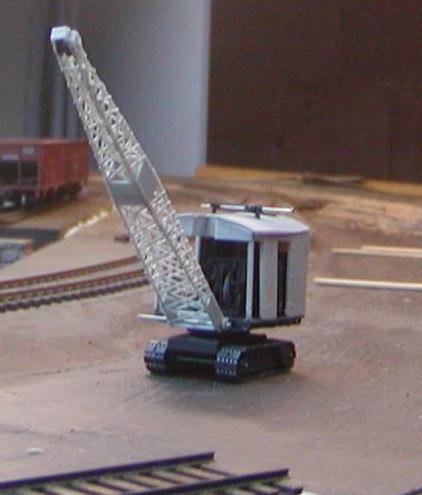

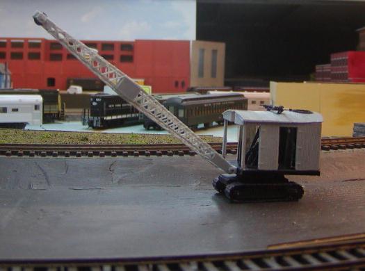

A quick update on the Jordan steam crane build. I received replacement parts for the ones I damaged, and the kit is almost complete and ready for paint. I have to install the doors and rigging, and a few details. Unfortunately, one of thise details went flying when I removed it from the sprue. A quick search has not turned up the little critter, so I'll vacuum with some stocking in the hose and sort thru what gets sucked up, hoping to come across it. If not, I'll have to write Jordan again! Here's how it's looking so far:
