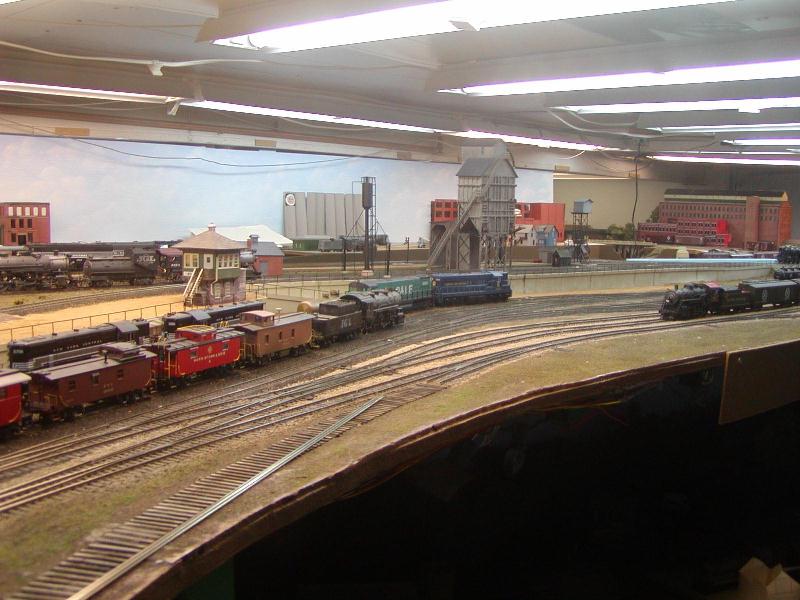

Gary, that room in your photo must be pretty narrow. I took the pic below of my layout. The scene is 9' across. The backdrop on the left is an exterior wall and full height. The wall on the right is around the lolly columns and also full height. I get no sense of claustrophobia here. but in your photo I would! According to your drawing of your space, you should have a similar space, so I wouldn't worry about height making your space seem too tight. Air flow may be another issue, but I imagine only a couple inches would suffice. There won't be a wall beneath the roadbed, correct?
Note on the backdrop wall on the right I didn't run it to the end, instead I left it open so I had a very deep scene when viewed from the other side of the room. Your situation allows a similar opportunity.
This pic is the next aisle over, so the backdrop on the left is common to the one on the right in the previous photo. Note there is no backdrop on the peninsula to the right, another option if you consider what you may achieve with it. I think there is no right or wrong here. If suitable for your scheme of things, a long row of industrial bldgs down the center could have different "fronts" (or backs) on either side, and could be high enough so you don't see over them.
Finally, this photo show the view from the last aisle, from the other side of the peninsula with no backdrop. You see across the aisle and the concrete silos across the aisle could be just across a river.
Most of the fun in this hobby for me is the planning, so don't rush into it and don't hold any given idea too tightly.

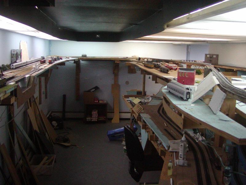

Here are 2 photos of what I did this morning, with a mock-up of the layout height. So what do you think? Layout height is at 58 inches and the top pf the wall is at 78 inches, ceiling is 96".
[Image: image.php?album_id=126&image_id=1912]
[Image: image.php?album_id=126&image_id=1913]
Of course, the exterior walls will all be full height backdrops. Now, for the center wall... It is essentially divided in three sections between posts. If you look in the first picutre, you can see a post which is in the wall at the back. The center wall will be coming from there, connecting up to the framing/post in the pic. How about I make that section full height, but leave the mock-up section as is? Comments welcomed!
Someone brought up another point... I had it in my head that the center wall would be sheetrocked both above and below the layout. What about not sheetrocking it underneath? Advantages, disadvantages anyone?

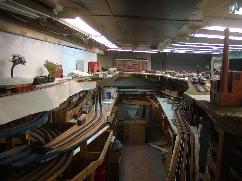

I wonder what kind of shadows your lights will make shining through from the opposite side of the peninsula? There may be none or few, since lighting on both sides of the peninsula will be similar, but one thing to avoid, if at all possible, is backlighting your scenes. Because fluorescent lighting is so "flat" (not casting distinct shadows), some detail is naturally "lost" when viewing. Backlighting will exacerbate this situation, and may cause further difficulties for photography, too.
As for finishing the walls beneath the layout, one thing to consider is the use of that below-layout space. I boarded all of my layout room floor-to-ceiling, but finished (taped and mudded) only the area which shows above the benchwork. If the layout comes out, I'll have to finish those areas, but since removing the layout will also require un-coving and re-boarding the corners and filling all of the holes where the bolts securing the layout to the walls were located, it won't be that much extra work.
Much of my below-layout space is occupied by heavy-duty shelves (3/8" plywood on 2"x4" framing, 16"o/c) and used for storing all sorts of stuff, including tools, toys, furniture, miscellaneous household goods, along with building supplies and train stuff. I intend to eventually cover these areas with sliding Masonite doors, but, in the meantime, sheets of cardboard suffice.
[Image: Layoutroomphotos002.jpg]
[Image: Layoutroomphotos010.jpg]
[Image: Layoutroomphotos006.jpg]
If you're going to have lots of layout wiring beneath that requires access, you probably won't want to block that: mine has only two such areas, one where the power pack and track connection is located, and another where I have an access hatch.
Another consideration, and not just on the peninsula wall, is electrical outlets. I have several of them throughout the layout room, all currently located on the wall under the layout. Only one, near the power pack is readily accessible (which explains why there's an extension cord visible on the floor in many of my layout room pictures). The original plan (approved by the electrical inspector) is to locate new receptacles below the layout facia, fastened to the face of the top member supporting the benchwork, as shown below.
[Image: CopyofLayoutroomphotos008.jpg]
Since all of the receptacles are currently mounted on the face of the wall, it's a simple matter to put a blank cover on them, then run BX cable to the new boxes. That way, they'll be readily accessible but not on the layout facia, where someone might accidentally insert foreign objects into them.

Based on the second image, with you (I presume...) next to the mock-up, it looks about right. It would only be in imagery where you have the camera low and taking an image down the major axis of the benchwork, or turned maybe 15 deg from the major axis, that the sky backdrop would be tough to crop. Photo shop takes care of that problem, and from the visual/operational standpoint, you look to be able to get good use of the height you show.
-Crandell
