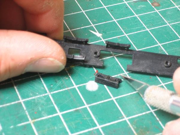

In order to help hide the worm gear I cut up a plastic suspension detail part. I have no idea where it came from. None of my prototype pics show them, but, I'm sure that they were there.
Here is one set installed. I'll do the other side tomorrow.

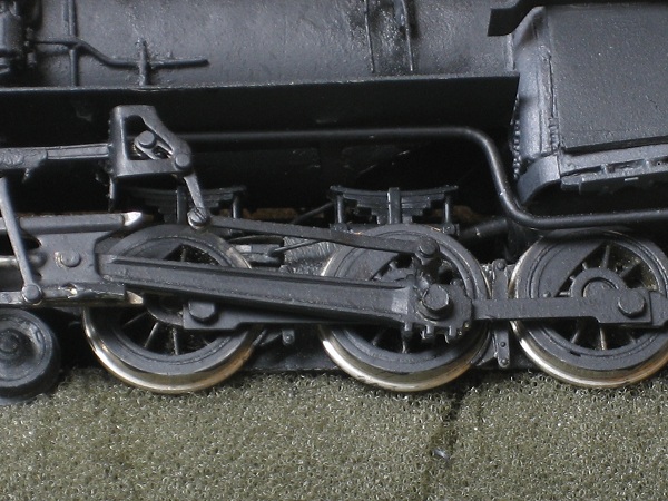

e-paw Wrote:[ATTACHMENT NOT FOUND]While I was painting I realised that I forgot a pipe an the fireman's side. I don't know it's purpose, but the prototype pics show it running from under the boiler (starting at the valve gear hanger) and going back the the rear of the engine disappearing at the end of the fire box. I bent some rod, painted it , and glued it in place.[ATTACHMENT NOT FOUND]
With the pipe in place I took this shot. It gives you a better look at the flywheel mounted on the back of the motor.[ATTACHMENT NOT FOUND]
That pipe is probably the water feed, from the tender to the "Fireman's" injector. I would suspect that there was a waterglass on both sides of the boiler so engineer and fireman could keep an eye on water levels. Those camelbacks had to be a real pain to operate safely.......and not a lot of fun for the fireman

Quote:That pipe is probably the water feed, from the tender to the "Fireman's" injector.
It might be, I don't know if there was a sight glass in the brakeman's cab. The fireman had one on the rear platform. As you can see it's a hefty pipe that's unlagged.
In this photo it definitely is a tender feed. It is run a little differently on this engine than on #454. <!-- m --><a class="postlink" href="http://www.northeast.railfan.net/images/cnj434s.jpg">http://www.northeast.railfan.net/images/cnj434s.jpg</a><!-- m -->

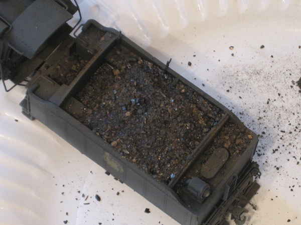

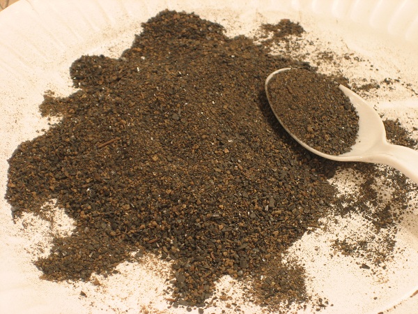

Lets make some Clum OK , today I wanted to get started on the coal load. By the mid 40's , the time that I model, these CNJ camelbacks were getting pushed aside by the new fangled diesels.The Baldwin built RS-12's and Dr4-4-1500 Baby face units had taken over most of K-1's assignments. If it hadn't been for the war time boost in traffic the 4-8-0's would have fond themselves on the dead line at Elizabeth port. At this time the CNJ stopped using straight Anthracite or an anthracite/soft coal mix in favor of what is called Clum. Clum is an unwashed or screened form of anthracite, it's pretty much is straight from the mine. The larger pieces of coal would be removed and the rest ( containing rock and dirt ) was sent right into the firebox. sort of a "run of mine" stile of coal that was a cost saving fuel that some how burned without a loss in steam pressure. Just another testament to the Wooten fire box.
In order to make this I started with some dirt, dug up, screened, cooked, and cleared with a magnet. That was then mixed with some fine " Blue Coal " anthracite from the Hubber Breaker in Ashley P.A.( a CNJ served Breaker ![Thumbsup Thumbsup](https://bigbluetrains.com/images/smilies/extra/thumbsup.gif) ).
I also mixed in some Fine coal from the St. Nicholas breaker in Mahanoy City P.A. This is the more common "black" shinny anthracite.It is darker than it came out in this shot, my kitchen lighting is far from the best for photography, but you get the idea of what I'm trying for.

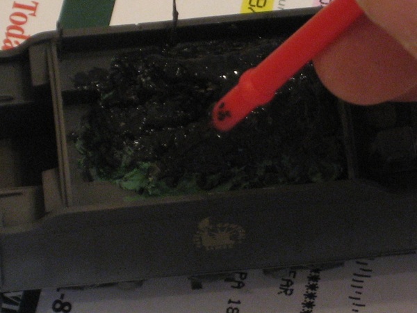

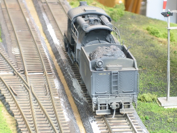

While the airbrushing hardens up I put in the coal load. I added some Squadron putty to the foam block that I gave a rough shape to years ago, ![Thumbsup Thumbsup](https://bigbluetrains.com/images/smilies/extra/thumbsup.gif) just to touch up the edges ![Thumbsup Thumbsup](https://bigbluetrains.com/images/smilies/extra/thumbsup.gif) . This was given a coat of cheap craft paint, Black of course.
While it was still wet I sprinkled on my coal mix and covered it with a thin mix of white glue and water with a drop of dish detergent in it to break the surface tension. Another coat of the coal mix was added on top of that. When it all dries I'll simply flip it over to remove all the loose coal.

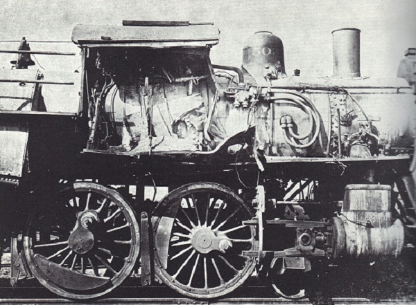

Toptrain sent me some pics of camel backs that had broken side rods or bearings to show the dangers of the center cab location. Luckily this was a very rare problem.
First off is an D&H loco that had the entire engineers side of the cab torn open when the running gear gave out at speed.
Here is the CNJ camel that I was talking about earlier. She was on lone to the Reading at the time of the accident.
Although the CNJ Atlantic fared better, I would have to say that it is unlikely that the engineer survived in either case.

One can only imaging the resulting violence when a rod comes off an 86" or a 92" driver at 80 or 85mph! I can remember standing next to Reading Atlantic one day as I stood on the platform at the Logan station, where I often stopped for a little train watching on my walk home after a day of fifth grade classes at Logan Demonstration School in North Philadelphia. I can remember looking up at those wheels and thinking, "Boy ... those wheels are VERY tall!" At the time I think I was barely much taller than the axle centerline!
Those tall wheels made the Reading's "P" Class locomotives real speedsters. At one point in the 1890's, the fastest scheduled train in the world was pulled by a Reading "P" Class Atlantic from Philadelphia to Atlantic City ... in 55 minutes! You can't drive that trip today, driving straight through, down the Atlantic City Expressway with a 70 mph speed limit, in under an hour and fifteen minutes ... and the train made station stops!
But along with the great speed came the danger of the occasional results of the turmoil and destruction pictured above.
