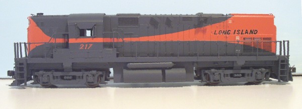

If you can find dry transfers with the right font, and sizes:::: Prime the car with the letter color, apply the dry transfers, shoot the carbody color, and use masking tape to remove the dry transfer lettering.
What's left is the lettering....in the color you wanted in the first place.
The numbers on this loco were done that way:

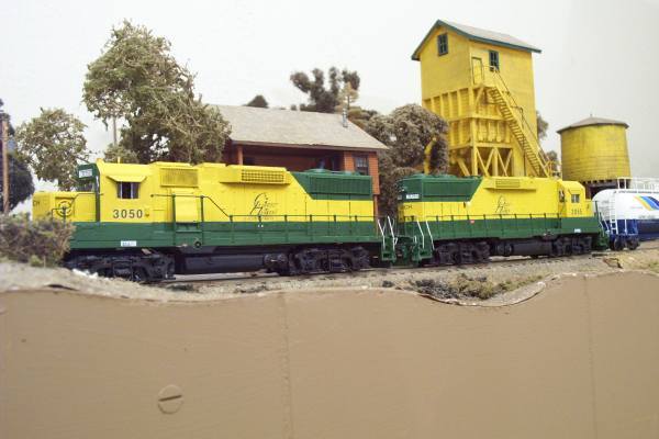

P5se Camelback Wrote:There is a possibility that he may enlarge the artwork to HO scale and either have another fellow on that forum produce them or possibly send the artwork to me and I would then contract with Rail Graphics to produce a small run of both white and yellow sheets. We'll just have to see what he wants to do ... it's his artwork.
Unless things have changed, Rail Graphics wants sharp Black on White artwork at 2X decal size. If you send a color sample they might be able to match it. They did my Cindys Harbor ( modern ) decals in Green and Yellow, that I used on these BL20-2's.
