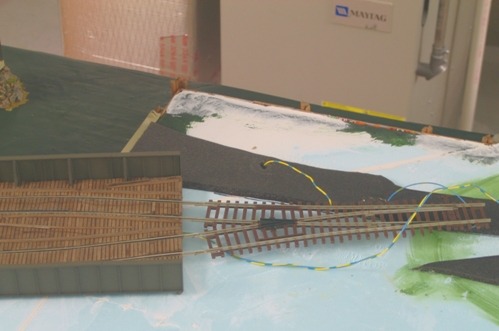

I cut in the switch today, soldered on the leads, and drilled the holes to pass the wire under the layout. Soon I can mount it permanently. I have to pour the water first.

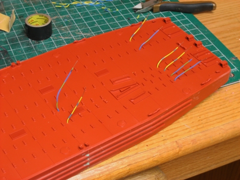

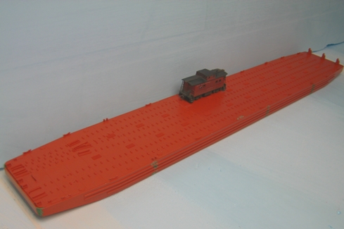

Afterwords I started on the car float barge. So far The only "kitbashing" that I did was to shorten the barge 34 scale feet.I did this in 2 cuts to keep the same pattern it the deck hatches. You can see the 2 removed sections in the background of this pic.
The working section of decking was left so I can wire the track. They supply you with plastic rail, but I will swap it out for code 83 NS track and add pickups on the lock downs to match the apron.
Even though I shortened the barge you car still see It's a large model.

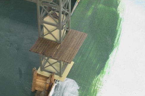

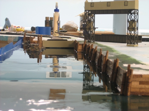

I got back from the LHS and made the first pour on the Susquehanna river. It's the first time I used this product and I'm very happy with it.

Wow! The water looks GREAT!

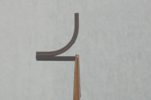

I started on the lights that will hang out over the apron.
I started by cutting off the cone shaped end from the sand hoppers that I eliminated from the coaling bridge (see new project),this will become the reflector of the light fixture. I then drilled them out and installed a grain of wheat bulb in to them.
As you can see in the pic I used Testors glue for clear plastic for this.
next I glued up some left over angle iron from my water bridge (also see new project) to make the supports for the fixtures. I will paint and install them soon.

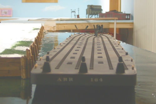

I painted lettered, and weathered the car float. I just have to hit the LHS for some more code 83 rail.
