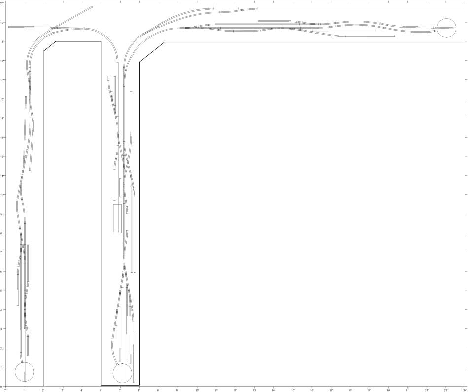

Here is the latest reincarnation. I need to do some more tweaking, this is just a general idea. I now have a 3 track class yard and a 2 track storage yard on the island. How's this look?
Loren
#33
I like it. The drawing shows some tracks where the peninsula comes off the "L" short cutting off the table. You can easily add a couple of triangular sections between the peninsula and the "L" on each side of the peninsula. By the way, how far is Elk Plain from Spanaway(spelling?), Wa. My friend Galen (Ocalicreek) is moving from Kelso to Spanaway.
#34
I like this one as well. It took me a few minutes to notice that you had extended the peninsula. The wye off the peninsula was a good addition, though it looks like the base turnout for the left leg might be squeezed pretty tight. I'd be tempted to add another turnout to the base of the right leg, shortcutting the current turnout by a couple of feet, and to add a turnout between the second and third tracks of the peninsula (from the right), to shorten the peninsula end of the wye. This would give you a more compact turning option at the peninsula base, would create a short run-around / interchange at the right leg base. You might even be able to do without the peninsula turntable.
Although I have to admit I like the rambling nature of the wye as you have it - it disguises that purpose.
<edit - corrected second to last sentence in first paragraph to read right leg instead of left leg.>
Matt Goodman
Columbus, Ohio

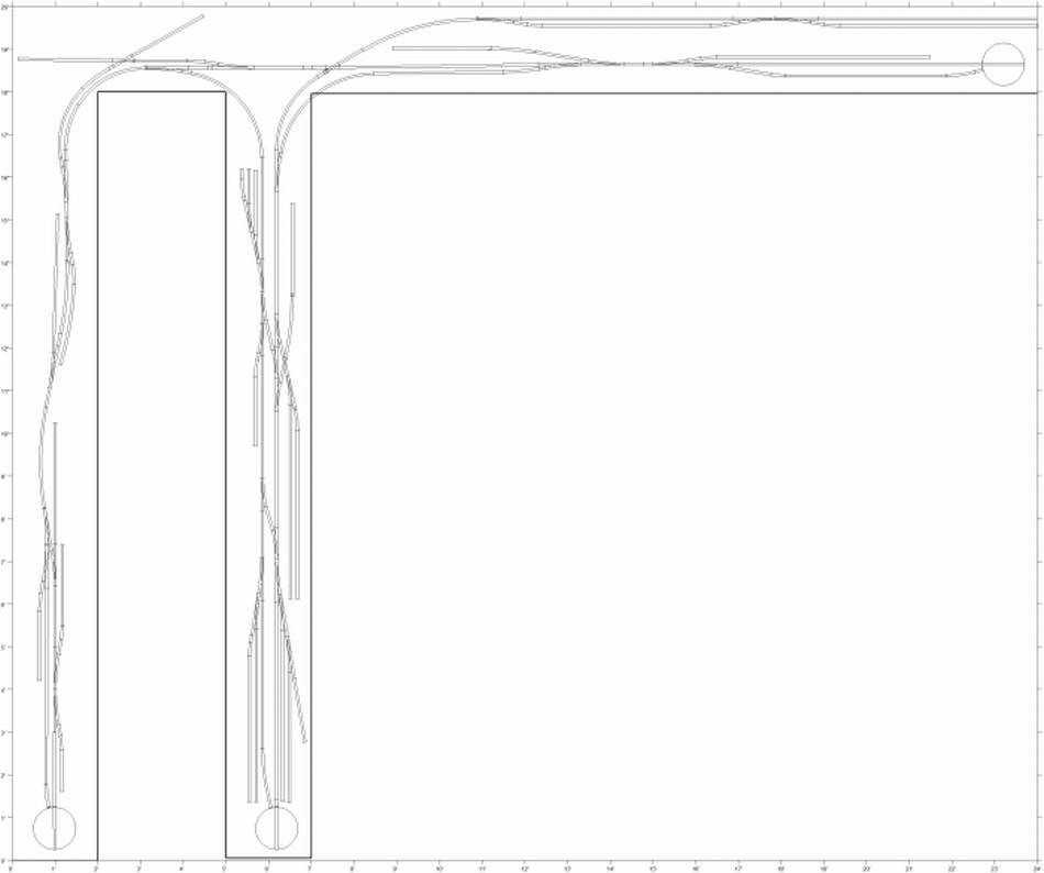

Wow ! Thank you guys !
But, I am seriously thinking about taking off the straight section of the wye to simplify wiring. Since my last post I have done that and added caboose storage and run around tracks at the interchange, the island and the two industrial areas. I am also working on the yard. I am going to try and the have the two main line tracks going through the island narrow into one track going into one yard.
Loren
#36
Presenting the new Nomad Valley R.R. !
The class yard and storage yard are now combined on one track. The east and west industrial areas are now completely separated.
There are caboose set out and run around tracks at each area. Each turntable also functions as a run around when a train pulls in. All turnouts are # 6, except the island which is all ready built. Fluesheet mentioned the curve going into the west area. It is 22" radius and I will have nothing bigger then 0-6-0 tanker or 4 axle diesels and 40' cars so that should not be a problem.
And I promise to take pictures.
Thank you for all your help Russ. This is going to be a great railroad !
Loren
#37
Hey Loren. That looks really cool.
I probably missed it, but what is the purpose of the crossing in the upper left corner? I had an idea, not sure if you'll like it, however the stub that goes to the right says to me, "hidden staging" underneath the layout. You've got 19' feet to work with before you reach the far end if I counted correctly? Possibly the stub to the left as well too, if you wanted to add a bit of a curve to it?
Just thinking out loud. :?
#38
Hi Tetters.
The crossing will be my biggest industry/shipper ( maybe Gern Smile ). The siding on the left will be receiving and the siding on the right will be shipping. I really have no plans on putting in staging. I have so much going on now for a solo operator I don't think I would ever use it.
Loren
#39
The latest plan looks good, Loren. The only problem I see is that you have no convenient way to get from the interchange track to the turn table to turn the locomotive. I think an easy fix would be to run a spur off of the run around track either to the turn table or tied into that stub siding near the run around track.
#40
nomad Wrote:Hi Tetters.
Loren
Understood. Man that one big sucker you've got planned there! :mrgreen:
#41

Thanks for seeing that Russ. Another great idea !
Tetters and Cando, Thanks. That sucker is big and I'm sure I will never get bored Big Grin
