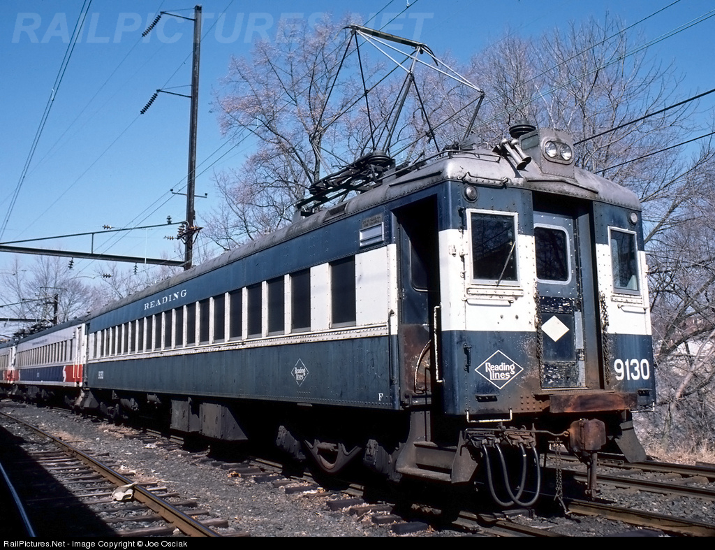

#9130 is representative of the average Blueliner. The only exterior differences are the new headlights, removal of the original roof vents, replaced by small corner vents, and the new paint job. The blueliners originally retained their rooftop bus connectors, though they are removed here.
