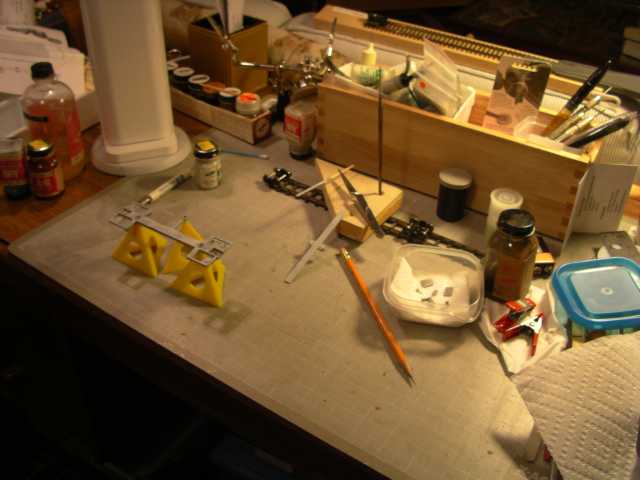

Decades ago Walthers marketed (in their Tongue-in-Cheek line) a "Beer Can Tank Car" (you supply the can). Around that time, I scrounged a genuine CP Rail drinking water can (Lethbridge Viaduct, in a caboose, during the NMRA convention). Later I picked up the Walthers kit at a show. Now I've dug it out for use.
The parts displayed, plus some extra bits needed.

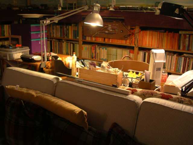

Seen from the main part of the room

Some progress made. Metal parts painted and the steps and air brake parts (2!) installed in the wrong place.

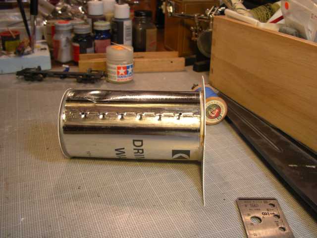

I have a problem: the can is bigger than the car was designed for; longer and bigger diameter plus a seam at the ends. I need to cut some round plastic to fill the ends. Does anyone know who makes or stocks a compass with a blade? I don't seem to be able to cut a circle with an Xacto knife.

<!-- m --><a class="postlink" href="http://www.micromark.com/CIRCLE-CUTTER-and-COMPASS-16-MAX-DIA,8067.html">http://www.micromark.com/CIRCLE-CUTTER- ... ,8067.html</a><!-- m -->
Micro Mark's compass circle cutter seems a bit large, (and a bit pricey if you're only going to use it once) but perhaps you can use a school compass in the same way. I seem to recall a compass designed to clip any pencil in place. You could probably just as easily clip-on an Xacto or other hobby knife instead.
But try this first. Draw the circle as big as you need it to be. Then put the blade of your knife on the line and carefully spin the styrene. Don't try to make the cut in the first pass, but go as deep as you need in order to snap it out.
OR, cut a square the width/length of the diameter you need plus some slop. Draw the circle inside. Then nibble away at the corners to get an octagon, then nibble away at those corners, etc. until you approach the circle. Use an emery board or sander stick to rough it down to a circle.
My 2 cents.

I did the ends by gluing the plastic sheet on with Goo and cutting around with the X-Acto knife. I need to get some silver to paint it with.
