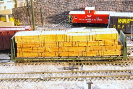

One of my projects is to make some loads for my gons and bulkhead flatcars.
I was wondering what you guys use for banding?

A long time ago, I read about taking two X-Acto #11 blades, taping them together, and using them to cut thin strips out of black plastic garbage bags. This is one result:
But black Chartpak tape is probably a better choice.

Maybe 1/32 or whatever the equivalent is.

You can also get black peel and stick pinstriping tape at an auto parts house. They usually start at 1/8 to 3/16ths inch.

Way back before computer drafting, Chartpak and a few others made tape for printed circuit board layout. There might be a bit of that at some drafting supply stores, but what I've got is probably at least 15 years old. Some of what I still have is as thin as .015", or about 1/32". That scales out to about 2.4" in N scale. I've got other sizes as well, .020, .031 and up. For N scale, I'd be just as inclined to use black or brown thread or cord to look like wire banding.
BTW, I've taken some of this tape, painted it white or yellow and used it as road striping.

How about using black decal stripes, or simply painting some clear decal paper black, then cutting out what you need using a straightedge and sharp blade?

Brakie Wrote:Don,I should have mention the cars are HO..I won't even attempt adding banding in N not with the limited use of my right hand. What prototypical width would the banding be? I may have an extra roll of something you could use. .031 would be about 2.7" in HO, .040 comes in around 3.5".
