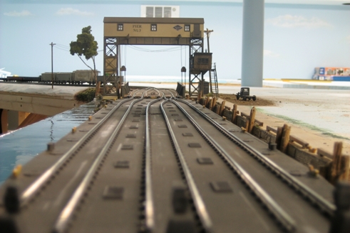

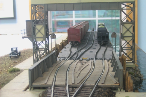

This will be coming to a close very soon. Just a few more things. But here is a few pics of what I've added.
As you can see I added some storm drains from brass tubing and Woodland Scenics water effects, and a few fishermen.
I also placed a crewman on the operators platform.

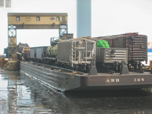

Here is a view of the apron in place with the float in dock.
Posts: 2,724
Threads: 160
Here just one more. A view of the operation from the port side looking at the river. (and the back yard)

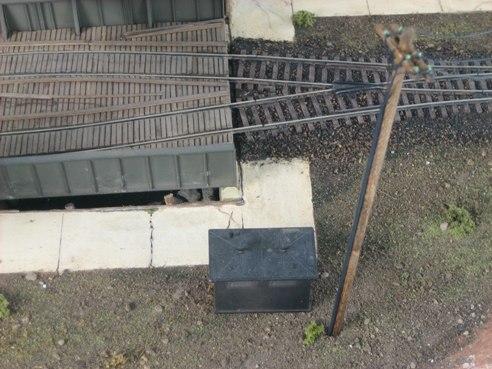

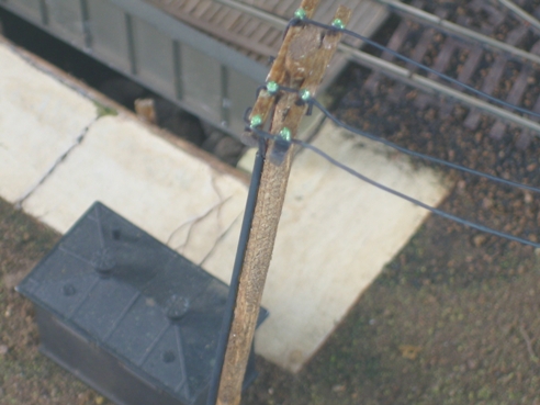

I 'am working on some utility poles to bring power to the apron.
They are made from some 1/4 inch dowels cut to a scale 50 feet. They were distressed and notched for the cross arm, then stained the same as the sea wall. The cross arms are from strip wood, and there supports are cut from thin brass. The insulators are the heads of some sewing pins with a drop of glitter glue on them, one or two need a second cote. I think I'll use real wire for the conductors. some phone wire with the insulation striped off should be the right size.
Posts: 2,724
Threads: 160

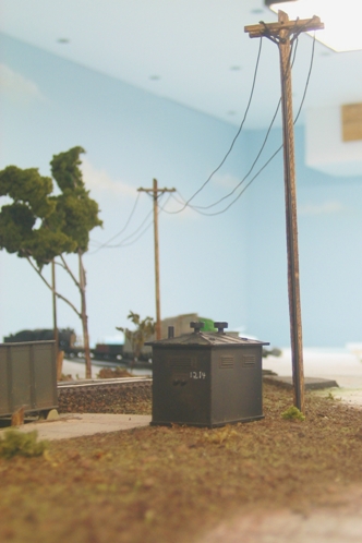

This project has also come to an end. The last step was to add some power lines and a chimney to the apron. This is the last pole where the power lines end and go down a conduite and underground into a utility cabinet.
From there they run off into the distance and off the edge of the layout.
