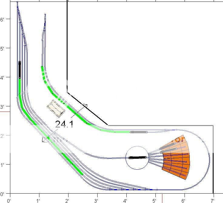

[Image: concept14.jpg]
Heres the mod with Trainnuts advice.
I like it, the yard is more useable, but is still poorly designed.
[Image: yard.jpg]
I just see operational issues with this yard....
My average train will take up 4 of those longer sectional pieces (Kato's 248mm straight) without power. That's only 4 passenger cars. And so far, this yard would not be very accommodating of this train... if you were turning the train using the wye in the yard anyways... So I've decided I just have no idea how to design a good yard. Smile The largest loco I have (Challenger) will take up 1 of those 248mm straight sections
However, this new yard does allow me for a much larger roundhouse. Misngth which will make a few of you bang your heads... but at the same time it will allow me to display my motive power and give me some more fun. And hey... it fits!
So far this is my favorite design... I just wish I could get the yard into something I could be happy with....
I also put a reverse track in up at the north. The part of the track that's covered by the pale brown line means that it's traveling through a tunnel.

#53
Now see there you go. While I was trying to sketch up something to illustrate my thoughts, you went and designed a whole nuther railroad! Icon_lol I guess I'll still post what I was thinking but I think your more on the right track now.
Somewhere out there, there's a site on how to design a proper yard with all the correct pieces. Somebody turned me onto it back at the Z place and I can't remember where it was at now.
Anyways, let me digest your latest plan and here's what I was thinking... though, I think your already past that.

Like it.
Hmmm - you can get more similar length yard tracks if you do a diamond shaped yard instead of a pyramid shaped yard (yard ladder on both ends slant in the same direction instead of towards each other).
Also - will there be room for the roundhouse inside the turnback loop ?

What does the small section of river under the spur connect to on your layout. It seems to be an "orphan".
#56
For what its worth. I like Stein's design.
#57
MountainMan Wrote:What does the small section of river under the spur connect to on your layout. It seems to be an "orphan".
I think your asking roughly the same question as Triplex above...

#58
Hmmm - on second thoughts - we could probably minimize at least some of those pesky S-curves (running long rolling stock and long steam engines makes S-curves an even worse problem) by putting in the yard ladders in another way, and just use a little more of the left wall for the upper yard ladder. Maybe something like this instead ?
[Image: wiredup04.jpg]
Might give you enough room to replace those medium turnouts with long turnouts.
Of course - it also depends on what the purpose of the yard is - as it is drawn now, it is essentially three visible double ended staging tracks between the main (closest to the wall) and the engine service area. It's not really intended for a lot of switching - it doesn't even have a separate yard lead for switching without fouling the main.
One certainly could be added (running around the turnback curve from the front), but I already feel that curve radii is pushing things a bit here. A decent rule of thumb (from the Layout Design Special Interest Group web page: http://www.ldsig.org/) for curve radius is:
2X - Some model equipment may be able to track reliably on 2X their length, but this is generally considered pushing it.
3X - Making your curve radius at least 3X the length of your longest cars gets reliable tracking around curves, but looks toylike.
4X - If you make your curve radius at least 4X, your longest cars will look much better on curves.
5X - If you make your curve radius at least 5X, your longest cars will couple easily with minimal manual fiddling of the couplers.
80 foot passenger cars is in N scale about 80 feet x 12 inches/foot : 160 = 6" long. A 3X curve then would have a radius of about 18".

#59
humm, good insights into this area for sure! I like it!
To address a few comments:
And it is... However I was inspired by a video I saw on line of the Great Canadian steam excursion that invovled the double heading of the CNR 6060 and CPR 2860 through the Rocky Mountains where they were backing through a double tracked truss to join their train. I also saw a double tracked truss at the end of the yard on Mikes layout, and just loved the way it looked. And when I took the Via Rail across Canada when I was 8, Winnipeg had a similar approach if I recall... So I wanted to include something similar in my layout. This seemed to be the best place to put it for me (river with a truss by the station). However, I also wanted that stub end track in because I wanted to be able ot have a train sitting in the station and still run my mainline. In the end the a stub end was the best way.
The reason why it looks like an Orphan is because your viewing the river in relationship to the other bodys of water on the layout correct? I'm choosing to look at the railway as three separate scenes, instead of one large scene where a river in the north would affect the shape of a river in the south. This is one part of the plan I'm pretty much fixed in keeping...
As for the pair of track plans that have been posted. We are for sure dealing with my major issue with the plan... the yard.
I'll have to try those changes and see how it looks with the rest of it. I'm interested for sure to see how it would affect it. Operational interest would be different, because yes, they are essentially a set of staging tracks part of the main.
I do want to have a more "realistic" yard. I want a runaround track. I want a caboose track. I just gotta figure it out a lil better...
The wye is something I wanted because it helps turn the trains in the yard...but whats the point if the yard isn't useable with the wye correctly?
I want something more functional, something to allow me some switching. I can access this part of the layout from the north and east, so reach isn't a huge problem. I can get a good 34" reach without stressing myself as well.
This is why I put the roundhouse in the lower corner, farthest point to reach, but also hopefuly the area with the least reaching (the house anyways, not the table! Smile )
I'll play with these ideas for the yard. I can skip the wye if I can come up with something better.
