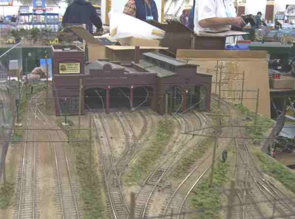

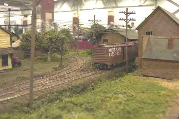

Here is a Photo of some of Andy Rubbo's Catenary with some of my E44A Electrics underneath. My catenary is built to just about the same specifications, with a little different methods of construction. Photos of my progress are all through this thread!
Thanks for your assistance! I would love to see more of your NEC set up!
