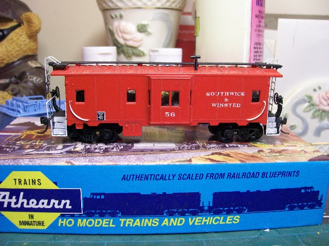

This is the last BB I built. Just last December. It had been sitting on my "To Do" shelf for almost four years though.
Why didn't Athearn add glass for the windows?
