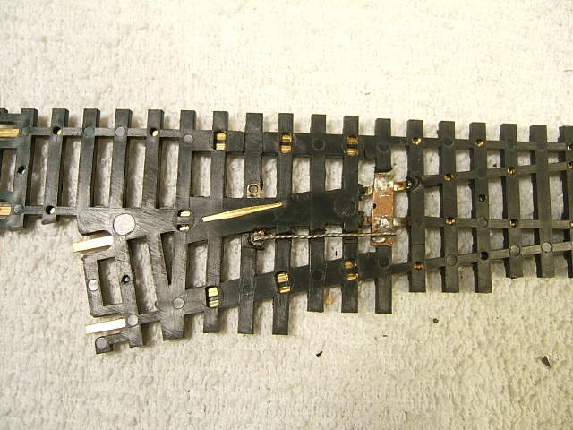

I had the same problem on my previous layout (current one has "live" frogs... Goldth ). The picture shows how I solved this. I joined the two closure rails with a little copper tab, and then routed a small wire from the tab to the rivet at the frog. I cut out the ties to pass the wire so it wouldn't intefere with proper seating of the turnout. The fix was bareIy visible from the top side. Of course, I had to remove the turnouts to do this operation, but it was worth it...!!

Steam, what brand/model of turnout did you do that with? On an Atlas Cusotmline, connecting the two tracks as shown in your photo would result in a short circuit.

It's an Atlas C. Line....At least that's what's molded into the ties....You don't create a short c'cuit because each closure rail takes on the polarity of the stock rail it is up against. Since only one point rail can be touching a stock rail at any one time, the closure rails take on this polarity, which in turn is "fed" to the frog.....

How old are those turnouts? The Atlas custom-Line Code 83 turnouts I have been using do not look like that and are not built that way electrically. Here is a diagram showing how the Custom-Line turnouts I have seen are built: (drawing is from Allan Gartner's DCC web page - <!-- m --><a class="postlink" href="http://www.wiringfordcc.com/">http://www.wiringfordcc.com/</a><!-- m --> )
[Image: sw_typ1.gif]
As shown in the drawing, the stock rail is factory connected to the closure rail - connecting the two closure rails would be a short circuit. I am quite certain of this - looking at the bottom of a customline code 83 turnout, I see two nickel-silver plates which are located directly under the intersection of the point - stock - closure rails on each side.
