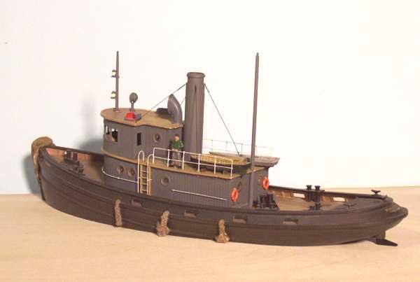

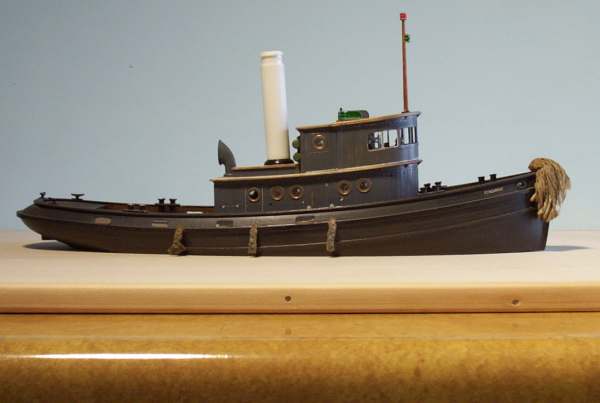

This was the Lindberg "Coast Guard Tug" kit,(82' in HO scale),before modifications.
The fenders were fashioned from strands of a standard Navy swab (mop for you land lubbers).
The side fenders were four strand, "box weave"( like the plastic strand key chain craft project) The bow fender was a "tassle" of several strands, inside out, frayed and arranged, and set with a thin wash of white glue.

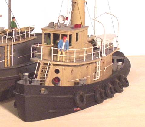

I finally got around to adding "fenders" to my modified Revell Harbor tug. The tires are A-line truck dress-up parts ( Walthers # 116-50105 ) The current status of my modified Lindberg CG tug is also in the picture.

Also, note the bow fender, a hard rubber type that was also commonly used. This could be built up with laminated card stock, wrapped around a form. Once the glue had set, the fender could be sealed, gently sanded smooth, and painted.
This tug saw service in the Harlem River, and wasn't in salt water all that much.

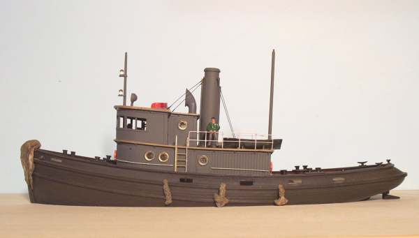

Here is the modified Lindberg "Coast Guard" tug:
It's hard to see in the last picture, but the boat on the port side, is a soft metal casting that I've had for "many" years. I used card stock to make the frames and thwarts (seats)
