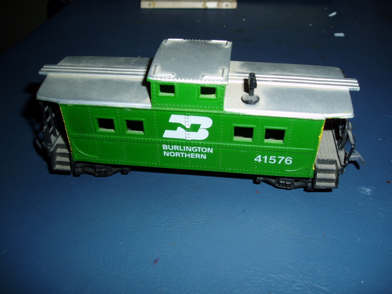

Ralph had a good idea upgrading and showcasing his cabooses. Seeing that my caboose roster was lacking, I decided to fix a few up myself and showcase them here. I also had one of these old Life-Like cabooses. Seems they were made by a variety of manufacturers and are a dime a dozen at train shows. Well, I had one that I bought when I was about 12. It came in one of those life like locomotive and caboose combo sets.
I could really use another standard gauge caboose, but a steel sided caboose is a few years too modern for my era. Then I learned these Northeast cabooses were based on a USRA design that had wood sides and a steel frame. I figured that may be plausible, so I set about converting this caboose to wood siding.

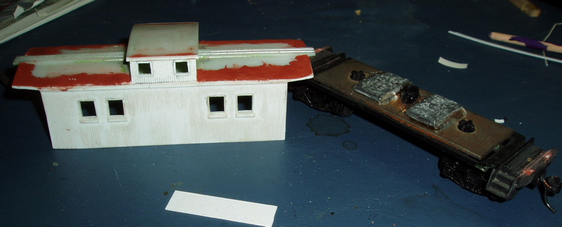

The first step was to disassemble and strip the paint. I then sanded all the rivet detail from the sides and ends of the car. Next, I laminated the sides and ends with thin evergreen styrene siding, and patched up the roof. Here is where I am now.
I have been using Dr. Wayne's lacquer thinner glue method with much success. I simply hold the parts that need to be glued together, and then apply lacquer thinner to the joint with a small brush. It flows into the joint and leaves a very clean, strong joint. This was especially important for applying the thin trim around the windows without marring the evergreen siding.

Thanks for the interest, Galen. To remove the rivets, I first used a chisel blade in an hobby knife to slice off as much detail as I could. Then I simply glued a piece of 220 grit sandpaper to a black of wood and used it as a sanding block to sand the rivets and side details off until the car sides were flat. It really didn't take long. Then I laminated the sides with the thinnest evergreen styrene siding that they sell, and then trimmed out the windows with a hobby knife. It was really fairly easy.

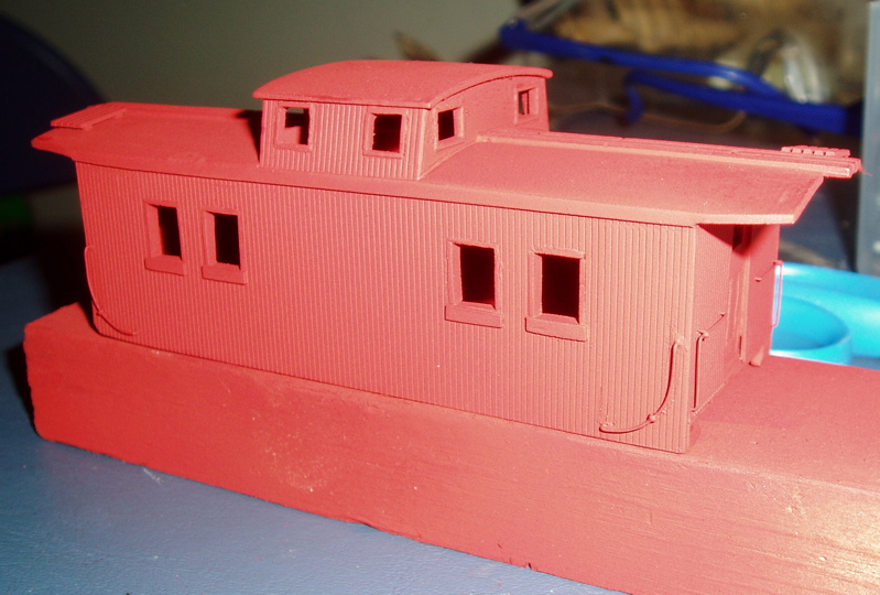

Here is the caboose after a coat of Floquil "Caboose Red". As you can see, i added grab irons and handrails to the sides. Funny thing about paint, it helps you see the little areas that you screwed up Icon_lol . There are a few areas on the roof that will need additional body filler, and some areas on the ends of the cupola that need to be sanded better.

You mentioned some bad spots brought out by the paint. I certainly don't see any!
Gary's right - I don't see any rough spots either. Very nice. Thumbsup Thumbsup
Looks great to me but we are always our own worst critics. Smile

Were I to tackle this project someday, I think I'd reduce the number of windows on a side to two. Not sure which two, either inner or outer, but I think it would perhaps look less like the original without the double pairs.
Even so, just making the change from rivets to wood is very effective in significantly altering the overall look.
