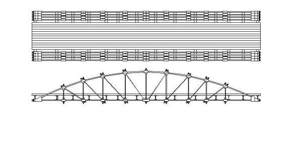

Pete this would be the one for you its 26'6.5" and quite flimsey looking called the Eureka Bridge on the cl site and three drawings to boot.

That one looks like a single lane width, light road bridge.......those cast plates for attaching all the struts would be some project !!

Jim,
I imported the Moneek "Eureka" Bridge drawing into autocad. I'll create the full size drawing, and then scale it to HO (1:87). In the process, I'll hold the width to 6', which is sufficient for a walkway. I'll need five spans to get from the shore line to the bridge tender's shack......I may redesign for a slightly longer span, we'll see what can be done. If it isn't feasible, I'll have to give the Hadley bridge a try.

Pete as long as you are not concerned with a large load being a foot bridge don't see why you could not stretch it out to 40 ft. easely. will awate the first pics Cheers

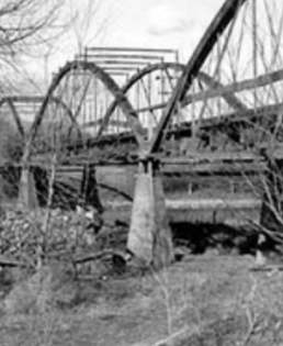

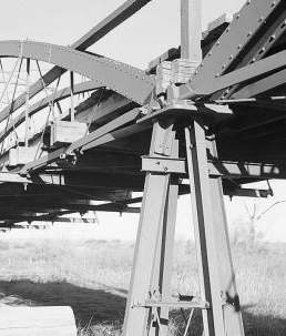

I would have like to have made these larger, and kept some sharp detail but..... In the upper photo you can clearly see the "steel" support legs.
In the lower photo, the "Stone" support.
Looking at the lower photo I see the same four support pieces, and the transverse I beam, just under the ends of the bridge. I also see that the "corners" of the "stone support" are lined up with the short support pieces above the "stone".
I still strongly suspect that what we're seeing in the lower photo is a decorative covering of the steel legs that hold the bridge up. What's seen in the upper photo is, I believe, the original, uncovered, steel legs.

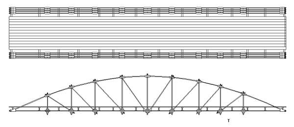

I did this in full size, and then scaled it to 1:87 ( 0.0114942 times full size ) I then scaled the 1:87 drawing up 1.85 times to a 50' bridge in HO. The only problem with up-scaling a CAD drawing, is that every thing gets enlarged, including the plank thickness, etc. I will now have to go in and make several changes to bring things back to scale.
I printed out the initial scale drawing ( above ) and took it down to the modules. I think I am going to like this one. Three spans at 50' each will work beautifully!
Unless the boathouse finishes quickly enough, this bridge build will not be part of the "summer challenge". That will depend on how fast I can shingle.
_____________
I got the details rescaled, so this is what the drawing now looks like. With this printed out, I can start making up assembly jigs.....yeah, this project is going to need them. The most obious changes are the thickness of the wood deck, and the height of the deck support "I" beams. On my computer screen at least, the drawing measures 50 ' with an HO scale rule, so is "full size".
