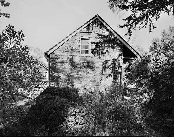

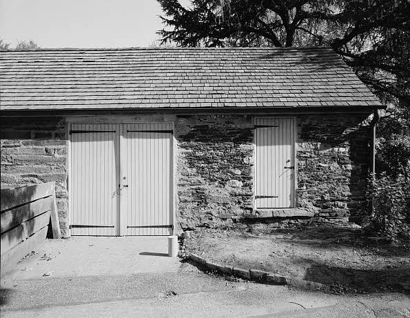

a stone barn would be a large undertaking as even a small two story barn is large but a small shed like barn would be a neat project, the kalmbach book bridges and buildings for model railroads has a small stone building made by building a form and pouring small pebbles in then thin plaster for the stone effect.

Thanks guys!!!... Kevin: that roundhouse makes me want to throw out my Walthers one and replace it! Very cool pic. I have that book you referred to and will check it out
Jim: That 1st pic you sent resembles the "image" in my head more than the others except maybe 2 story or 3 instead of 4.

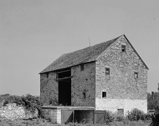

Saltwater Cowboy Wrote:Jim: That 1st pic you sent resembles the "image" in my head more than the others except maybe 2 story or 3 instead of 4.
have another view of that one will post if you want.
jim

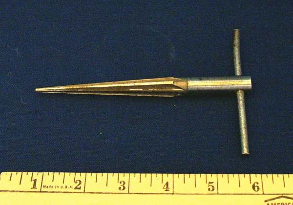

That breakage looks familiar ! One possible "cure"....after the putty sets, carefully drill out the center of the window opening, carefully enlarge the hole with a taper ream ( try to get right out to the inner edge of the proposed opening ) then use files to finish off the corners. If you haven't trashed the broken wall section, use it to try the technique.
Even Styrene sheet can fracture when trying to cut out window openings, I've used this method, and it seems to work very nicely. It can be time consuming, but then, changing the mold for each new wall would also be time consuming.
This will be an excellent project, and I can't wait to see how it turns out.
May your patience hold, and may fortune favor you.
Hi Pete: I get what your saying but pardon my ignorance: What the heck is a taper ream? A type of file perhaps?
This,
Is a taper ream. This one was manufactured by General, and I believe I got this at one of my local hobby shops, but I'm sure Ace Hardware, Sears, Menards, Home Depot, or any other good hardware store will have one of these. For your walls, I'd recommend starting with a 3/32" drill, and then use the ream to enlarge the hole.
Yikes! That thing looks like a medieval torture device!!! Eek
Not to "dis" a super duper modeler like you Pete, but I will try your method: "just to see if I can do it" on the practice piece. I think I'll try a round file instead of going out and buying a tool I may only use once.
I believe it would be faster to just frame out the opening with strip wood and make the pour though and I'll probably go that route when I get there. This will be tedious enough just scribing all the stone work.

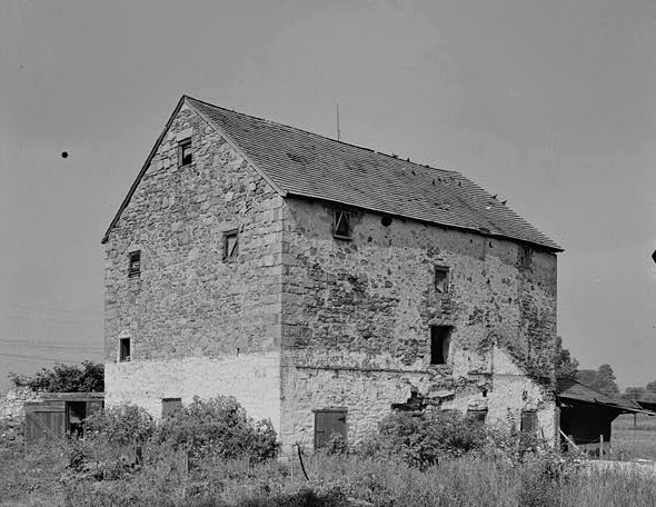

Matt here is the other view of the barn, also i do have 2000 or more structure photos if you need a certian type let me know. Cheers
jim
Thanks alot Jim! It's not the size of the structure that's as important as I'm looking at various types of stone work so my scribing process will be believable.
