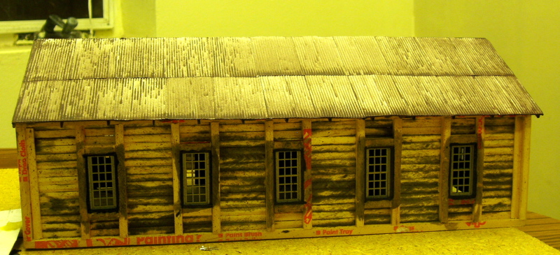

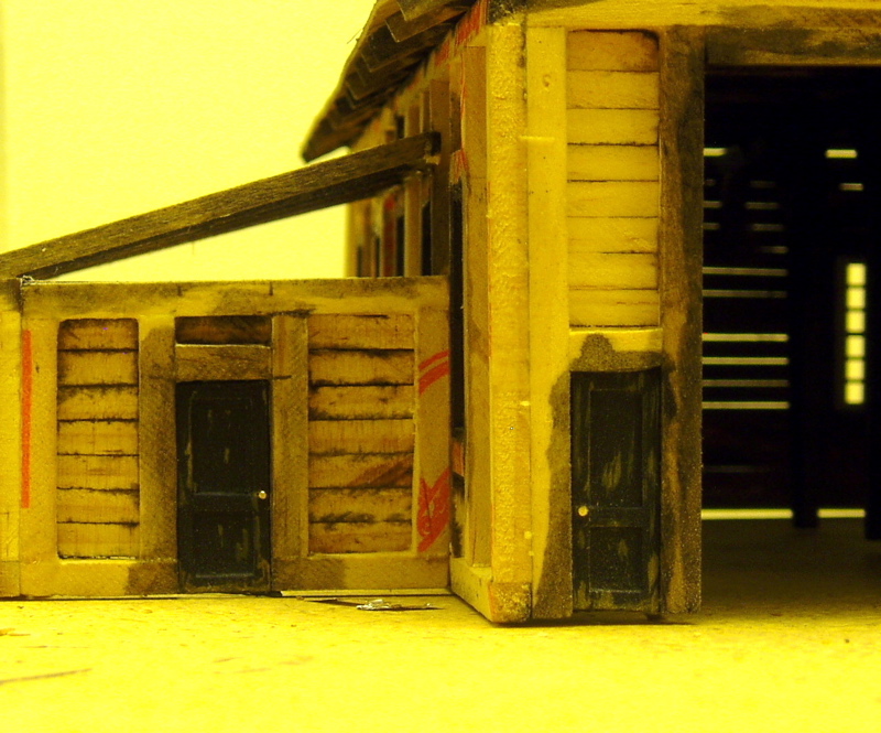

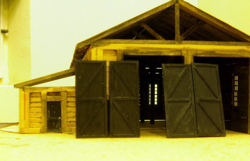

I made some doors from wood I had in my scrap box - leftovers from previous projects. The handles are short pieces of brass rod inserted into holes drilled through the doors.
I also made some engine bay doors. I debated leaving the engine bays open, but I had plenty of scrap wood from which to make doors. I haven't decided whether to make the doors operable or not, but I am leaning towards making hinges similar to steamtrains.
And, I also began making and installing a roof. I used a cardboard underlayment for rigidity, and then made steel roofing by rubbing heavy duty aluminum foil against a piece of scrap ribbon wire. It is a little dinged up because the aluminum foil I used is not quite as thick as I would want, but I think the overall effect is good. I only completed one side and weathered it to see how it would look.
I was originally going to do the exterior walls with the same corrugated metal as the roof, but now I am thinking a board and batten type siding may look better.

Woah, kevin, that is turning out to be a terrific build. The roof is EXCELLENT! Thumbsup
Cheers I vote for a photo-tutorial on how you made the corrugated tin. Cheers
Beautiful work, Kevin, and you will always take pride in that you did it completely from scratch. Oh... I vote for the hinged doors...

I'll see about making a short tutorial on the roofing - But I really don't know if I can do much better than I have already described! I take a piece of aluminum foil, cut it to size, lay it onto a piece of ribbon wire that I have glued to a block of wood, and then rub the foil with my finger. I'd do much better to find a bigger piece of ribbon wire so I can can sandwich the foil between two pieces of wire. Then, the whole thing gets weathered using an ugly alcohol-based wash that began as the india ink staining solution I used on the wood. I added more alcohol, and some model master acrylic "rust" paint, and some matte medium in the hopes of giving the wash more thickness without adding more color. Then I sprayed the whole thing a with Rustoleum matte spray. The matte spray also seems to give the foil a little bit of rigidity and allows the roof to withstand a little bit of handling.

That's a great roof! Thumbsup Thumbsup
I have made corrugated roofing just like that, although I never thought to actually glue the ribbon wire to something to make it easier to handle... 35
If you get a chance to do up a tutorial, I'll gladly add it to The Academy.

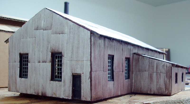

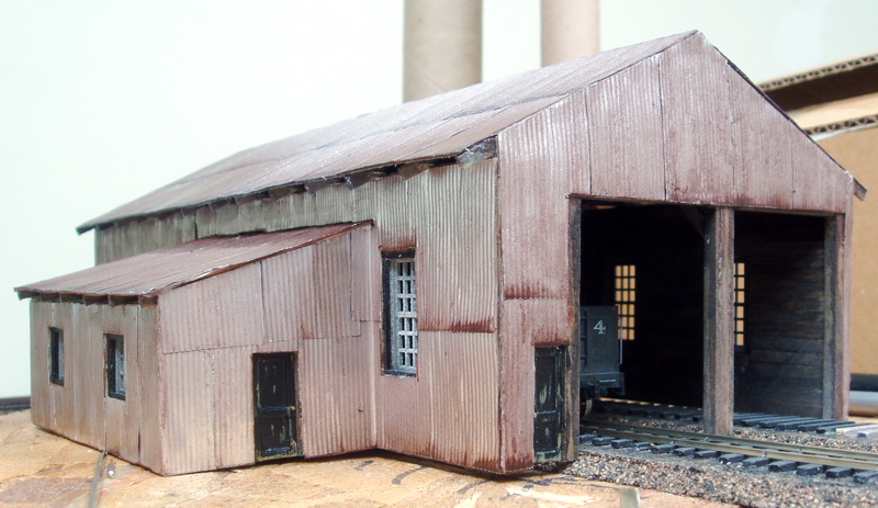

I managed to get most of my lo-fi aluminum foil siding up. The store brand heavy duty aluminum foil is a little too thin for this, and it dings and wrinkles a bit too easily. My official story is that the siding for this enginehouse came from an older smelter that was torn down, and that is why it looks a little "used" Goldth . I still haven't hung the doors, added roof vents, or even some corner trim on the siding. I suppose I will get to that some day.

Kevin, that really turned out nicely. And again, gotta love the innovative and money-saving techniques that you put into this build. The tin siding came out looking great.

That looks really good..!!! Too bad you couldn't finish on time, but close enough for my drudders...
Those doors and siding are AWESOME... Worship
What is that "lo-fi" material you refer to..?? My story will be that the smelter siding came from a dismantled enginehouse...!!! Goldth
