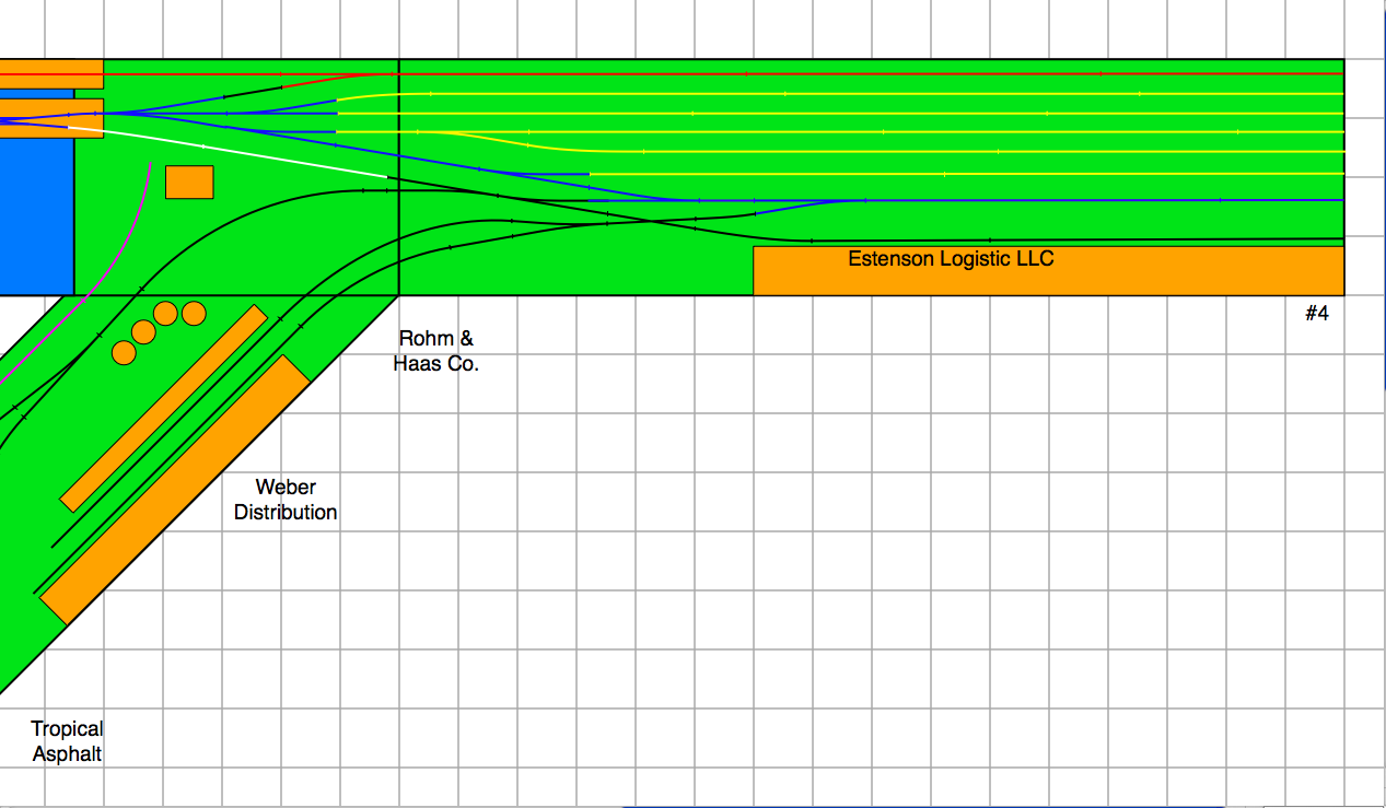

Got some more work done on Module #4 of this project today. i laid the rest of the Central Valley Tie Strips and placed the Walthers #6 Turnouts and Atlas 12.5 degree crossing. The last turnout to go on this module will be a Walthers #5 WYE, but it is not in stock and backordered till August, so I wont have it for a while...
The mainline was laid out down the length of the module. Its Atlas Code 83 Flex with Concrete Ties laid on Woodland Scenics Foam Roadbed. This will be the only elevated track, and it is only slightly elevated.
Im waiting for Micro Engineering Code 70 Rail to come in, so as soon as that comes in ill be able to lay the rest of the track and complete the yard. After that, ground throws will be installed, and then it will be ballasted.
Here are some quick pictures that show the recent track laid with some Cushion Coil Cars and 53' Thrall Gondolas on the track to give you an idea of how many cars this yard will be able to hold.

Attached below is a picture of the section im working on right now

Josh,
This is looking good!!
I really like the complexity of the plan but also the compact size of the overall layout.

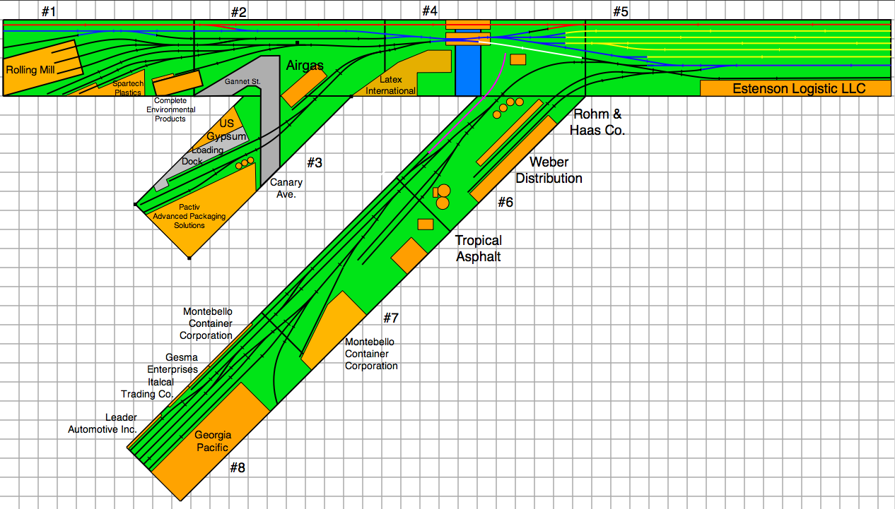

I put the legs on the module today, there folding legs on hinges. This module is 8' long, and well it is pretty hard to handle, and while it was pretty light before, its now pretty heavy with the addition of the legs and leg hardware. Im going to live with it, but I have reduced the size of all the other modules down from 8' to 5'. Here is a new look at the trackplan showing the smaller module sizes. Ive also re-done a bit of the trackwork (some had to be re-worked when the modules were made smaller so turnouts were not on module joints) and ive also added a new structure to the extreme left of the layout. While not prototypical whatsoever, A Rolling Mill was added in next to Spartech Plastics. Reason being, I have a bunch of coil cars and gondolas that I want to be able to run and use, and well they need a place to go LOL.
New module dimensions:
Module #1: 24" W x 60" L
Module #2: 24" W x 60" L
Module #3: 24" W x 72" L
Module #4: 24" W x 63" L
Module #5: 24" W x 96" L
Module #6: 24" W x 60" L
Module #7: 24" W x 60" L
Module #8: 24" W x 60" L

A great plan and layout I would like to build and operate.
I would like to make a remark about the newly added rolling mill. It is not so much the very sparse tracks devoted to such an industry or the lack of storage tracks for empty and full coil cars. It is the psychological break of feeling between light and friendly ala Lance Mindenheim spirit all over the layout and than a harsh break into the almost depressing world of dark and more than serious iron business. That is much more than the color and impression of buildings. It is also ballast, ground cover and everything else. It is the emotional bridge to be spanned between southern California and Gary Indiana. To be frankly I am not convinced that is a change to the better.
However, I feel with you. I have a bunch of coil cars and other IHB cars unused on storage. Some time they will find a home on a very different layout than the current one.
