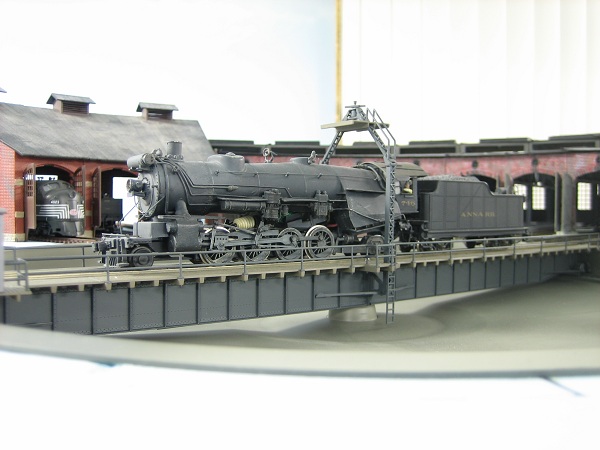

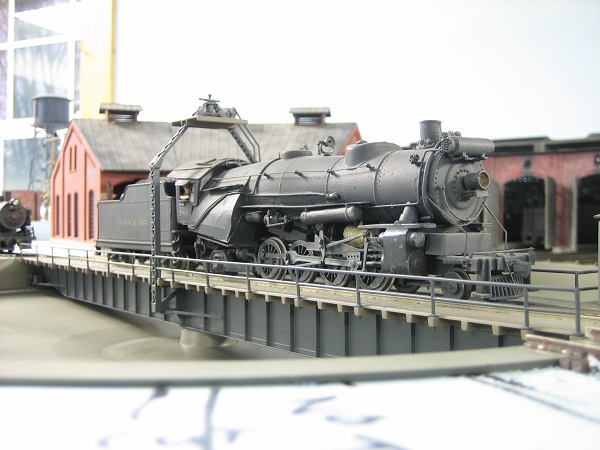

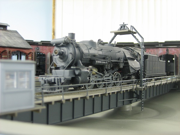

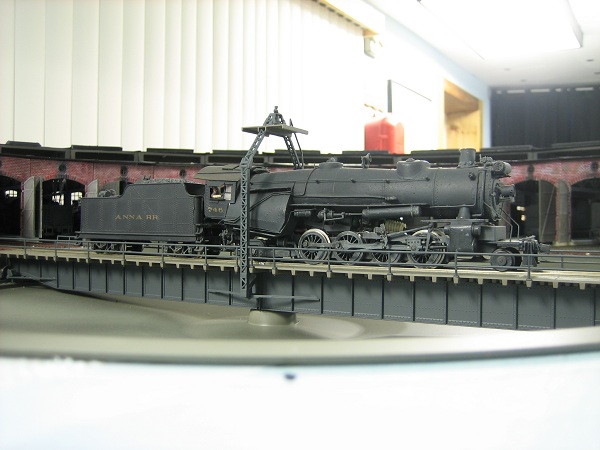

Steamtrains, I have a few pics of one of those that was the starting point for this bash. It is a freelanced Mike classed M-1a of the Anna lines. It has a Wooten firebox and a custom cab on a carry boiler, with a Varney Tender.

e-paw Wrote:Steamtrains, I have a few pics of one of those that was the starting point for this bash. It is a freelanced Mike classed M-1a of the Anna lines. It has a Wooten firebox and a custom cab on a carry boiler, with a Varney Tender.
Very CNJ-ish with the feedwater heater brow.
