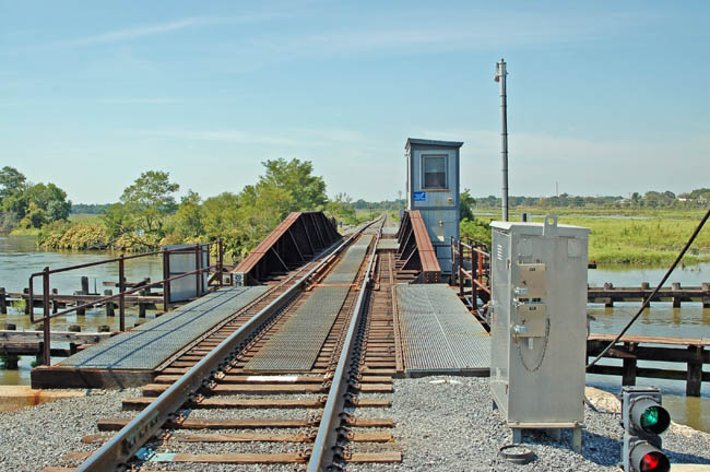

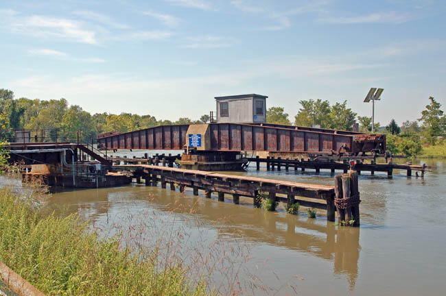

bdw9535 Wrote:Even though the Eagles tried to give the Texans the game they still managed to earn the win. Here's a couple extra shots of the bridge to help you along. Do you have an approxiate date when in will be completed 357
The Eagles defense looked pretty weak. Unfortunately, the Texans' defense looked even weaker!
Now, I'd have to have a bunch more photos than than these. And google earth views, bing bird'e eye, etc. I assume this is for your layout? Does it need to be operational or fixed in the closed position? What are the dimensions of the space where it will go? Any selective compression required? How about we build it together? It does look to be a fun build.
