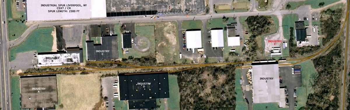

Here's another potential track plan that I've been playing around with, based on an this industrial spur in Liverpool. NY.
I added the brown lines to better show the track arrangement in this image and marked the industry locations. You'll note there are some interesting features that would make it a bit of a challenge to switch and I'm sure that some of you will spot them right off. As indicated on the aerial view, the spur is 2300 feet long or just a hair over 26 feet in HO / 14 feet in N Scale.
Not sure if Industries A, B, C or D currently use rail service, but Industry E (American Steel & Aluminum) may and Industry F (GTS-Welco) unloads tank cars on the lead. Of course in my modeling era (1980) they probably all had frequent rail service.

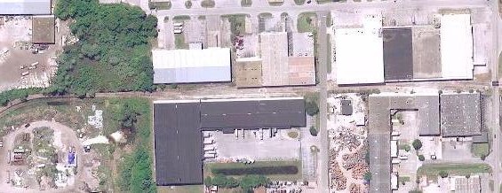

Here's yet another plan I've come up with for my ISL. Look's like this one or something quite similar to it may be it!
The bench work is of course 20ft wide by 18in deep and although my plan is strictly freelance, the track arrangement is based on a part of a Florida Central (FCEN) spur in N.W. Orlando, FL, between Silver Meteor Dr and Shader Rd, crossing Hazelhurst Ave, located here: http://maps.google.com/?ie=UTF8&ll=28.58...3&t=k&z=17 or in other words this much of the spur:
Since my ISL will be freelance, I've taken the liberty to have industries that appeal to me and support my freight car fleet. The industries are from left to right:
Beverage Canning Plant - (2 or 3 car spots) for my fleet of corn syrup tank cars.
Storage Warehouse - (at least 6 car spots) for my box car fleet. This structure may be constructed with an open back and a detailed interior as has been discussed in this thread: http://www.the-gauge.net/forum/viewtopic...=24&t=3763
Food Processing Plant - (2 or 3 car spots) This one will be a Trinidad Benham facility http://www.the-gauge.net/forum/viewtopic...=24&t=3731 for my covered hoppers. Alternately, it might be a facility like the Higgins Premium Pet Food feed mill in Hialeah, FL http://maps.google.com/maps?f=q&source=s...2&t=h&z=18 that I found a few weeks ago while playing with Google/Bing maps and since I do have suitable small grain bins in my stash.
Food Processing Plant - (4 or 5 car spots) This second food processing plant will be like the Trujillo & Sons facility in Miami, FL http://maps.google.com/maps?f=q&source=s...6&t=h&z=19 - this industry was selected just today, after the wife surprised me with a fleet of 25,500 gal tank cars (vegetable oil) for Christmas and is also a great destination for more box cars and my reffers.
Lumber Dealer - (2 car spots) Destination for still more box cars and my bulkhead flats.
Finally, the scenery only/staging area will be like what you see in the photo - trees, bushes and assorted junk. Although I may throw in a highway overpass at the left edge of the layout.
I'm currently laying out the track arrangement to see if it fits as well as the plan shows and I know it will provide plenty of switching and there will be plenty of structures to scratch build too! Maybe I'll get started now. I'm actually more eager to start scratch building structures then I am about getting the track laid and wired!

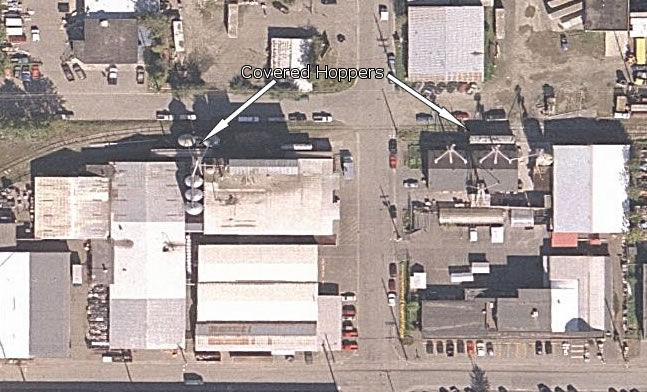

Spent a few minutes looking at this industrial spur. Sure is spread out, and not your typical industrial spur with all "shoe box" buildings.
Found a few interesting things while looking at it with Google and Bing:
At the corner of N Orca St and Spar Ave is Alaska Garden & Pet Supply and I found that there is spur running into it from a curved turnout that runs between the building and the two storage bins. Across the street is Alaska Mill & Feed Fertilizer that also has a rail spur. In this aerial view you can see a covered hopper spotted at both these industries:

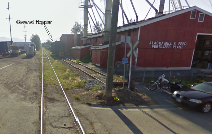

Here's a view of Alaska Mill with a covered hopper on spot and looks like they are using a tow motor to move the car:
And no, the rails are not split as it appears in the photo. Seems to be an effect that you sometimes get because of the way Google street view images are stitched together. Noticed that effect several times as I followed the track along from the street.

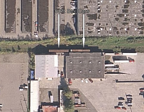

Here's an aerial view of PSC Environmental Services that has 2 60ft box cars spotted:

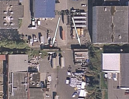

Then there is this unidentified industry that has tank cars on spot:

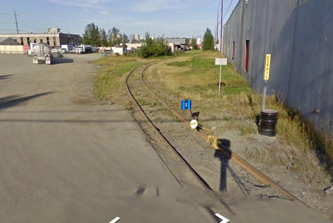

Finally, here is the spot on N Stika St where Weaver Bros Transport unloads their cars - complete with a portable derail and blue flag:
The building on the right was Odom Corp and Frontier Paper and used to be rail served, but track has been removed.
