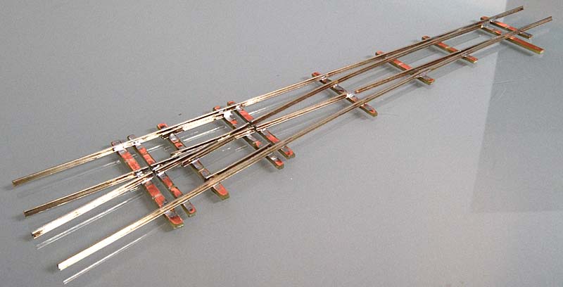

Tetters, you kow it is your fault …
… that I will build my own turnouts from now on. Wink Your fine trackwork inspired me so much that I had to try it someday. Now that I am planning some major changes on my layout, I need some left hand turnouts, but as so often, the Micro Engineering TO’s I need are not available. I don’t want to wait for ages, so I took a Fast Tracks track template, printed it out and started to build my first turnout … and I must say that I am really delighted how it turned out Goldth . Because I had to use what I had at hand, the PC ties were cut from a piece of PC board and the rails were taken from old and used ME code 70 flex track. Cutting the ties was quite boring, so today I ordered PC ties and wooden ties from Fast Tracks for my next attempts. Won’t do a double crossover any time soon Wink , but the next one I am going to build will be a beautiful, long #10 Y.
[Image: ply32.jpg]
Kurt

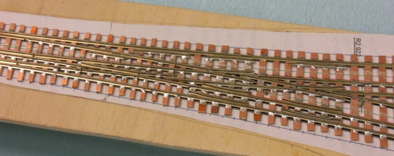

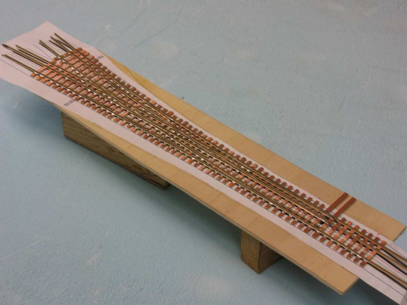

I like building turnouts too. Some time ago a friend wanted wanted a code 70 Y-style turnout for his module. Main track radius 2922 mm, diverging track also 2922 mm. And he wanted a better throw bar, not the usual PC board tie. I've made an AutoCAD drawing, prepared the ties, and 4 1/2 hours later...
[Image: 10-02-24_IMG_9246.jpg]
[Image: 10-02-24_IMG_9244.jpg]
Wolfgang
