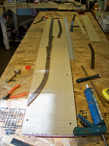

Sorry that I haven't been active as much as I would like but work keeps getting in the way. (Good thing). All I managed to do is lay some roadbed and solder some track feeders.

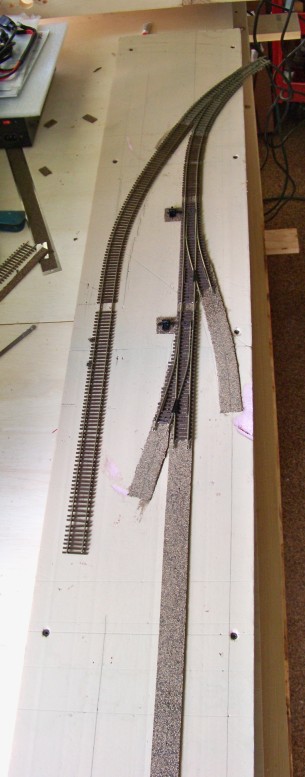

#22
Hi all:

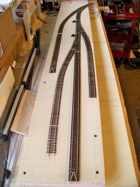

Time for a quick update. Progress has been slow due to work. In the picture below you can see that the turnouts and one siding have been glued down
along with the ground throws.

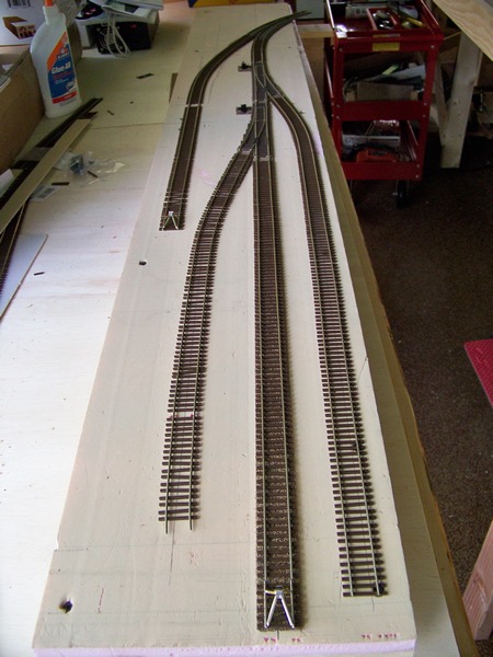

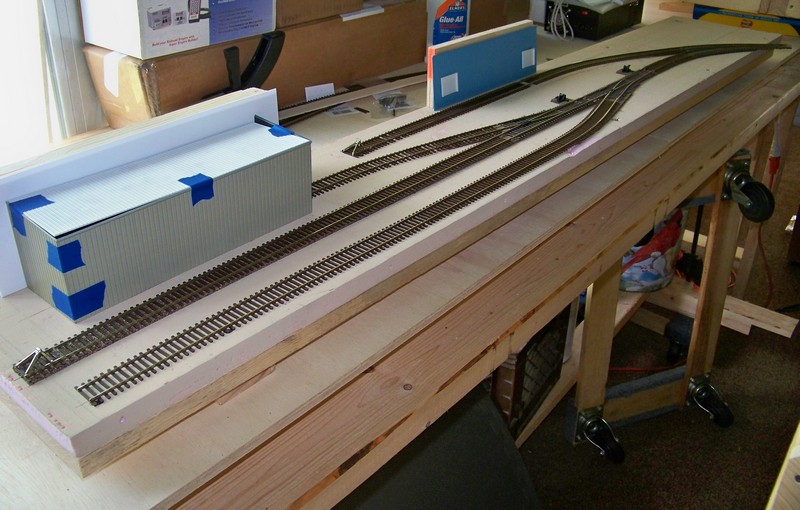

#23
Hi:

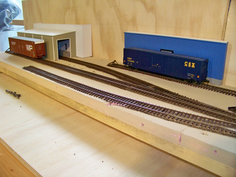

Finally had a chance yesterday to finish laying the track. Now it's time to work on scenery and buildings.
Not sure yet on the length of the far right track (might cut it back a bit). Haven't decided on an industry for it yet. Was thinking of some kind of tank car unloading facility but there is
not much room.
Howard
#24
Howard,
Looks like you are making some good progress!!
As for some suggestions on industries:
I work for a large shortline and we have a number of tank ar customers, the majority are fertilizer which is unloaded using gravity and hoses. This is mostly seasonal but I have seem them recieve cars in the off season to refill their storage tanks. This could easily be modeled with a tank in relief and some hoses along the ground.
We have a customer that has a one car spot that they share with another industry. The recieve loads of lube oil and use a truck to draw the oil out of the tank. The car will sit for usually a week as they take their time unloading the car. Other then a trach can and a spill pad there is not much to model.
Another option is recieve tallow which is used in animal feed. We have a few customers that takes this and mixes it with dry feed to create "super foods" for livestock. I have also seen dog and cat food plants recieve these types of materials in making their food. Again some hoses and some vertical tanks nearby.
We have another customer that recieve solvents made in using paint. One car will last them between 3 and 6 months as they are a small speciality company. There are some vertical storage tanks and some hoses for unloading the car. Where the car is spotted there is a concrete catch basin and there is a spill kit station near by.
If you need any details on any of these places please let me know, and I hope they have given you some help!!

The recent articles in Model Railroader about a Corn Syrup Transload Facility is a great idea for a compact industry and you could alter how many different grades of product the facility receives to adjust the size of the plant to suit your space.
Also the Effingham Railroad has a transload/team track area where tankcars of Biodiesel are unloaded directly into tanker trailers for delivery to the customer who is a rural fuel merchant in a town just South of Effingham. All that is needed is a spotting location and a gravel team track area.

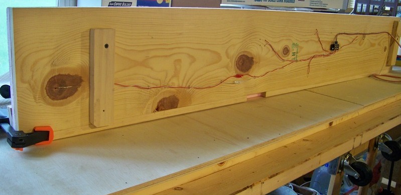

Hi all:

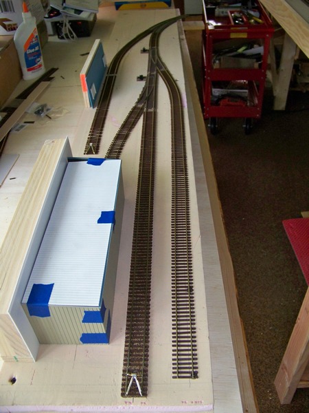

Greg & Mark: Thanks for the ideas. Some kind of transload facility is what i originaly thought of. Along that line, I cut the right hand track back a bit.
Also took some time to do the wiring so now thats done.

#27
Howard, I like that the ties on the sidings are "less than perfectly" spaced. What track are you using?
#28
Gary:
The track is Micro Engineering Code 83. I used a single edge razor blade to remove the small piece of plastic between the ties on the back side (very time consuming)
and then ran my finger down the middle of the track from the top side. The results are ties unequilly spaced and some at an angle.

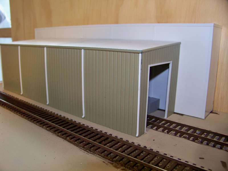

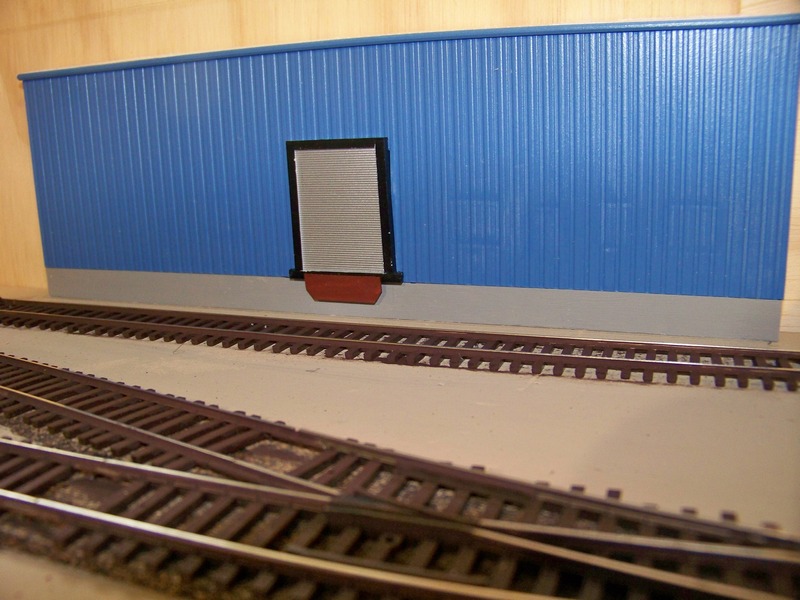

#29
Hi all:

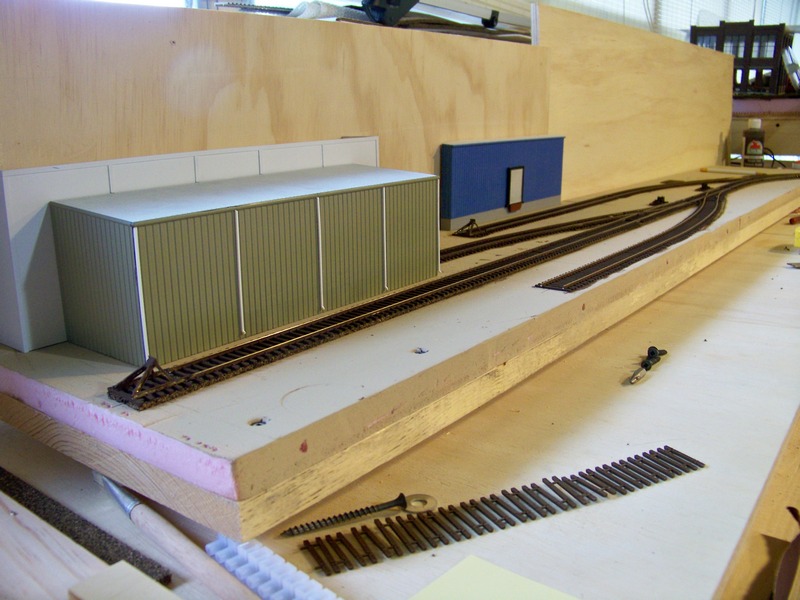

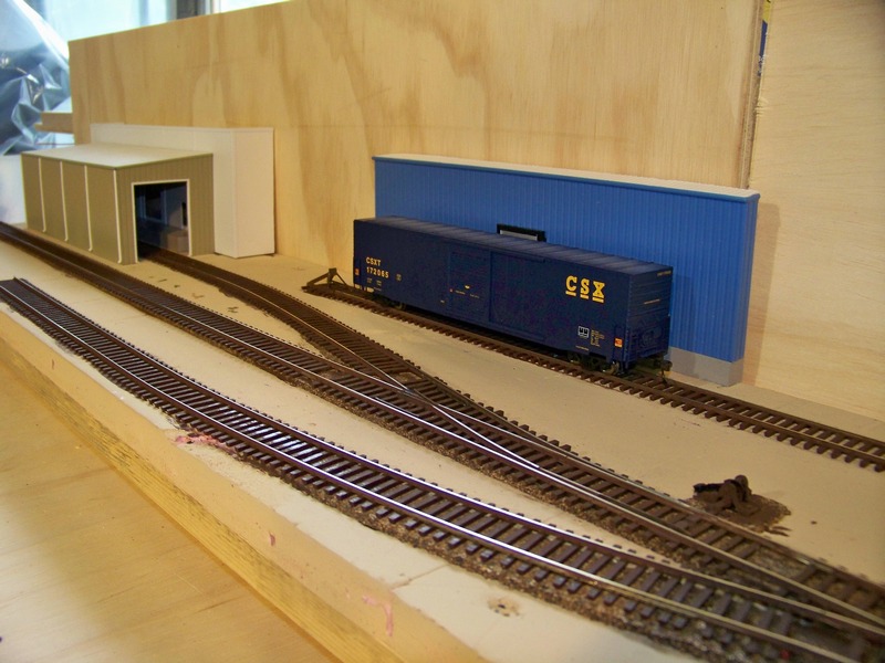

Can not believe it's been about 6 weeks since my last post. I worked on the layout a little bit these few weeks.
Painted the track and worked on two of the buildings. Will start ballasting and scenery next. Hopefully that will not be another 6 weeks.
Thanks for following along,
