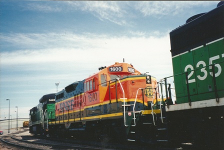

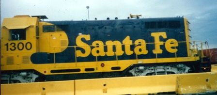

As luck would have it, found only one "grab" shot of BNSF 1300 at Hobart Yard. 1300 started out as GP7 ATSF 2703 1/52 then became GP7u 2009 6/81. Also found one 0f BNSF 1600 at Barstow Yard. The 1600 used to be NP 202 then BN 1702.
