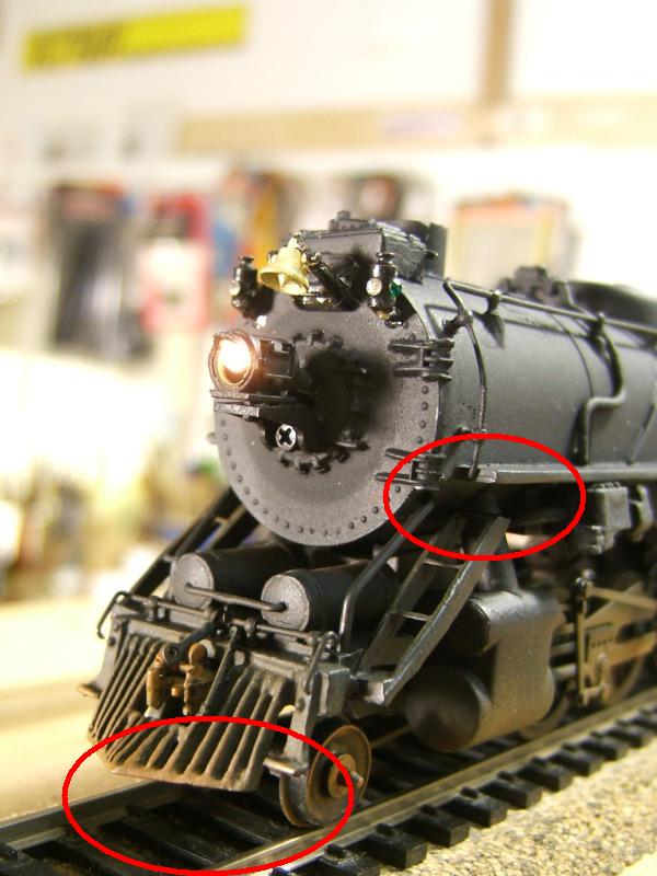

A couple of downers...the cowcatcher is too high off the rails...And that screw holding the headlight to the front cover.... :x Gotta do something about that....

" A couple of downers...the cowcatcher is too high off the rails...And that screw holding the headlight to the front cover.... :x Gotta do something about that.... "
If you need to be able to remove that screw, cut a circle of masking tape the size of the screw head, apply it to the screw and paint black. If you don't need to remove the screw, fill the slots with putty, and paint black. I wouldn't have noticed it unless you pointed it out.
" the cowcatcher is too high off the rails "
As long as the coupler works......, again, it's not that noticeable.

I have a comment about the front end, as you've already described. I am wondering if there's something preventing the shell from sitting back down properly? See the red circles in your photo below to see what I mean. While the feeds to the cylinders seem correct, there might be something preventing the shell from sitting where it is supposed to be, as evidenced by the high "cowcatcher" and the disconnect between the ladders and running boards.
I think the number board solution to the phillips screw head is a great idea. Wink

Andrew might be on to something regarding something being installed incorrectly on the front end. I can't recall if you used the stock mantua pilot or not. As for the screw, sometimes I have used a hex head screw on side rods because it is less noticeable than a phillips or slotted screw. I have to file the screw head to about half thickness, though.

As for the cowcatcher/steps issue, i double checked to see if the boiler might not be sitting correctly on the frame, but it is firmly seated on the saddle and on the cylinder pipes. It is not the original catcher...The original was a blob of black plastic.... Nope It's one of the many add-ons I purchased , and "dolled" it up with the piping between the tanks and the coupler levers. The front coupler is scale (+/-), from a time before Kadees, so it's essentially just for show....

The catcher, deck, cylinders and steps are all one casting. The coupler and coupler levers are the only modifications to it, and do not interfer with proper "seating" of the boiler. It was advertised as being specifically for the Mantua Mike.... Nope

It looks like the pipes between the cylinders and the boiler are holding the front of the engine up. I'm thinking that it would probably work to file off the tops of those pipes to allow the boiler to sit down as it should. The other alternative might be to drill holes in the boiler to just allow those pipes to slide up into the boiler and allow it to sit down properly.
Russ....The cylinder tubes are not the sole support of the boiler. The "real" seat for it is a saddle-like post right underneath the smoke stack which is what the boiler screws into. I checked last night and the boiler is seating on this saddle, and the holding screw is well tightened.
I've been thinking of checking the cowcatcher with the original that came with the kit, but that implies disassembling the loco....And that's not gonna happen...Not right now anyway... Goldth
Also...the catcher screws directly on the frame making it independent of the boiler. The gap between the steps and the running boards would get larger if I were to lower (if I could...) the catcher....

I suspect that the post under the smoke stack needs to be shortened slightly and drilled and retapped if necessary. I suspect that kits built in the "good old days" were not always as precise as what we are used to today!
