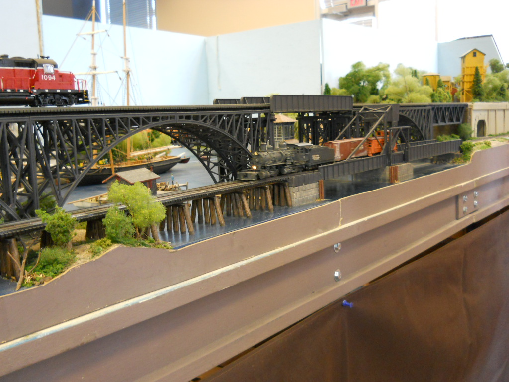

I settled on modules, for two basic reasons.
Each module is a small space, that can be detailed extensively, and is limited to just what track-work will exist in that space.
In my modular choice there are only two tracks required, to be able to connect with other modules in the group. Once the 2' X 4' module, with the two mainline tracks, end to end, is built, any other additions/modifications to it, are a personal choice. ( [i]I chose to go 30" X 4', to increase water area[/i] )
The lower level, dual gauge loop ( Standard , and 3' ) was my choice, as it added some extra bridges. The "Waterfront"/ harbor concept gave me space for displaying my "other hobby" model ship building.
The upper level "required" track, and the lower level "optional track" can be seen here, with SHS & D 3' gauge 2-4-4-2, with a box car and Caboose crossing the rolling lift bridge, over the Kennequogue River.
Yes, the bridges are all kits, most all of them "modified slightly", and there is 7-1/2 scale Acres of water....and.... yes I grew up very close to water, and boats, and then spent 20 years U.S.Navy. My two tours of duty in Maine, was the inspiration for the "waterfront scenes".

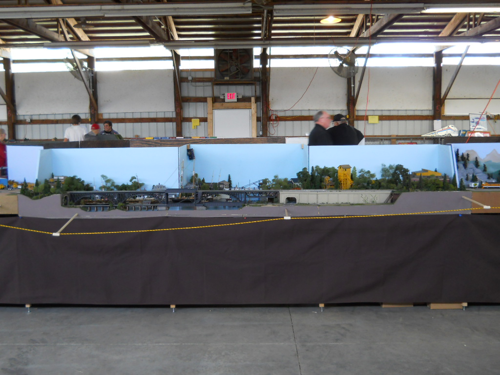

Modules at show:
